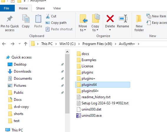

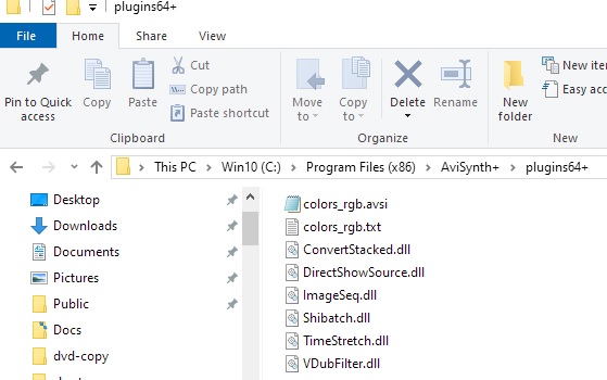

    In my system, the Plugins+ and Plugins64+ folders only contain the items that were installed with the Avisynth package.
    (I have left it like this, see image below)
    The Plugins and Plugins64 folders contain plugins that I have downloaded and placed there. Easier to keep it straight this way.

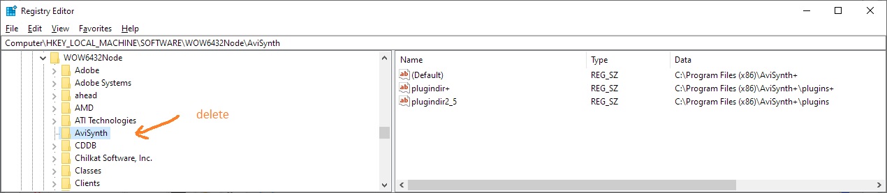

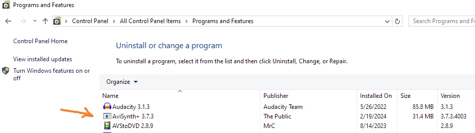

    It might be worth copying out any plugins you added to those folders to a safe place,
    uninstalling Avisynth, delete the registry entries, delete the official folder once you've checked and copied
    anything you need:
    C:\Program Files (x86)\AviSynth+
    Make sure there are no old versions of Avisynth.dll in c:\windows\system32\
    Then install the latest Avisynth Plus
    https://www.videohelp.com/download/AviSynthPlus_3.7.3_20230715_vcredist.exe
    Add any downloaded plugins fresh from the downloaded zip files incase yours are mixed up. Add them to the folder I recommend above

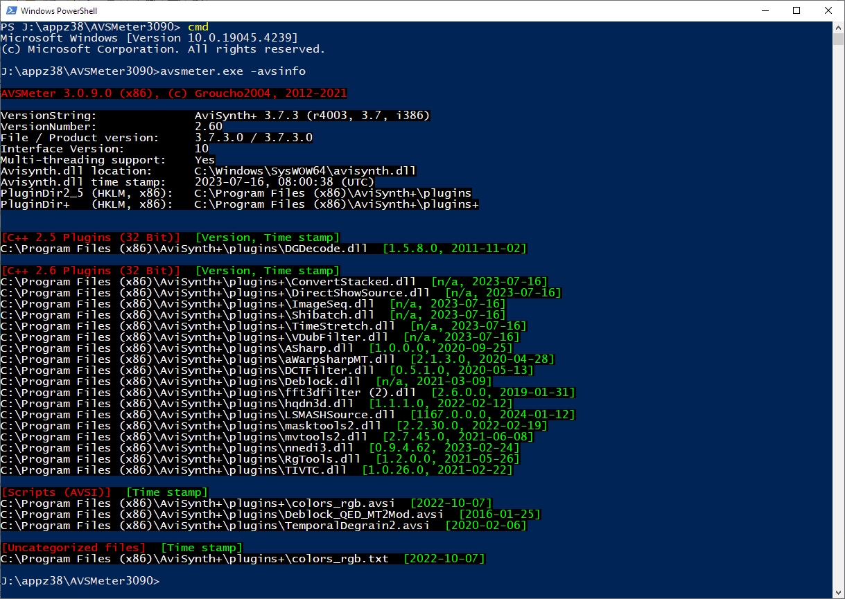

    There are many ways to tell if a dll or exe is 32 or 64 bit:
    https://www.winhelponline.com/blog/find-out-if-a-program-exe-file-is-32-bit-or-64-bit/

    A long time ago I wrote a quick and dirty tool to check a binary for bitness. Since I retired from IT I've lost a lot of my code but lo and behold, I've posted this tool here on videohelp:
    https://forum.videohelp.com/threads/388030-LoadVirtualDubPlugin-never-works-%280xc1%29#post2512031

    Mar 2008
    Congrats for fixing it, AVisynth can be problematic enough by itself without having this extra switching functionality.
    Did you determine what caused the bad directory to appear at HKLM\SOFTWARE\WOW6432Node\Avisynth ??
    Problem with the later version of Setavs or the Universal Avisynth installer?
    There is a tool that may be helpful in the future, you can use it to check the integrity of the 32 and 64 bit plugins Avisynth
    knows about. It will tell you if it detects any problems (conflicts, bad version, missing dependencies,etc.)
    Run it from a command prompt or Powershell.
    https://www.videohelp.com/download/AVSMeter3090.7z
