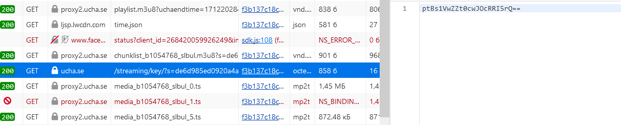

    Use the Firefox browser - it immediately shows base64 value
    https://ucha.se/streaming/key/?ut=wqeoBtn2Hu2dCAgn68H7
    [Attachment 78121 - Click to enlarge]
    ptBs1VwZZt0cwJOcRRI5rQ==
    then convert base64 to hex
    https://base64.guru/converter/decode/hex]

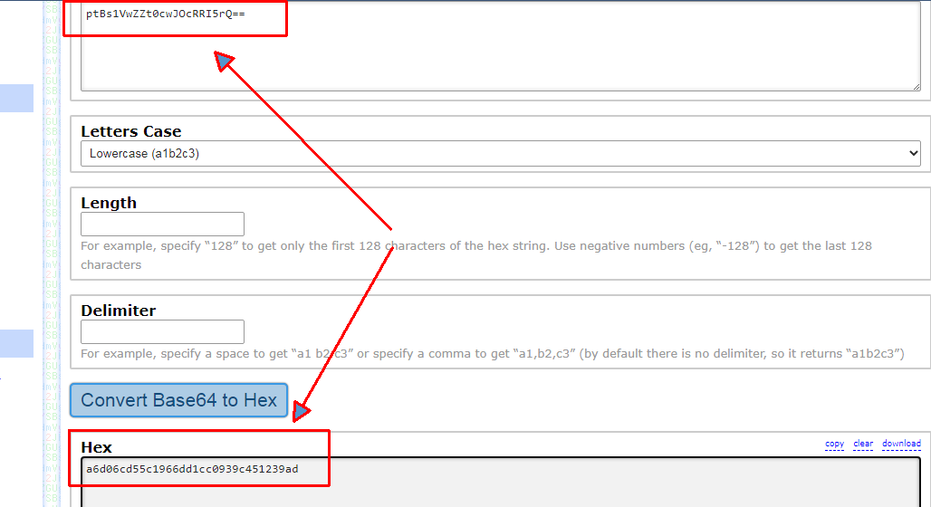

  11. go to https://base64.guru/converter/decode/hex
    put base64 ptBs1VwZZt0cwJOcRRI5rQ==
    in hex you get a6d06cd55c1966dd1cc0939c451239ad

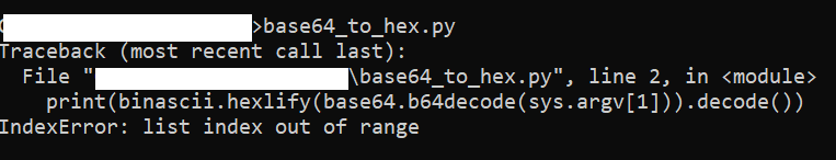

  12. Or in Python:
    import binascii, sys, base64
    print(binascii.hexlify(base64.b64decode(sys.argv[1])).decode())

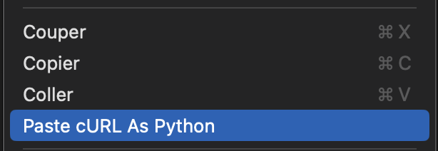

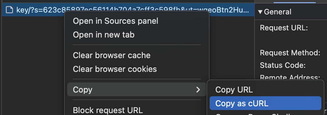

    Yes so I copy the curl request from the web inspector as cURL
    [Attachment 78123 - Click to enlarge]
    The I paste in vscode so I get the headers and everything (using vscode extension from https://curlconverter.com/): Image
    [Attachment 78124 - Click to enlarge]
    import requests
    headers = {......}
    response = requests.get('https://ucha.se/streaming/key/?s=....&ut=wqeoBtn2Hu2dCAgn68H7', headers=headers)
    print(response.content.hex())
    And it return the key !

  20. Originally Posted by Obo View Post
    Or in Python:
    Unfortunately, it was not possible to use your script.
    [Attachment 78146 - Click to enlarge]
