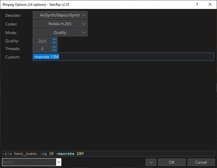

  5. Ok I will try your precious suggestions. Now I'm trying on Staxrip Ffmpeg with the NVENCC H265 and with the first results I am very satisfied.
    [Attachment 78110 - Click to enlarge]
    First I used the AQ 0 to consider a little grain . Fast help?
