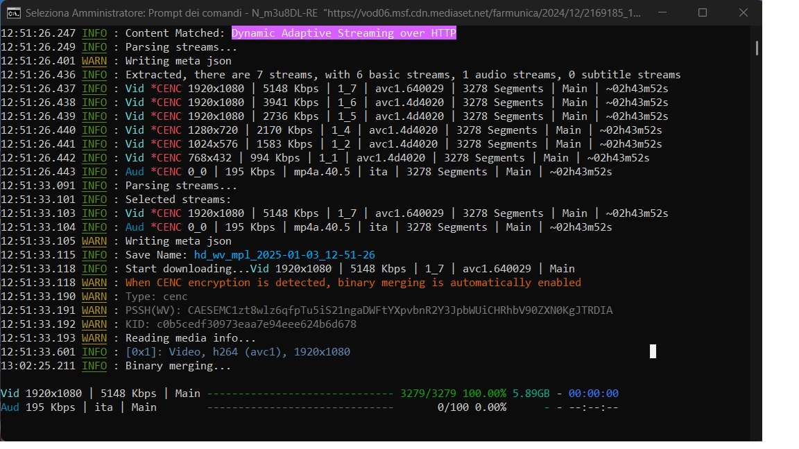

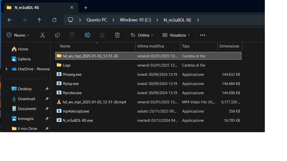

    Thank you very much, you were very kind. However, I would still need some support.
    I just downloaded the file with N_m3u8DL-RE, as you can see from the attached photo. He created the mp4 file for me in the same folder, as can be seen from the attached photo, but the file cannot be seen or heard. Do I have to do anything else? Thanks so much in advance.

  2. There can be more than one problem, most likely it's the wrong key, point to the url of the video link, in fact from the image you attached it looks like you didn't use the command to use the key that cdrm-project gave you.
    Indicate the command you used

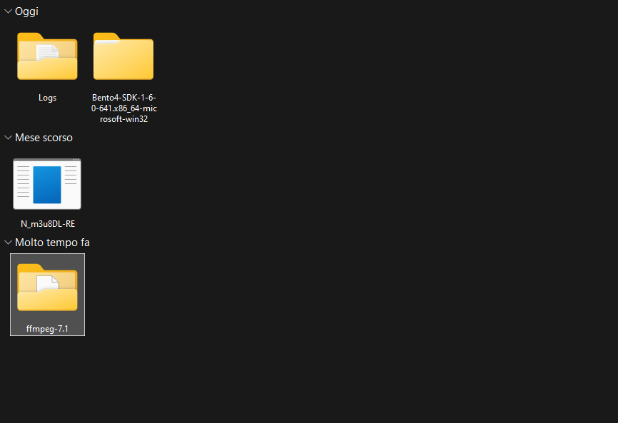

  16. downloading the three programs and placing them in a single folder gives me this
    [Attachment 84716 - Click to enlarge]

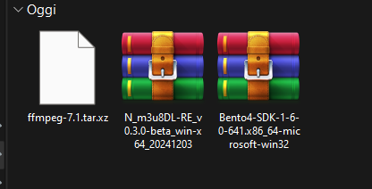

  17. all your programs are in archive format...you have to extract them....For example with Winzip...

  22. OK so first extract archive in your folder...

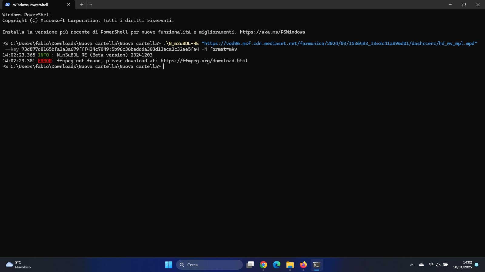

    Afterwards, you run the command

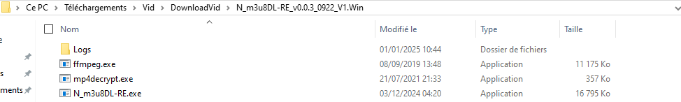

  23. where is ffmpeg....
    Show me your folder
