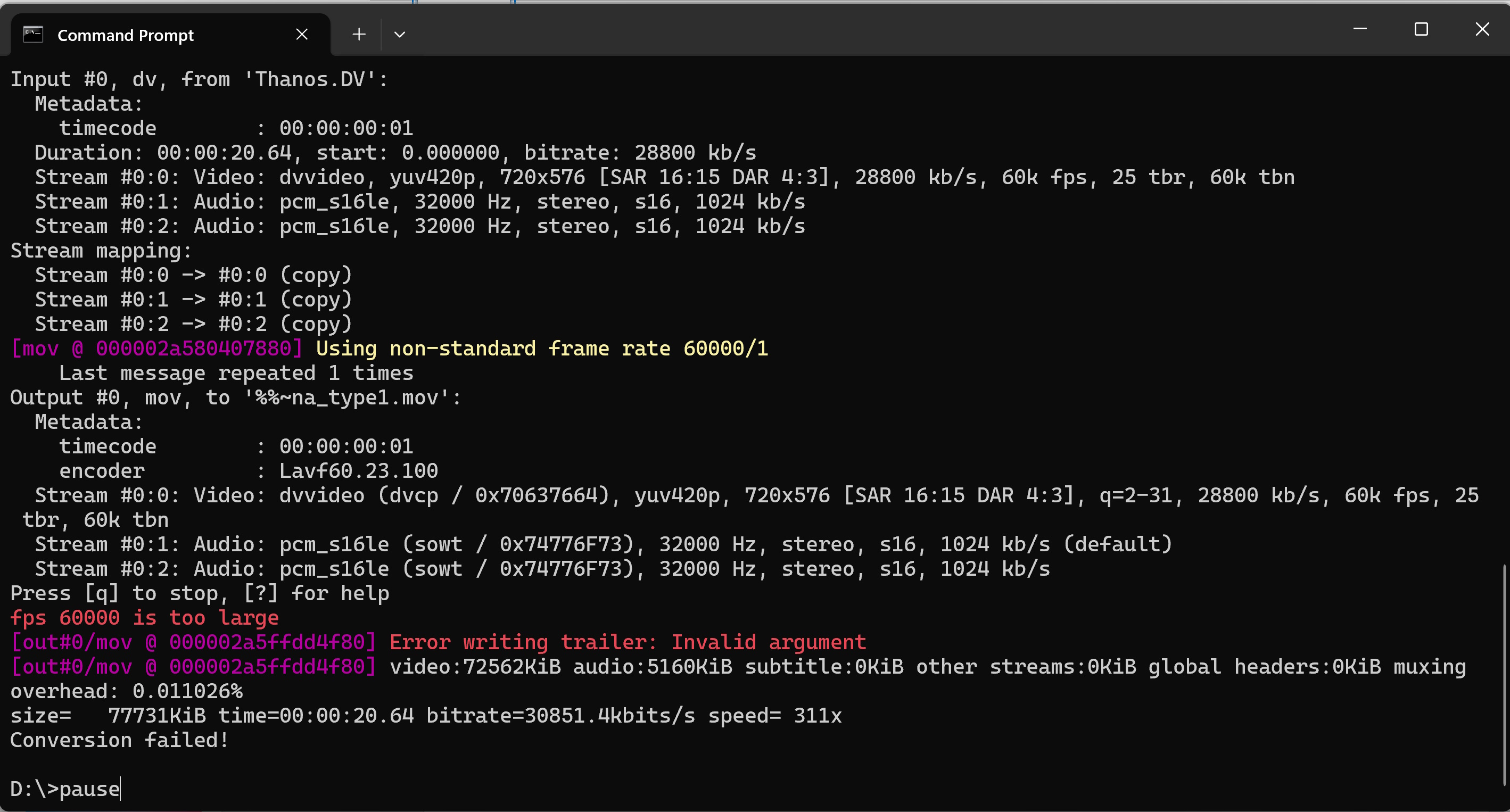

    I used ffmpeg once or twice. Have to look up again how to do it. I went to start (Windows 11) and typed cmd and hit enter. Command prompt opened. I then typed d: and got to my drive D. That is where I placed the three ffmpeg files and the video called Thanos,DV. I wasnt sure what part of what you wrote is the command so I tried
    ffmpeg -i "Thanos.DV" -map 0 -c copy "%%~na_type1.mov"
    I got an error message. See attached file (please).
    pause

  27. Originally Posted by plehoediv View Post
    For non batch (converting 1 at a time), you'd enter the output file name
    ffmpeg -i "Thanos.DV" -map 0 -c copy "Thanos.mov"

  28. Originally Posted by poisondeathray View Post
    for %%a in ("*.dv") do ffmpeg -i "%%a" -map 0 -c copy "%%~na_type1.mov"
    pause
    The part in Bolt is what confused me...
    That's for a batch file , wildcards so all the files in a folder with extension .dv are converted instead of manually doing it 1 by 1 .
    If you use a command line for batching directly instead of batch file (.bat) , use 1 "%" instead of 2 "%%"
    for %a in ("*.dv") do ffmpeg -i "%a" -map 0 -c copy "%~na_type1.mov"
