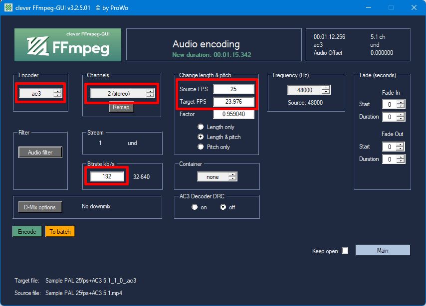

    Download clever FFmpeg-GUI, start it, follow the instructions, then load your PAL video, click main, click encode audiostream, click encoder.
    Set all like in the picture below and click encode.
    The new generated ac3 audio should match the encoded 23.976 fps lagarith video.
    [Attachment 77923 - Click to enlarge]
