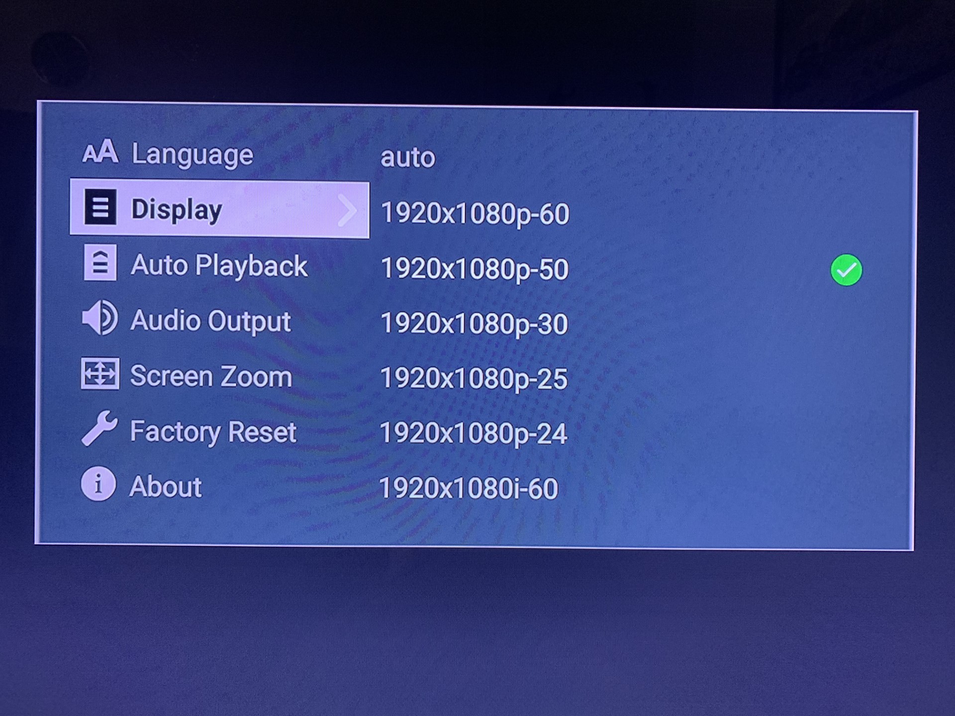

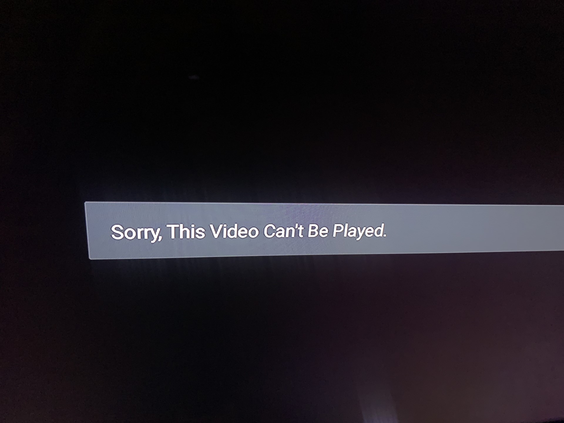

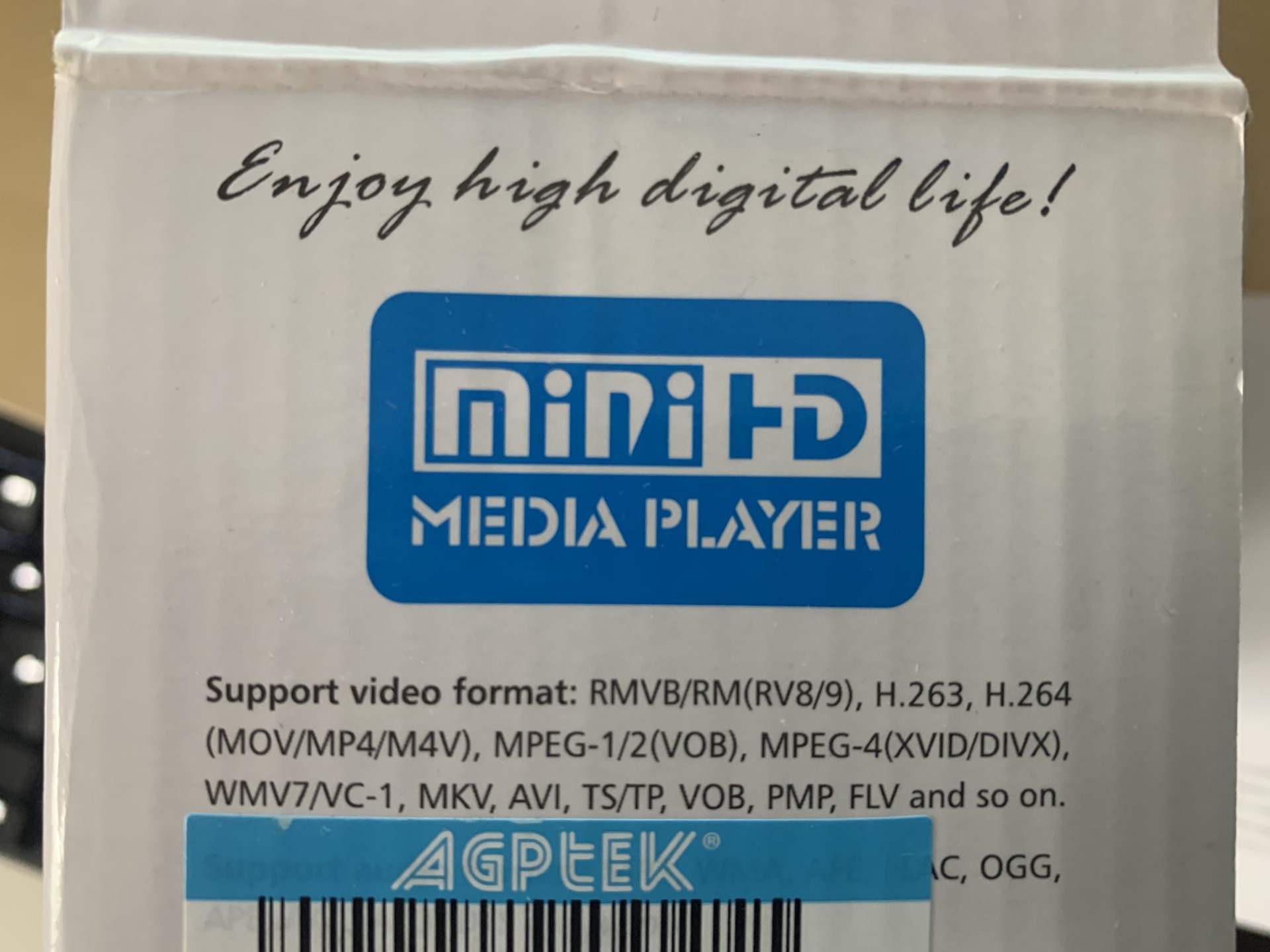

    I want to play my SD card videos on tv without using my camcorder to connect to the TV. So I recently bought the AGPTEK Mini HD Media Player for connecting with the TV. Here you can put in the SD card and play the videos on TV. But when I put the SD card in the device and try to play it, the message "Sorry this video can't be played" appears on my TV.
    I'm totally not an expert with formats etc but I did some research. My videos are AVCHD or MTS. I understand that MTS is AVCHD format. I understand that MTS format files will automatically change into MTS2 formats when transferred to a computer. According to the specifications of the device it has to support MTS2 (see pictures).
    Does this mean I will not be able to play my SD card video's directly with the device? Do I have to transfer it to the computer first so it becomes an MTS2 file and then transfer it back to the SD card? Or do I have to convert it to MP4 or something else?

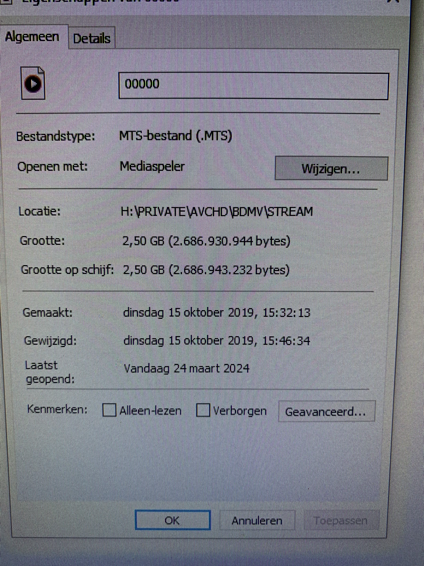

    File format shown on PC
    [Attachment 77895 - Click to enlarge]
    File format by device shown on TV

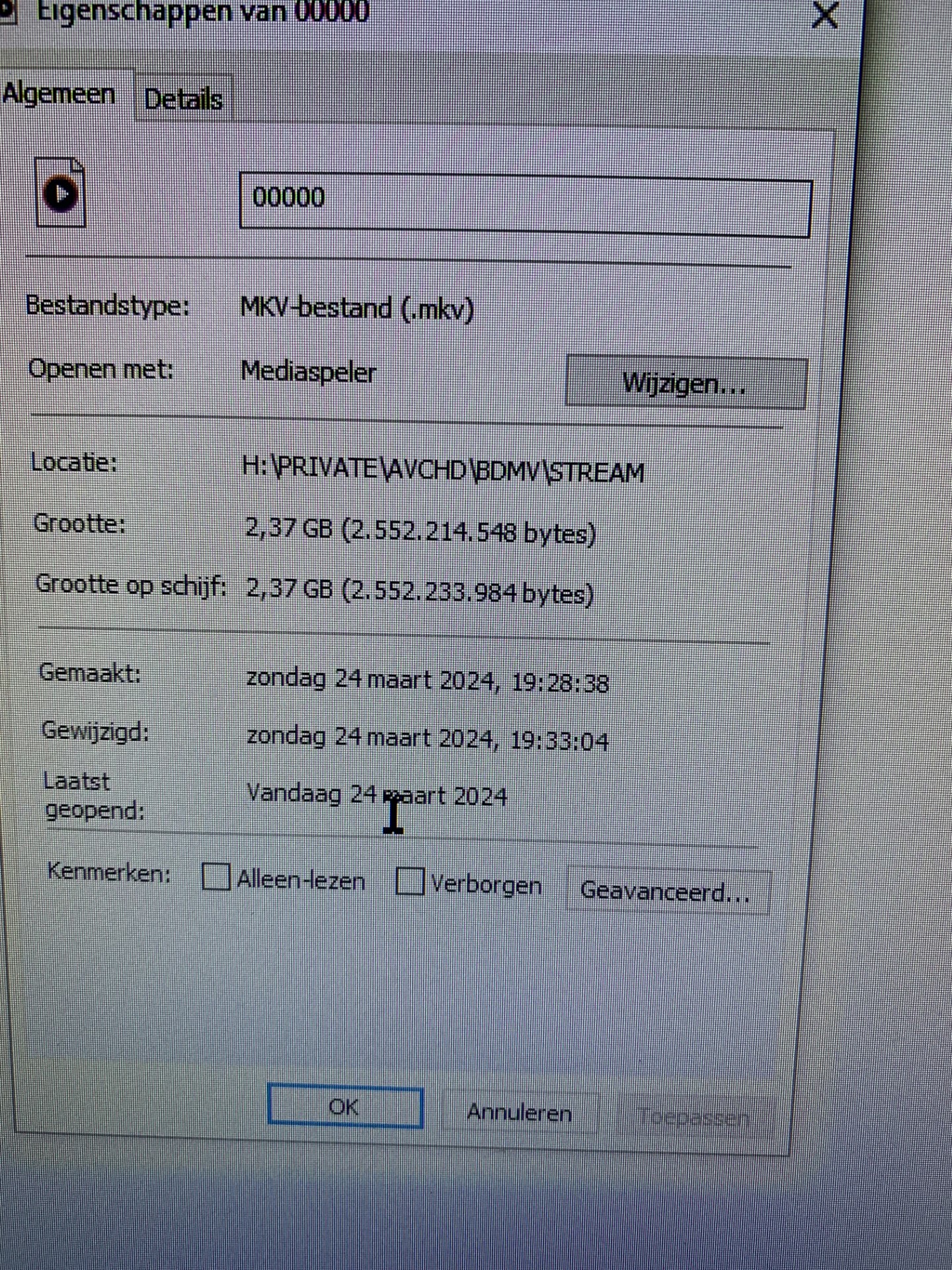

    Hey, thanks for the quick response. I Installed MKVmerge and changed the MTS to MKV, see picture below
    [Attachment 77906 - Click to enlarge]
    I put the SD card back into the media player but unfortunately it still can't play the video. And there's another thing. When I play the MKV file on the computer, the video stutters.

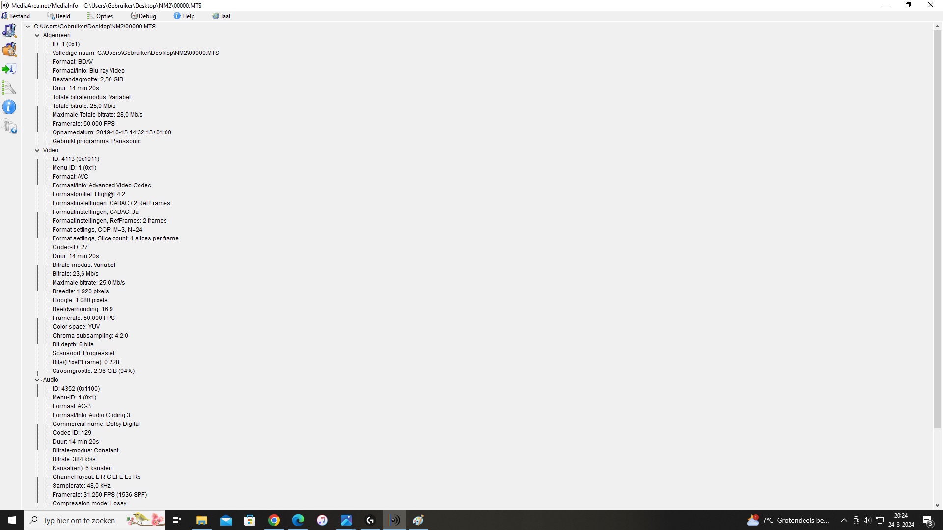

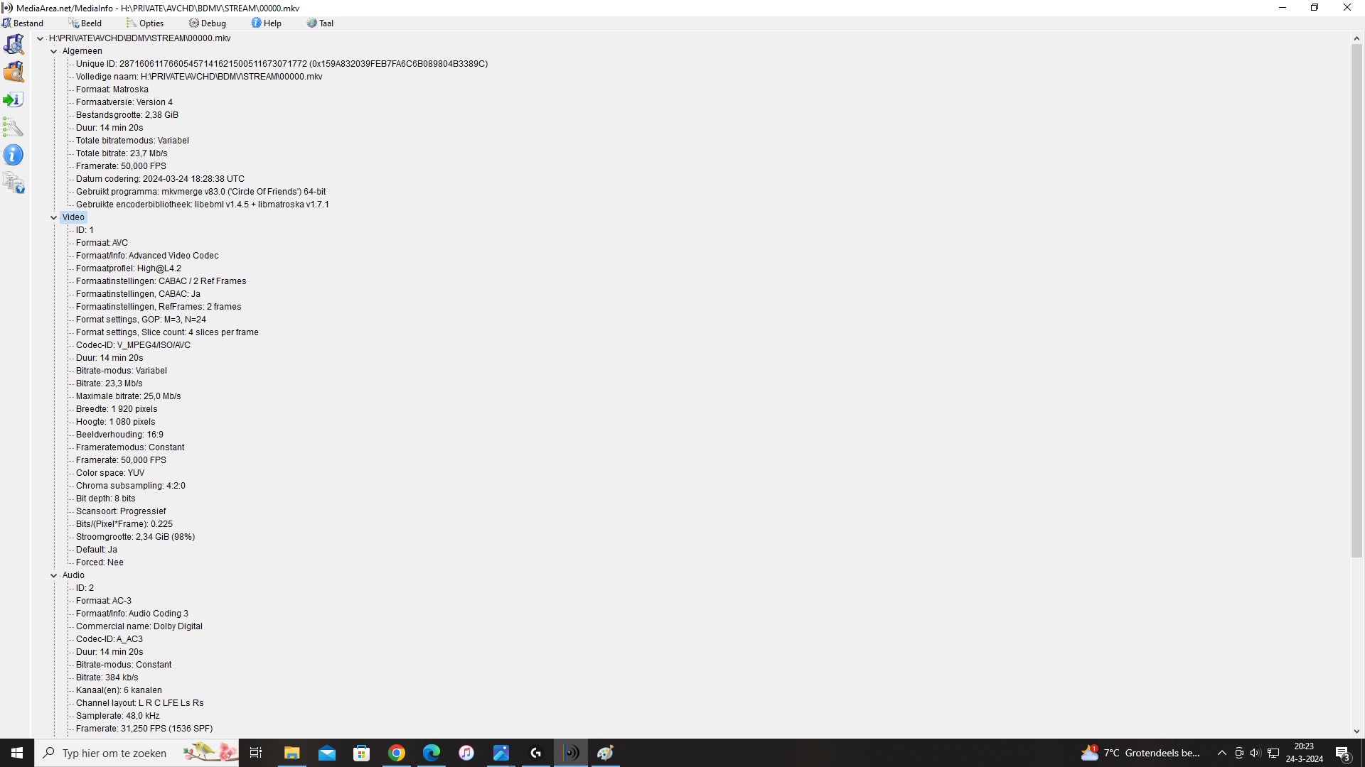

    Paste a mediainfo of the video here.
  5. Originally Posted by johns0 View Post
    [Attachment 77907 - Click to enlarge]
    Media Info MKV
    [Attachment 77908 - Click to enlarge]
    Media Info MTS
  6. I'm a Super Moderator johns0's Avatar
    canada
    The reason your media player can't play the video is cause the profile is set to 4.2,use clever FFmpeg-GUI to set it to 4.1.Also if your computer stutters it's either the media player that's causing that issue or your computer isn't that good enough to play it properly.

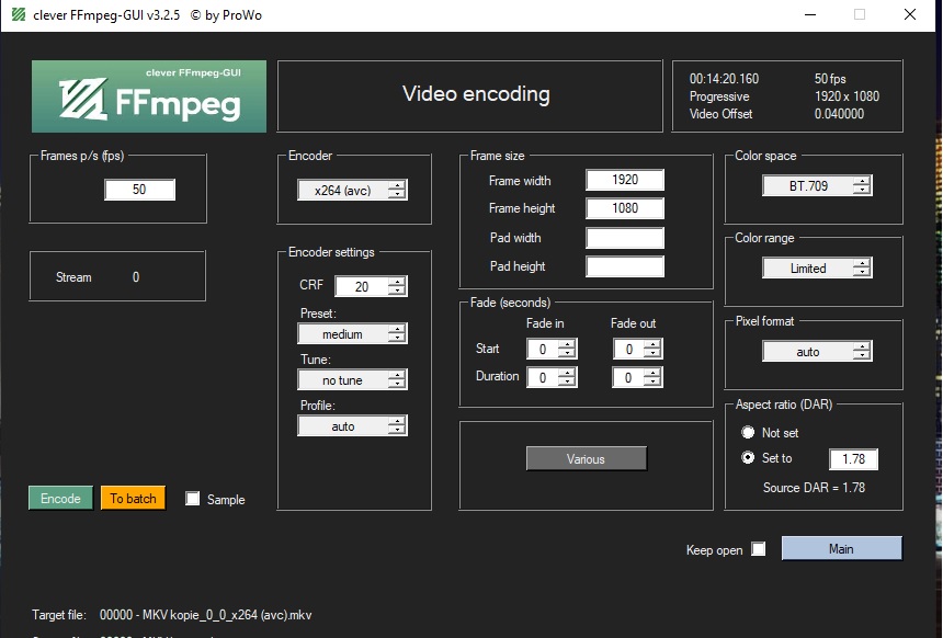

    I've installed FFmpeg-GUI. I had to download FFMpeg first and edit the systemvariables of my computer. After installing FFMpeg and FFMpeg-GUI I opened the program and went to the video editing screen. But I can't find the option to change the profile from 4.2 to 4.1, see picture below.
    [Attachment 77909 - Click to enlarge]
  8. Originally Posted by johns0 View Post
    Try pixel format,mine say change p-level.
    It's now on auto, if I go down I can choose between: yuv420p, yuvj420p, yuv422p, yuvj422p, yuv444p, yuvj444p, nv12, nv16, nv21, yuv420p10le, yuv422p10le, yuv444p10le, nv20le, gray, gray10le.
    Wich one would be 4.1?
    canada
    Try various for change p-level.
  10. Originally Posted by johns0 View Post
    When I click various, other options appear but not P-level.
  11. Main, various, change p-level.
  12. Originally Posted by ProWo View Post
    I changed it now in 4.1. But it's still not working, see below

    - AGPTEK Mini HD Media player
    your device is trash, it doesn't support avchd 2.0
    play direct from camcorder or make avchd 2.0 disc or re-encode to 720p 8mbps in mp4 container
