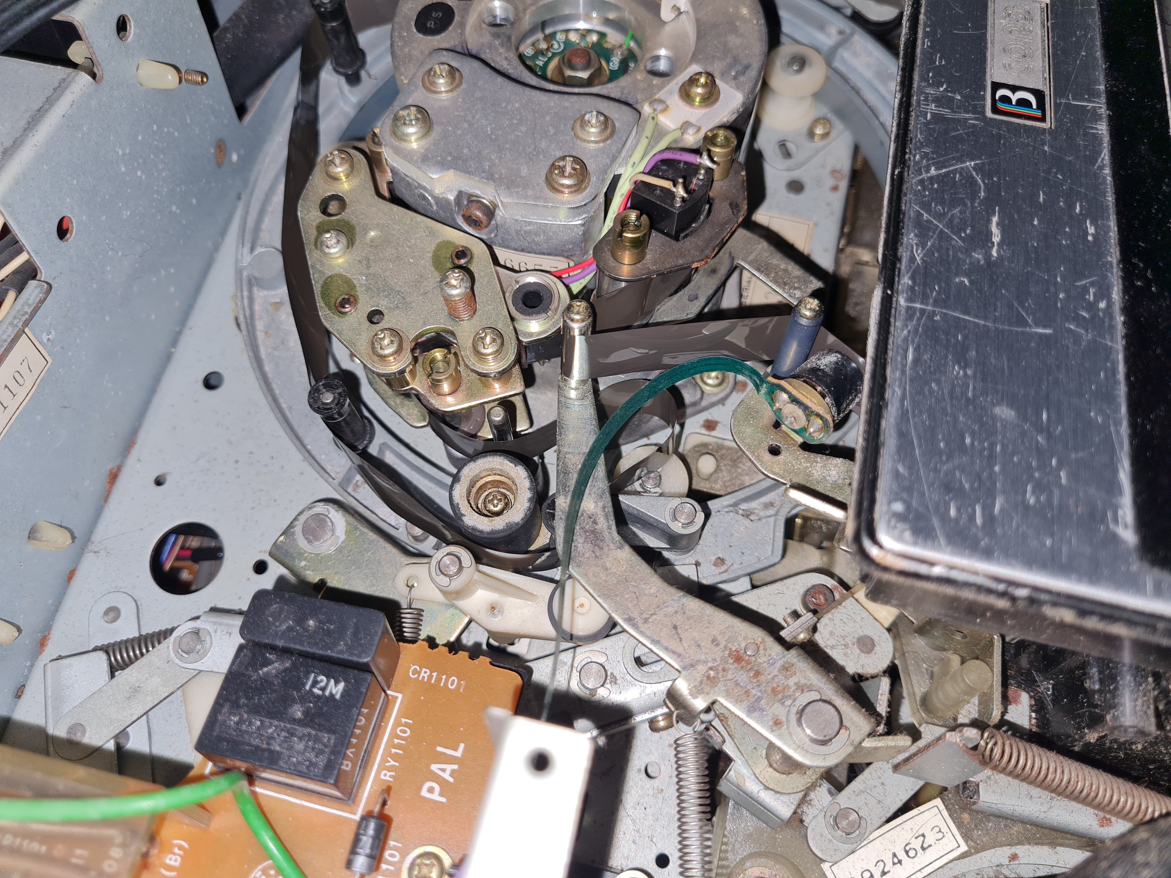

  3. Ok thanks for getting back to me. I've got the top off the recorder, it's quite dusty, & I've got rid of a lot of the dust now.
    So, I had the same problem as before, & was watching the mechanism, & noticed there was a loose loop of tape when the tape stopped. I'll add a photo, the loose loop is right in the middle. Is this the pinch roller? Or the belt/drive that you mentioned? & more importantly, is it an easy fix?
    I'll also add a clip of the picture quality of the tape in trying right now, this is probably the worst the picture has been - is this dirty video heads? & can I splice a piece of a vhs head cleaner tape into an empty beta chassis? I don't want to have to pay £50+ if there's a much cheaper solution.
    & thanks for your help too, it's much appreciated. I've got a little bit of experience with vhs players, but because of the scarcity of beta players, I don't want to start getting to deep into something I can't deal with fairly easily.

    There are various videos on youtube associated with your player, search on
    sanyo beta 9300PN
    perhaps you'll find something related.
    Failing that, unless you can spot something obvious, your best bet is to find and contact someone in the UK
    who knows what they're doing.
