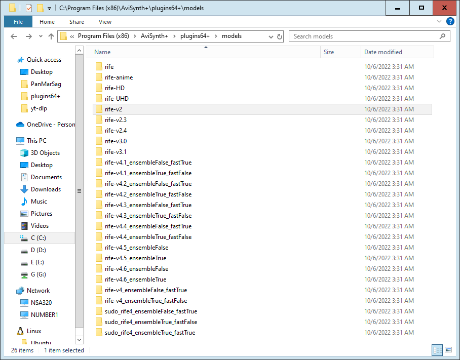

I have the 1.1.0 version installed and running. You need the rife.dll file and the models. The models should be in the same folder as rife.dll (your plugins folder if you want it to autoload), in a folder called models:
[Attachment 77871 - Click to enlarge]
You can then call it with something like:
Code:# assuming you video is already loaded # Rife requires RGBPS color format, use z_convertformat, http://avisynth.nl/index.php/Avsresize z_ConvertFormat(pixel_type="RGBPS", colorspace_op="709:709:709:l=>rgb:709:709:f") Rife(gpu_thread=1, model=9, fps_num=60000, fps_den=1001, sc=true, sc_threshold=0.12) z_ConvertFormat(pixel_type="YUV420P8", colorspace_op="rgb:709:709:f=>709:709:709:l")
