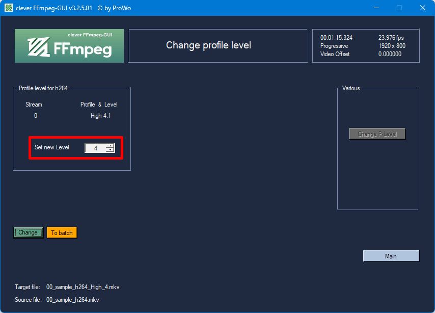

  2. For the not working mp4 it could be the x264 10bit encoding or the profile level.
    Format profile : High 10@L4.1
    Bit depth : 10 bits
    You could try to change the profile level from 4.1 to 4.0, without recoding, using clever FFmpeg-GUI.
    Load the not working mp4, click main, click various, click change P-level, set new level to 4 and click change.
    [Attachment 77828 - Click to enlarge]
    If finished, try the new generated mp4 with your smart-tv.
    If it still not work, you must recode it to 8 bit.
