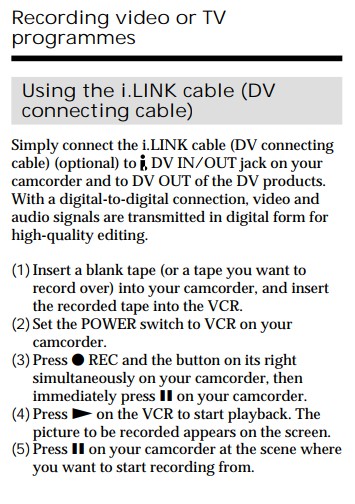

    From the manual: "Recording video or TV programs" aka "Print to tape":
    [Attachment 77859 - Click to enlarge]

    So are you saying "print to tape" works on premiere but not on WinDV?
    No, I was saying that it works for me now with WinDV when I press record on the Camcorder and record in WinDV.
    Then I was just stating how it normally should work in Premiere. (Where Premiere controls the camera with no need to press anything on the cam.)
    Why Premiere is not sending video out to the cam is still a mystery…
    So now I know that it was not the camera, but Premiere that’s the problem.
    My second problem with the cam recording black screen when filming, seems to be a capacitor that is faulty, but for now I don’t need it to film, I just need to use the VTR function of the camera to transfer MiniDV tapes to PC… - That function is working in both WinDV and Premiere with Firewire.
    And if I need the cam to record/print to tape from the PC again, I can just use WinDV for that.
