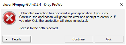

Screenshot of error message -
[Attachment 77791 - Click to enlarge]

The error message says, that it can't access the video.
Do you have the necessary rights to access the file?
Move it to another location and retry.
If this doesn't work, cut 30 seconds from your vp9 video with avidemux and post it here.
So i can take a look. -

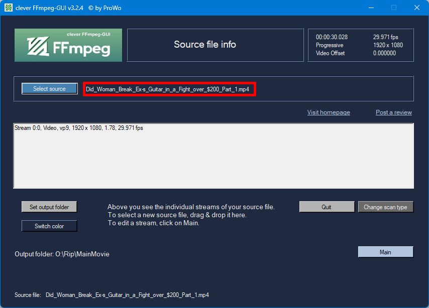

No problem to load your file here, as you can see:
[Attachment 77799 - Click to enlarge]

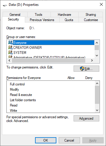

This has nothing to do with the clever FFmpeg-GUI, but with the necessary rights to access the hard disk.
Right-click on partition D: (in Windows Explorer, on the left side), set Properties, Security and post the picture here. -
So, general users have no rights on the drive (unless they are in one of the other groups)
users currently on my ignore list: deadrats, Stears555, marcorocchini -

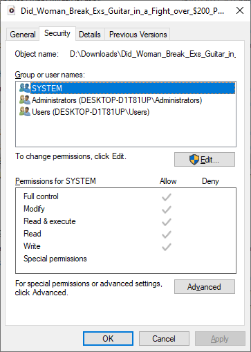

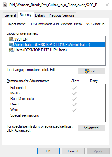

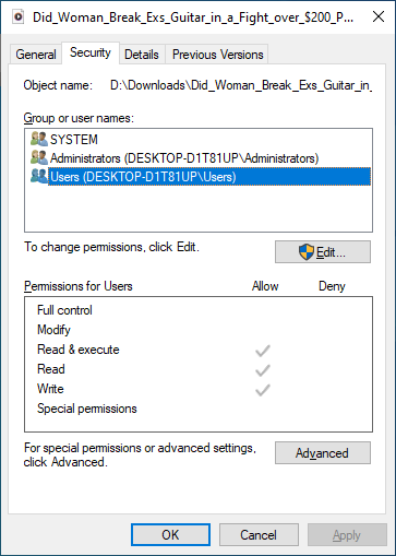

Right click on it, properties, security, post the picture. -
Screenshots of VP09 clip security settings for system, administrator, and users -
[Attachment 77801 - Click to enlarge]
[Attachment 77802 - Click to enlarge]
[Attachment 77803 - Click to enlarge] -
Finally figured out how to change permissions to enable Users Full Control.
clever FFmpeg-GUI now loads the VP09 encoded clips without issue and without having to run it as Administrator!
Thank you very much for your time!
EDIT: I just now checked the User permissions for the re-encoded (x265) clips, and Users do NOT have Full Control, and yet I can open these clips without issue in clever FFmpeg-GUI!?
Why do the VP09 encoded clips need to have Users Full Control permissions, and yet the x265 encoded clips do not require these permissions in order to load them into clever FFmpeg_GUI?Last edited by meeshu; 18th Mar 2024 at 05:17.
I think that the access rights were compromised.
You can reset the rights to those of the other videos as a test and see if it still works. -
Yes! I reset permissions for the VP09 encoded clips back to how they were originally, and all of these clips now successfully load into clever FFmpeg-GUI without having to run clever FFmpeg-GUI as an Administrator!
So it seems you were correct in that these original video clips were compromised/corrupted in some fashion somewhere along the line.
Thanks again!
