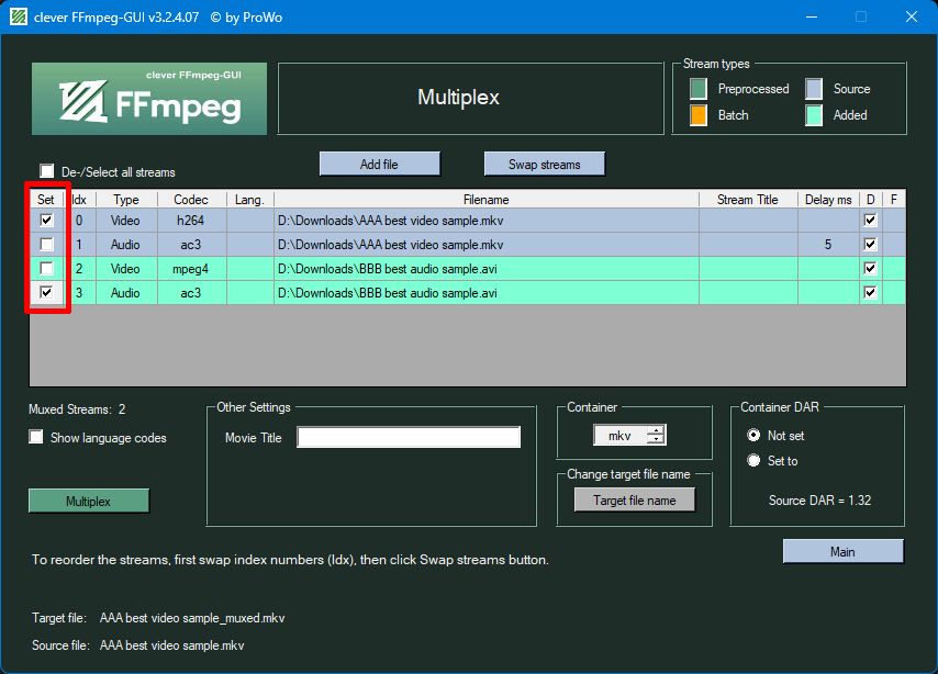

Use clever ffmpeg-GUI.
Load AAA, click main, click multiplex, drag & drop BBB, select the tracks like in the picture, click multiplex.
Done.
[Attachment 77777 - Click to enlarge] -
Thanks, ProWo, that's a nice tool. However, it gives the same output as muxing with mkvtoolnix i.e. loss of sync as the film progresses. What I'll probably end up doing is an edit of each scene using audioshift as necessary then stitch the scenes.
