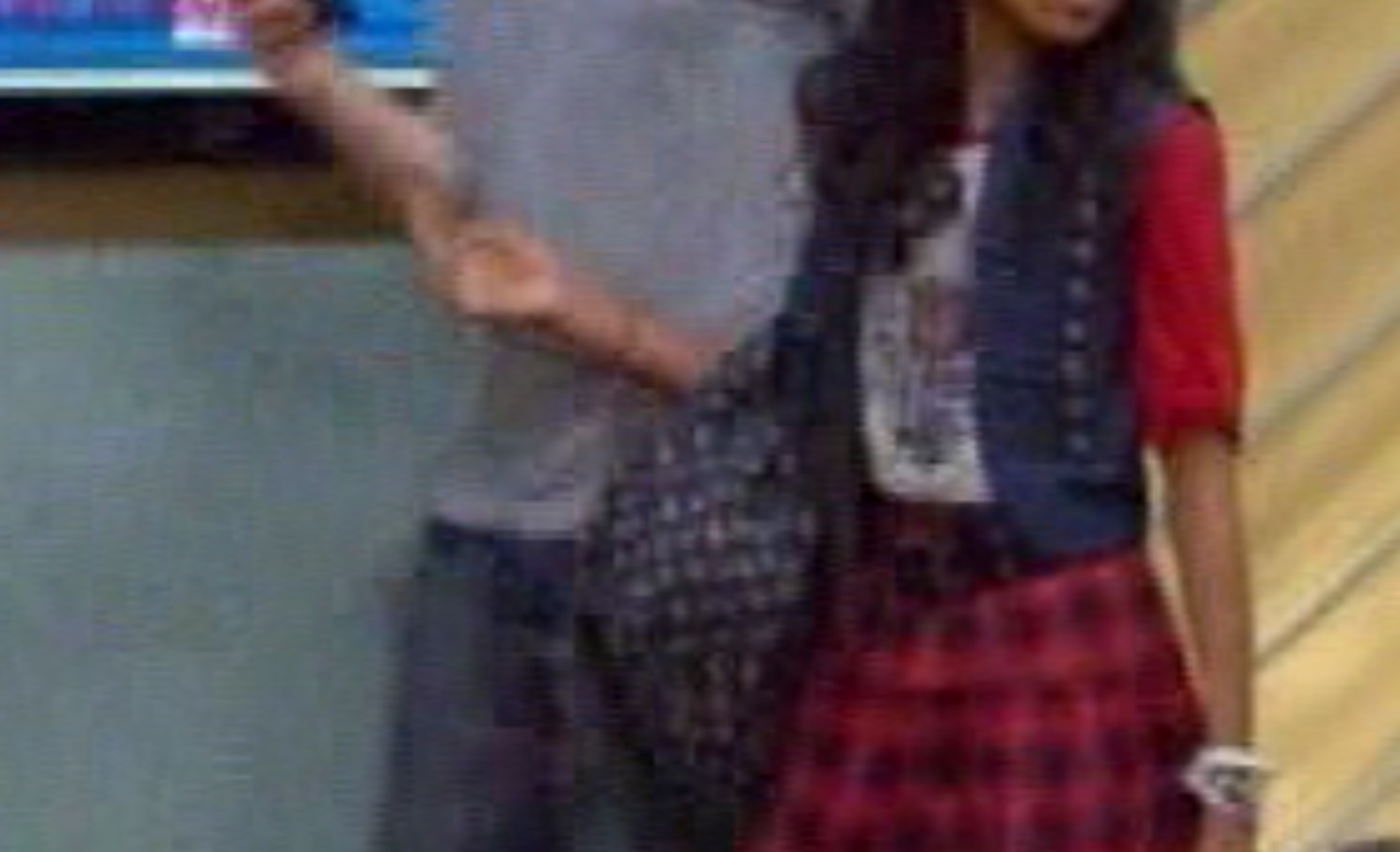

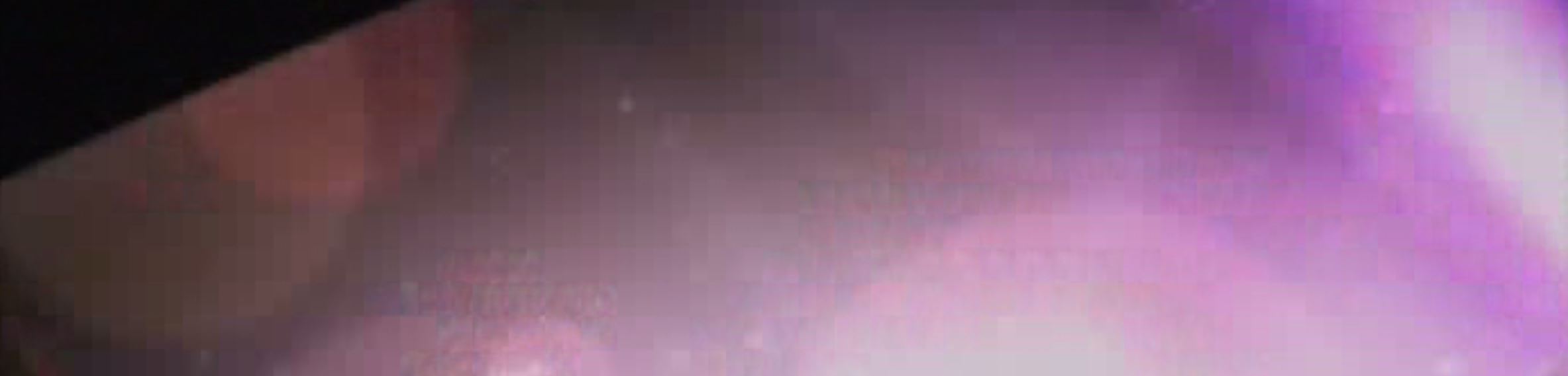

  8. Holy shit crap efen a DVD recorder puts analog into more crap.
    720x576 and 4489 kbps MPEG2, and full of macroblocks on most part. Terrible!
    If i'm not false this was a Sony recorder, otherwise a Panasonic. otherwise it was at least a Samsung, although I don't remember that
    However this is not from a VHS but from analog TV (but that in some way the same, only a higher resoltion)
    The second is from the Samsung recorder, if i'm right.
    In some way the HDMI stick is better, at least there are no macroblocks at 50.000 kbps.
    That bitrate would be near the minimum threshold of what you can use for that resolution with MPEG2 encoder. You'd only set it that low if file size is concern. If the macroblocking is too much and you need to maintain smaller file you need to decrease the resolution. If file size is not a concern set the bitrate higher.
    Do not use DVD Recorder for recording, only as a converter to HDMI.
    Of course, to use for HDMI ripping, use something good, not this HDMI stick.
