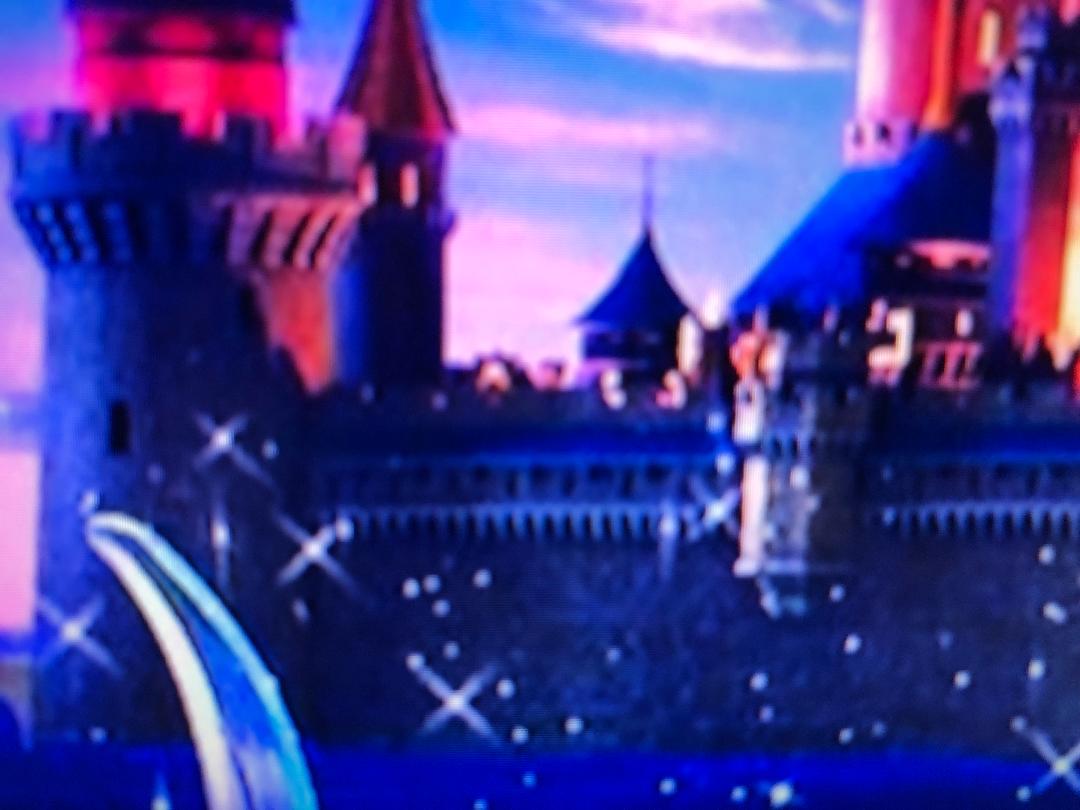

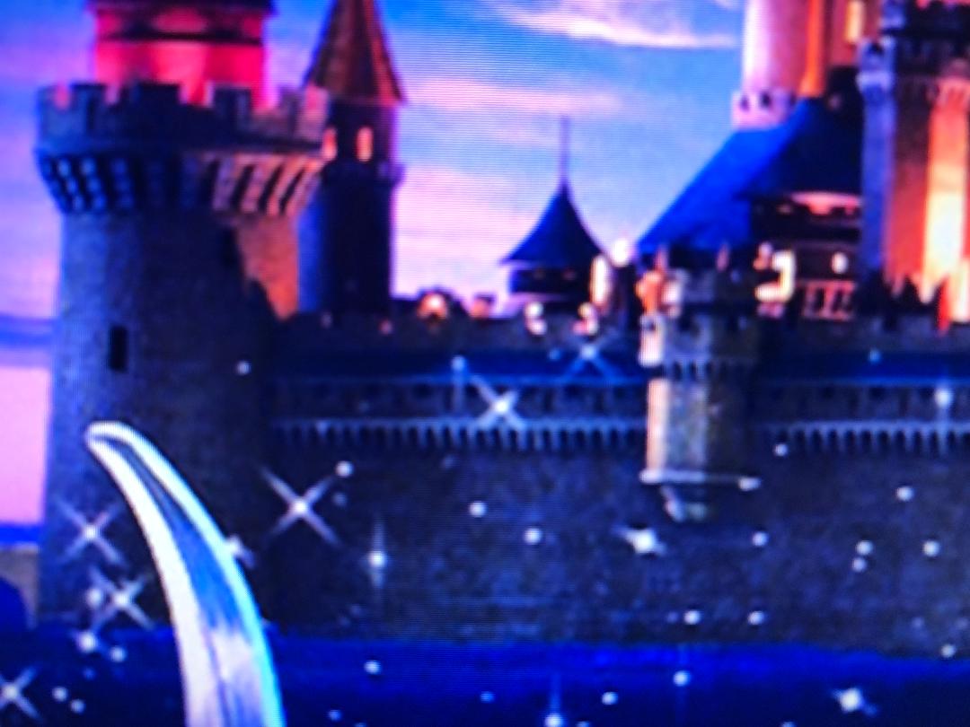

  3. I have capture a Blu-ray from source and the qaulity is excellent, same capture stick of 6,99 euro's.
    Copy:
    [Attachment 77683 - Click to enlarge]
    Copy and original enlarged:
    [Attachment 77684 - Click to enlarge]
    [Attachment 77685 - Click to enlarge]

    It is the same HDMI capture device turned analog noise in digital noise.
    And that mystery device is ... ?
