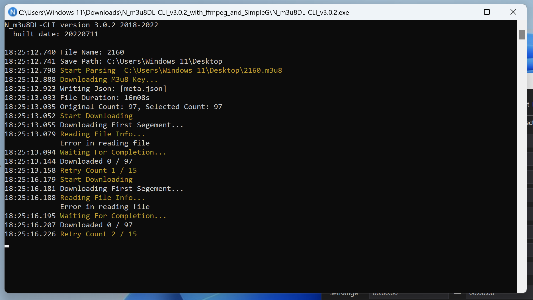

  7. Using N_m3u8DL-CLI_v3.0.2_with_ffmpeg_and_SimpleG
    And using just the index.m3u8 link and pressing go. It didn't work.

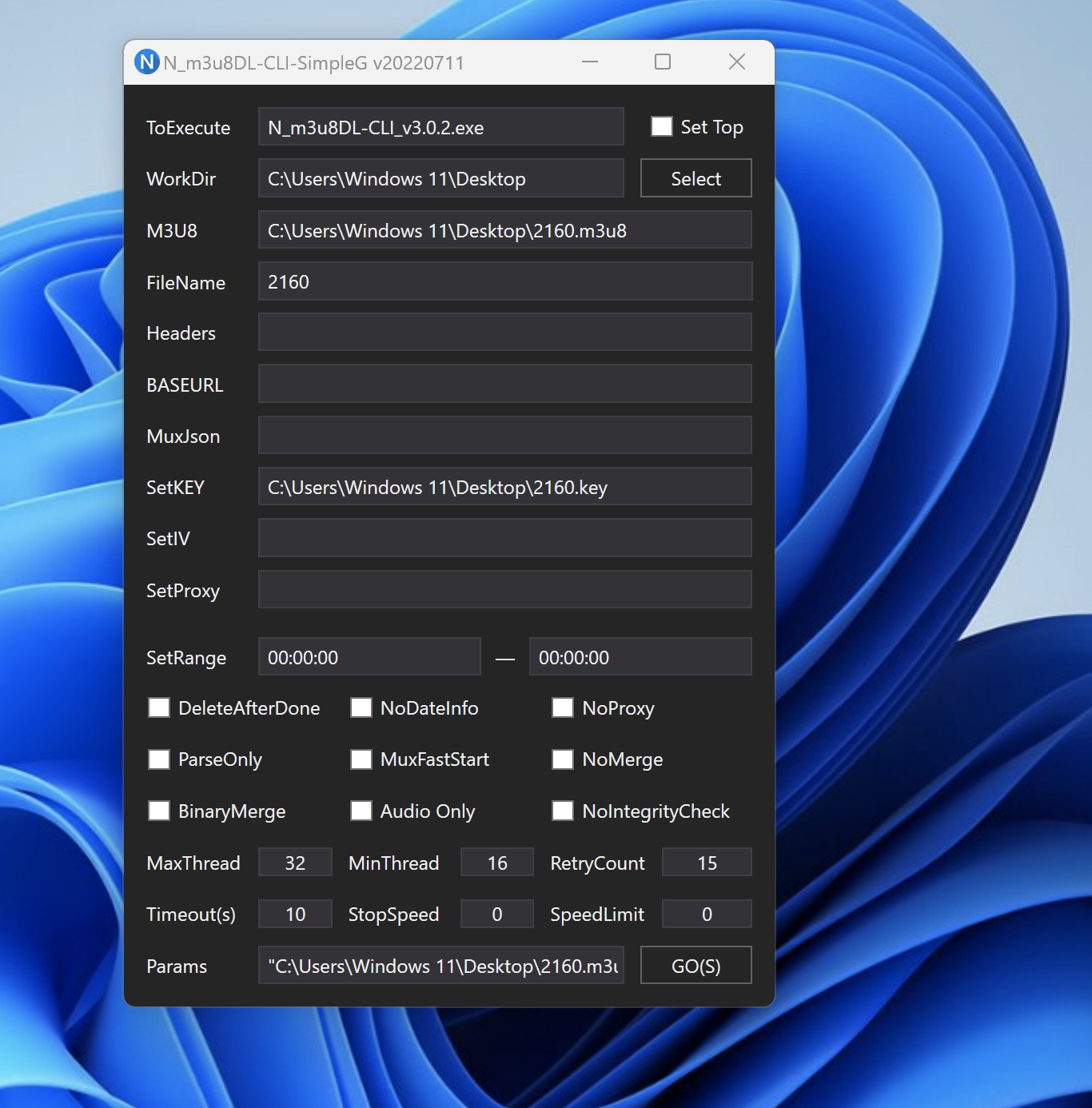

  8. I've also found the key for 2160.m3u8 which is 16 bytes in size but when I place them and press go. I get error's.
