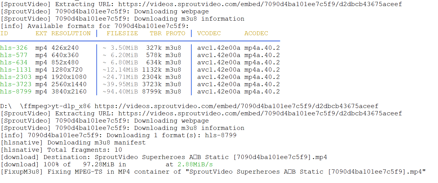

    https://sproutvideo.com/
    yt-dlp_x86 -F https://videos.sproutvideo.com/embed/7090d4ba101ee7c5f9/d2dbcb43675aceef
    [Attachment 82159 - Click to enlarge]
    it's simple
