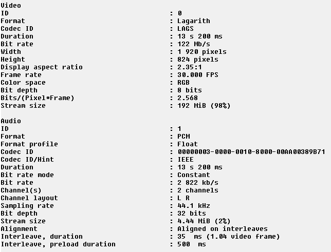

    Here is MediaInfo on this clip -
    [Attachment 77645 - Click to enlarge]

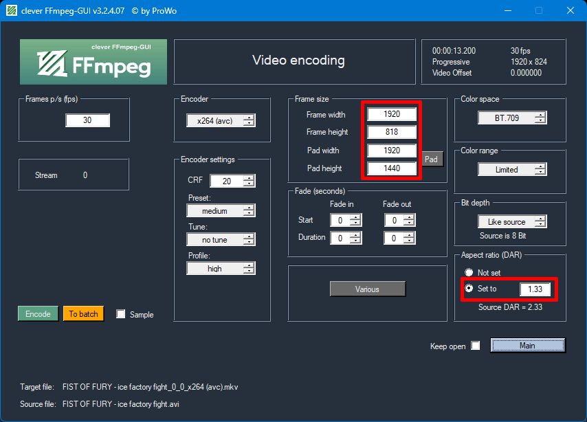

  4. I would keep the width. The source video has an aspect ratio of 2.33:1, but the original is 2.35:1, so the height must be corrected to 818 before padding.
    Afterwards padding to 1920x1440 (4:3).
    [Attachment 77650 - Click to enlarge]

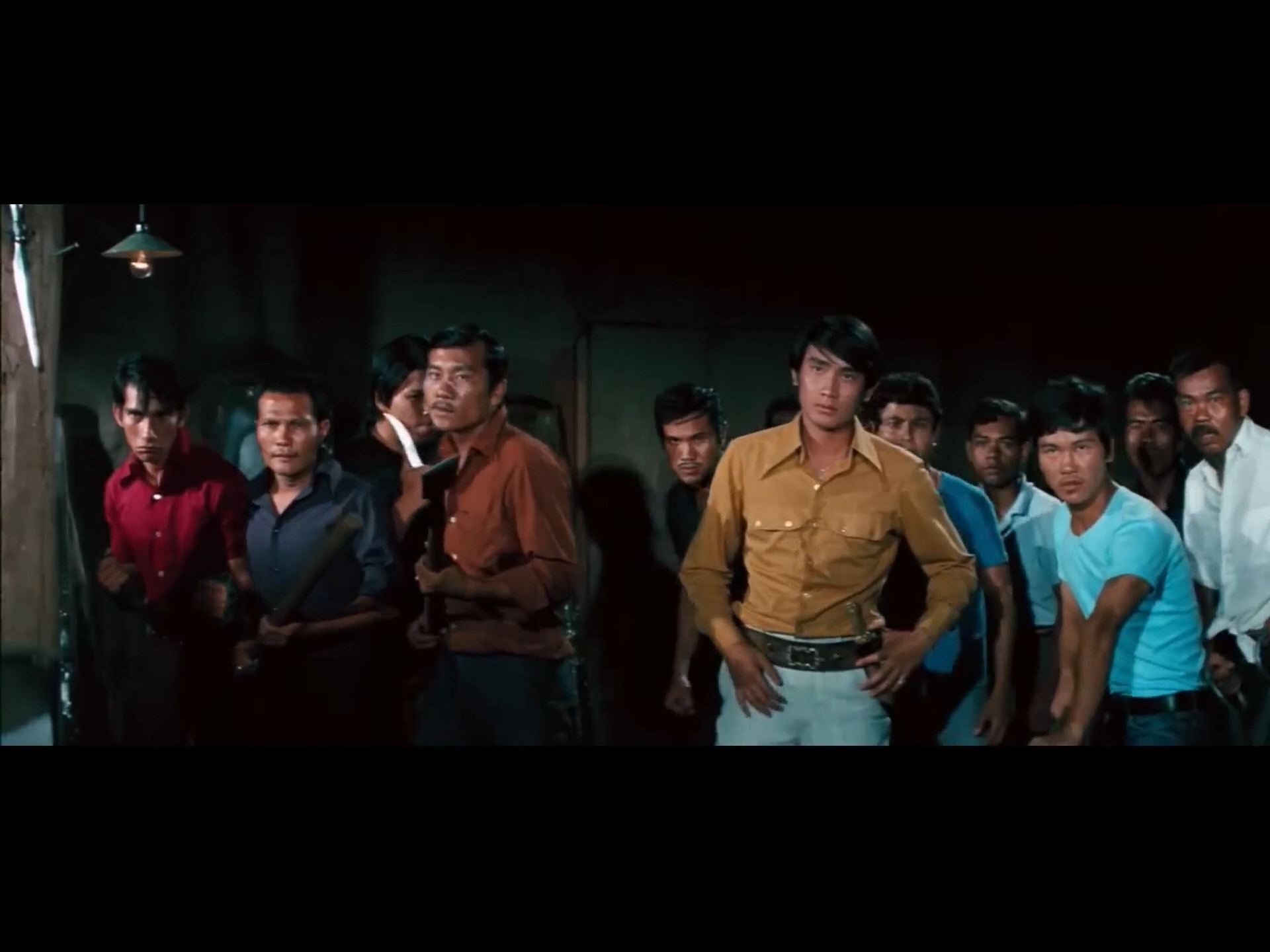

Name:	FIST OF FURY - ice factory fight in4-3 frame.jpeg

    It is as simple as adjusting commandline b) of post #5 accordingly (changes are in red):
    ffmpeg -y -i "%~1" -c:a aac -c:v libx264 -preset slow -crf 20 -filter:v "scale=w=1920:h=1440:force_original_aspect_ratio=decrease,pad=1920/sar:1440:-1:-1:color=black" "%~1_padded.mp4"
