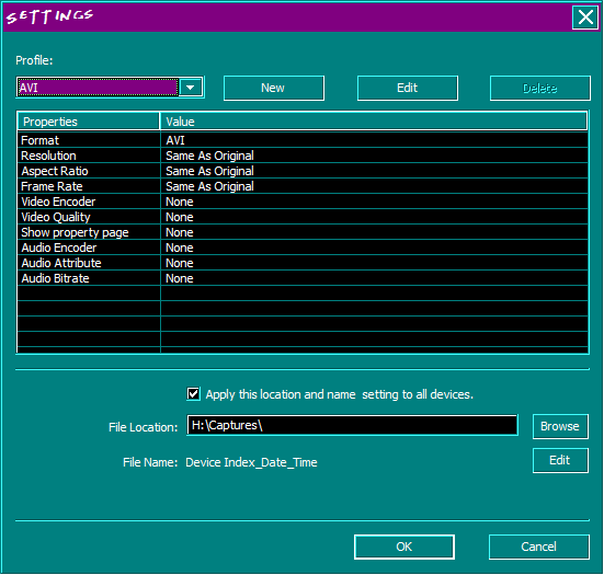

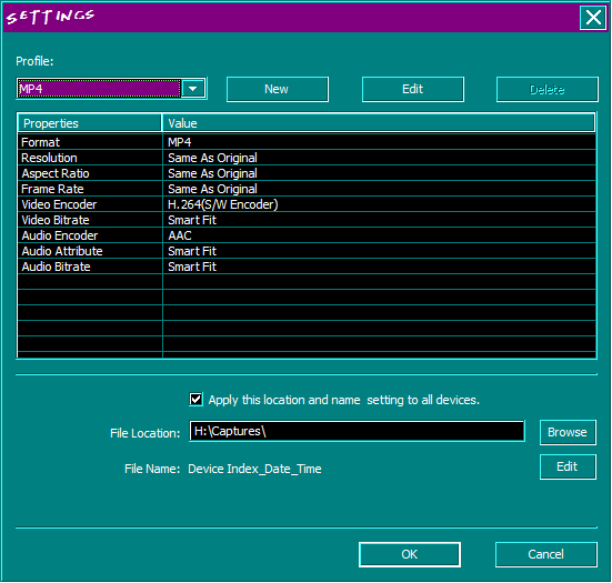

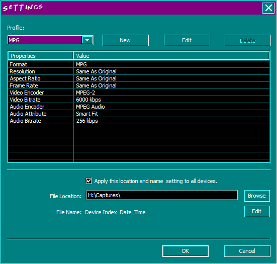

    FYI: most commercial software that captures into DVD-compatible format use 8 Mbps CBR as the highest-quality format. Technically, DVD-video is limited to 10 Mbps overall, so 8 Mbps for the video and the rest is for the audio, subtitles, and just to stay below the limit for better compatibility.
    you shouldn't be using an MPEG encoder for capture anyway. Why discard detail and create DCT blocking and ringing artifacts right off the bat?
    Because for many cases it is good enough, small enough, fast enough for encoding, fast enough for editing, the resulting file usually has correct metadata regarding interlacing, field dominance and aspect ratio. So, it is watchable and compatible. Yes, sometimes it is blocky. I've switched to MPEG-2 for capturing a bunch of tapes with music videos - I capture them, I chop off the beginning and the end without re-encoding, and I upload them to Wayback Machine, because YT keeps blocking them. Then whoever downloads them can decide whether they want to plop it on a DVD or deinterlace, upscale and upload to YT or watch as is.
    Just for fun I attached all four default profiles from AverMedia Capture Studio. So, they use 6 Mbps for MPEG-2, not 8 Mbps. Looks like it is hardware-encoded. AVI seems to be uncompressed, VDub says it uses internal DIB decoder for it.
    There is a separate dialog for deinterlacing!
