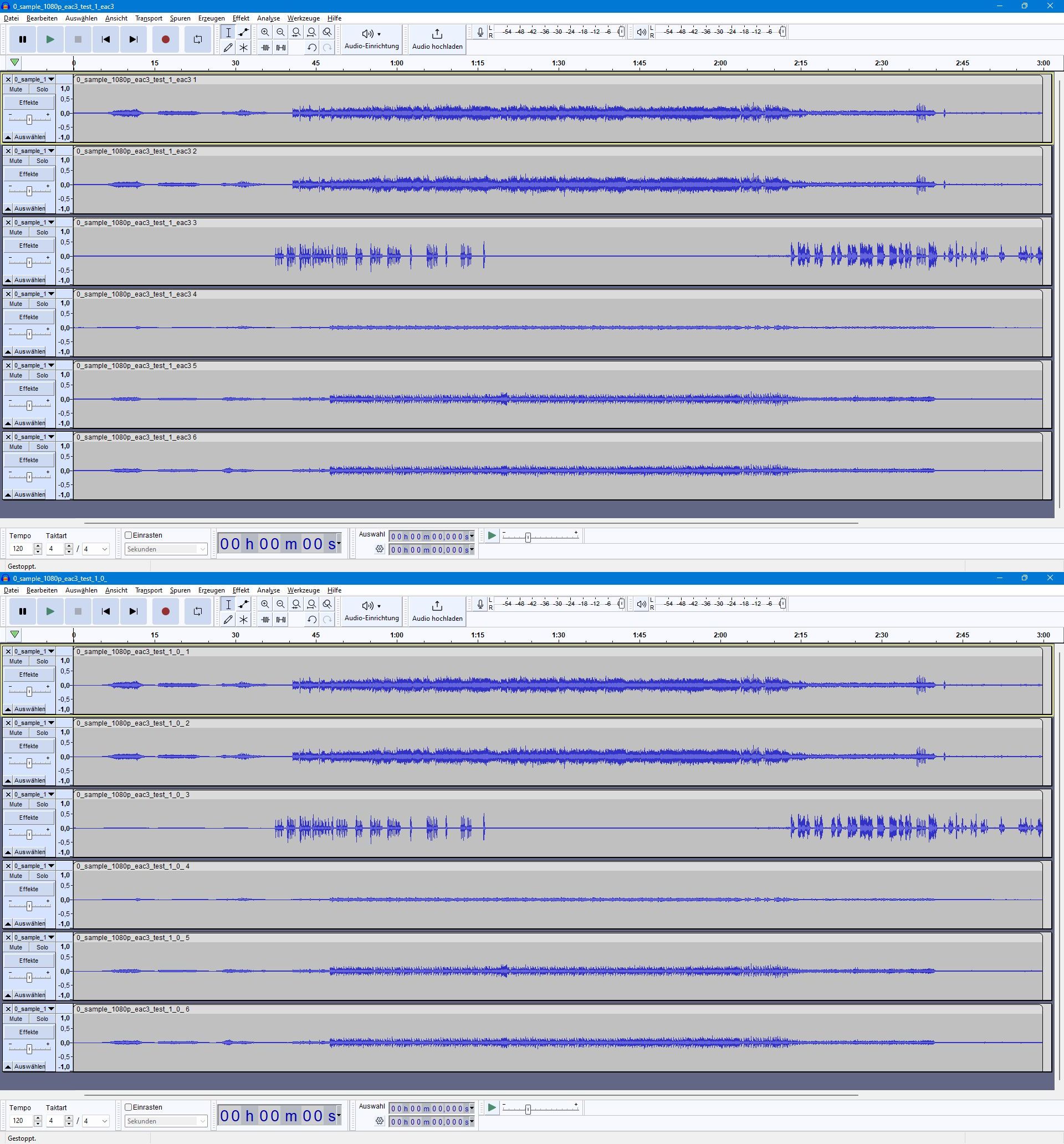

The channels are not swapped in the eac3 to wav conversion.
In the picture above the 6 eac3 channels, in the picture below the 6 wav channels.
[Attachment 77625 - Click to enlarge]
Used ffmpeg version 2024-02-26-git-a3ca4beeaa-full_build-www.gyan.dev -

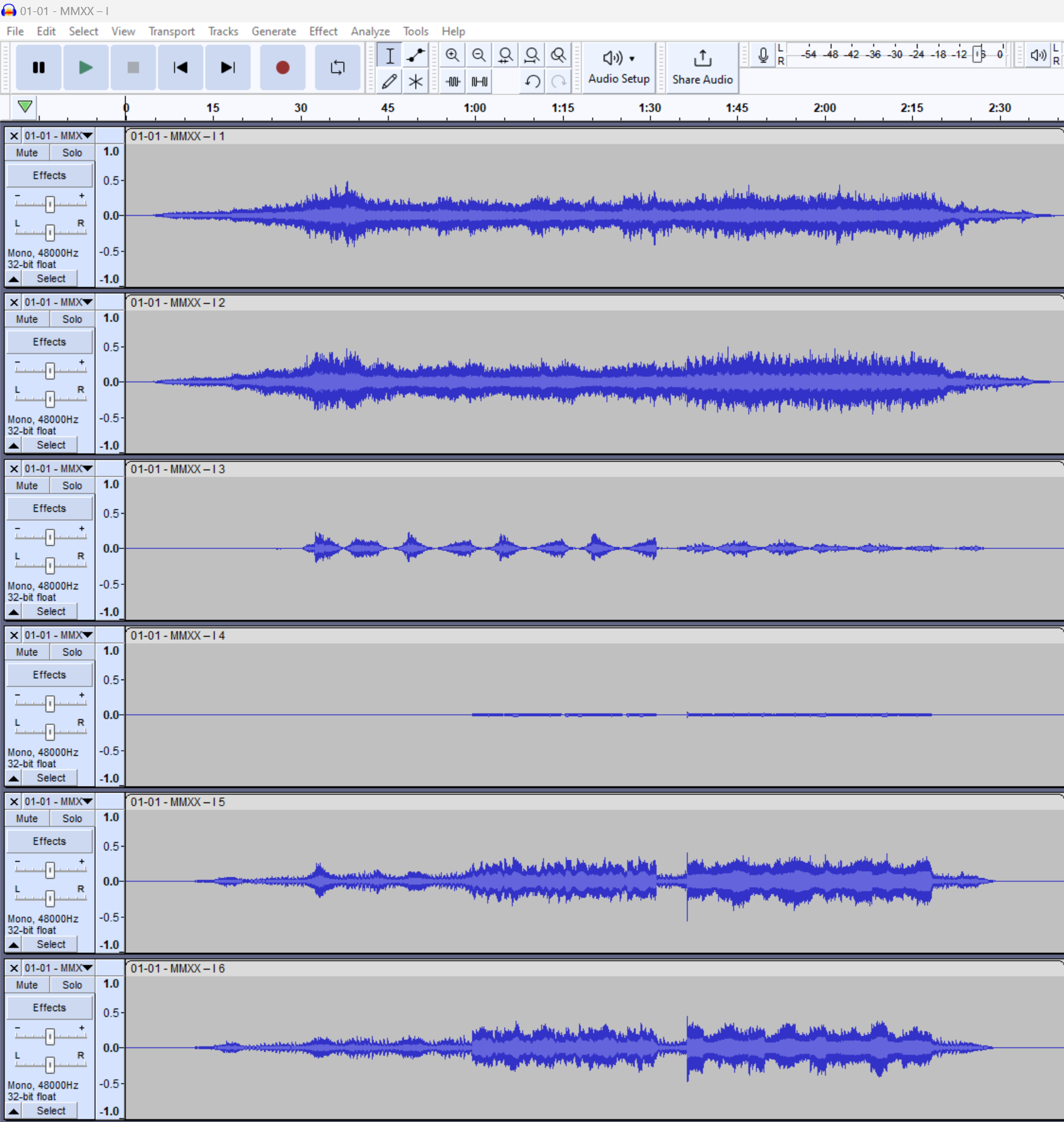

I finally figured out what is probably going on here:
This is the channel assignment of the original E-AC3 JOC Dolby Atmos file:
[Attachment 77626 - Click to enlarge]

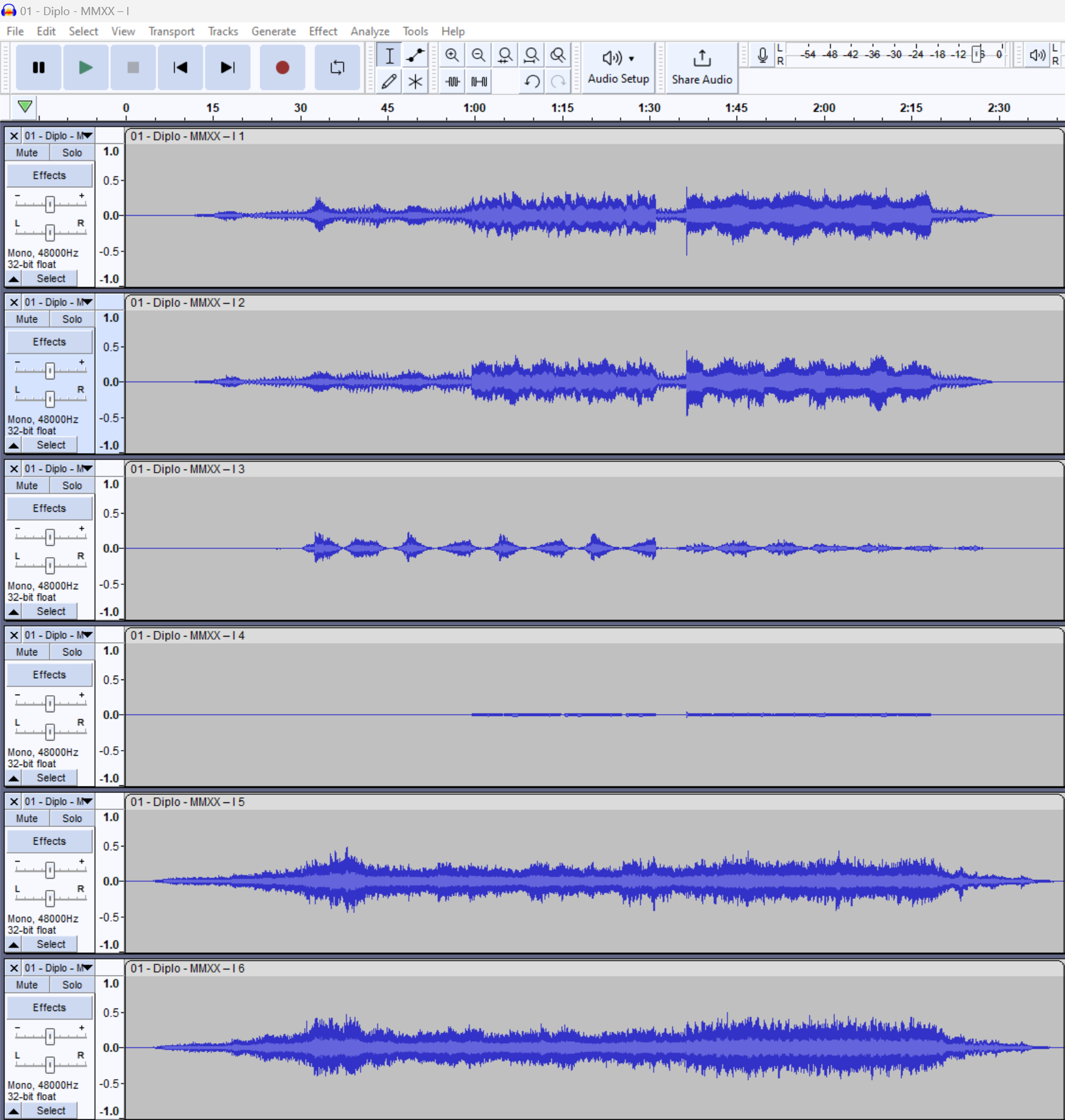

This sounds weird and I can see why. There is much more energy in the rear channels than in the front. After front / back reversal (in the MCh FLAC) this is what it looks like and it sounds fine.
[Attachment 77627 - Click to enlarge]
I have no clue why the channels were reversed in the original Dolby Atmos file. -
