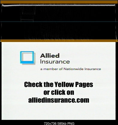

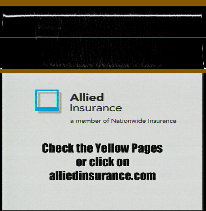

    First off, I usually adjust levels for all my tape transfers, VHS or Betacam. I lower the brightness until the blackest part of the tape is at 16, then I raise the contrast until the brightest point of the tape clips at 235, then I bring it down until it isn't. But a dilemma I've been having is that there's some instances with white text or an all white background. Even though they're white, some pixels clip.
    RAW:
    converttoyuv444(matrix="rec601", interlaced=true).convertbits(10)
    Levels(55, 1, 905, 0, 1020, coring=true,dither=true).tweak(bright=0, cont=1.00, hue=-0, sat=1.0, coring=false, dither=true).convertbits(8)
    Should I still adjust until it's not clipping or is it OK for it to clip since it's an all white background?

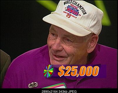

    No Denoise+Sharpening, Aspect Ratio Corrected, Cropped, Upscaled to 4K

    I believe if you can take HDMI out of the equation you will get better results, I also see dot crawl, this could be baked in the tape or the deck is causing it, The Y level should be legal 16-235 range, it should not be clipped at all.
    So I guess I should keep it lower, got it. It doesn't look too bad either way and it doesn't affect the main content, just the text and any white background where only a few pixels clip.

  4. @ENunn: You need not worry too much about occasional short luma excursions beyond 235 or below 16. It may be caused by noise and sharpening halos at high contrast edges.

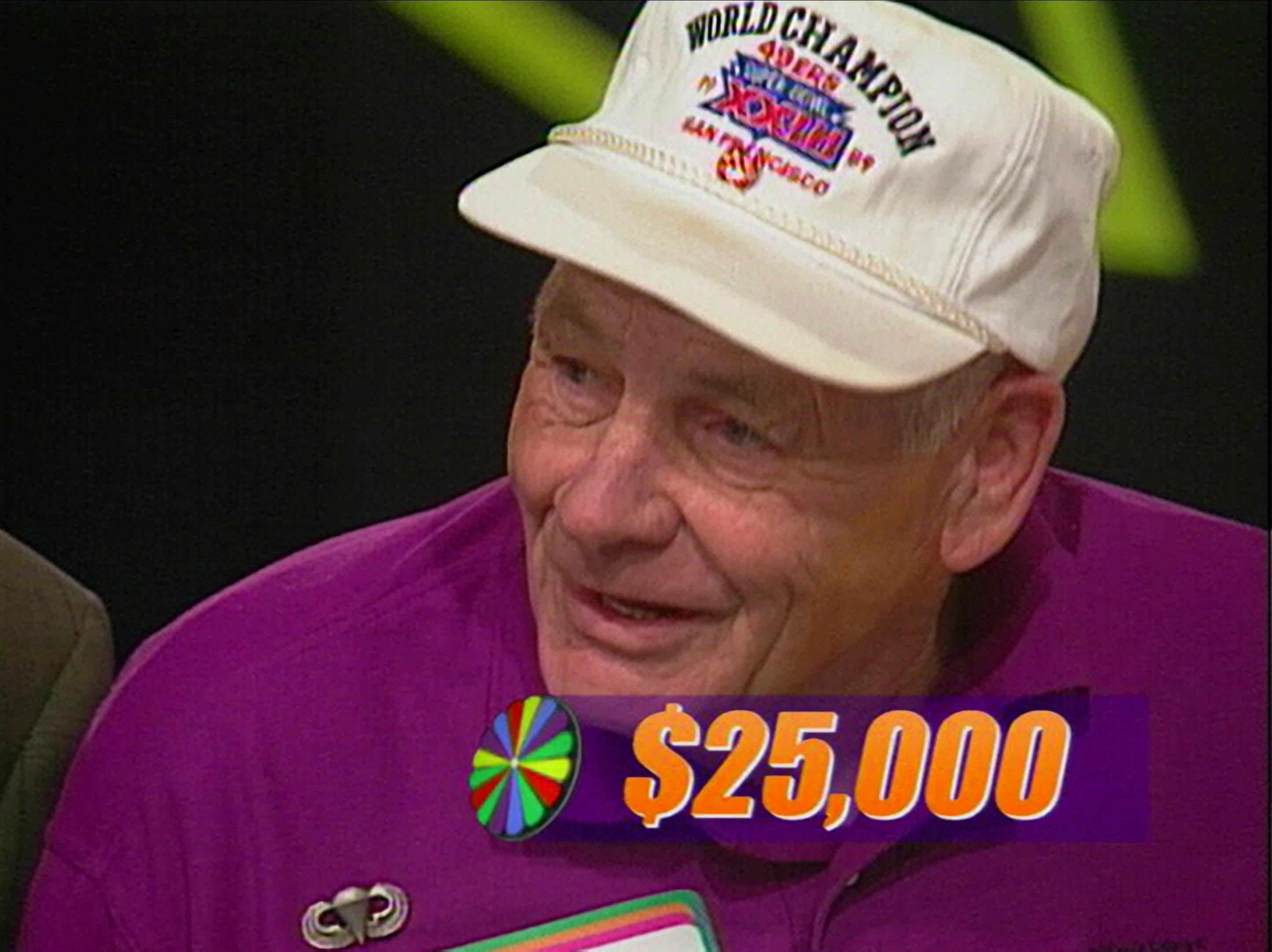

    Too much NR for my taste.The texture is lost. The edge of his right cheek - left on the picture - shows strong aliasing compared to the soft edge of the original.
    Gotcha.

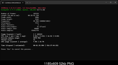

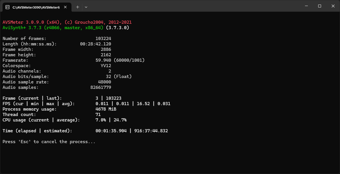

    Your script is quite "heavy" I think. You may want to identify the "time guzzlers" using AvsMeter which is included in AvsPmod (Video->Tools....), and/or by enabling/disabling individual filters.
    AvsMeter is barely running. It's been sitting at this for more than five minutes. I have done nothing to my script other than change prefetch. I did an encode overnight and I was getting 2-3fps. Now I can't even get that much.

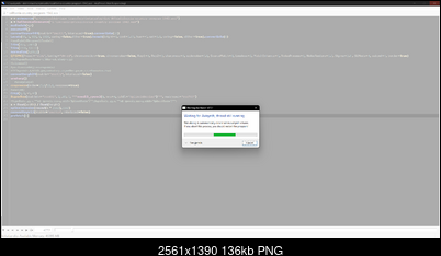

    I think Prefetch is causing the slowdown. It shouldn't, but every time I try to add Prefetch, Avisynth either hangs or takes ages to process the preview. I really don't know what's going on.
