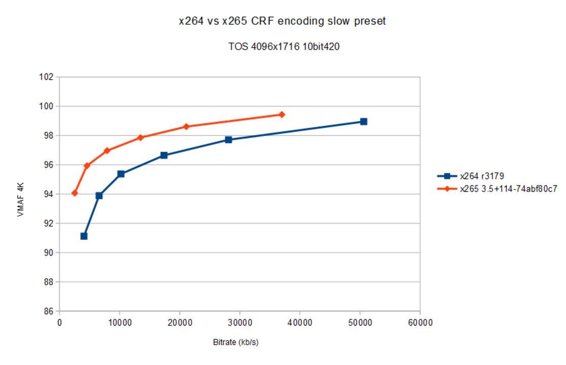

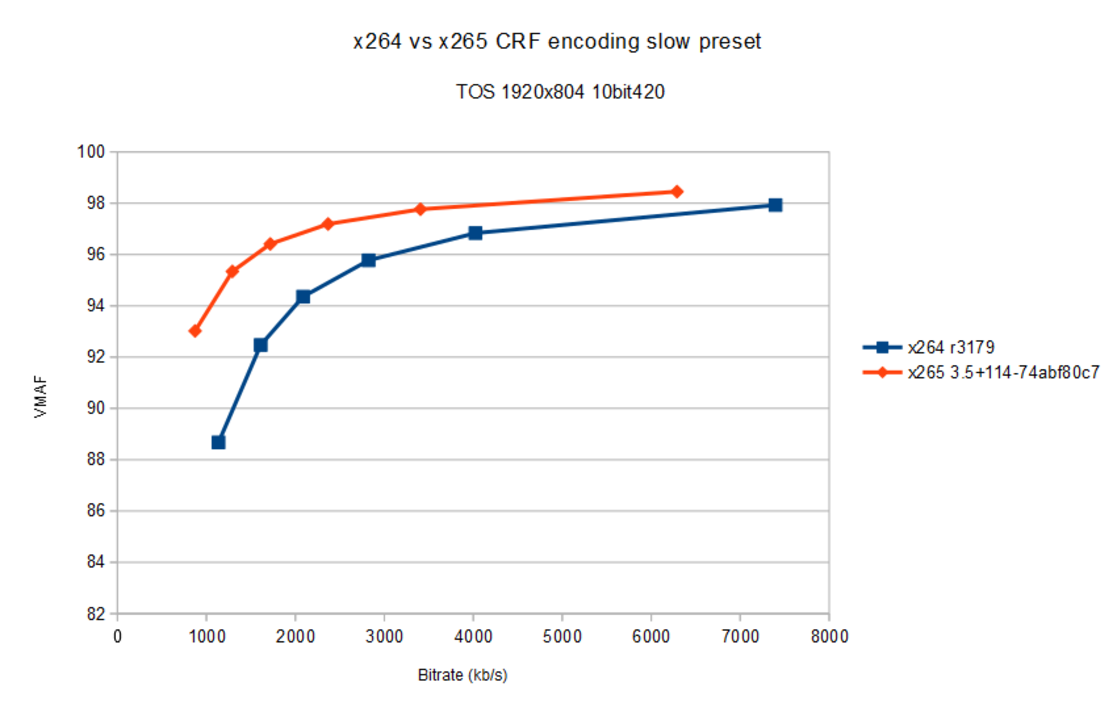

  4. This was from the Tears of Steel DCP test. 12bit444 was converted to 10bit420 using zimg , and the 10bit420 version was the reference. Zimg also used for the downscaled version using the default bicubic resampling
    Encoder versions posted in the graphic . Only command was --preset slow for all of them and varying CRF plotted with their resulting bitrate for the RD curve
    719,999 more tests to go...

  6. Originally Posted by poisondeathray View Post
    Wheres the files? I see only a tiny improvement in the graph, unless VMAF is like SSIM where 98 is twice as better than 96.

  7. Originally Posted by Aludin View Post
    Search for "Tears of Steel DCP Test" to download the source
    Read about VMAF and what it actually measures, and "3H" viewing distance . It's a linear scale that maps human perception
    https://netflixtechblog.com/vmaf-the-journey-continues-44b51ee9ed12
    https://github.com/Netflix/vmaf
    It's not a perfect metric, there are many pros /cons, but arguably it's the best one right now for measuring subjective perception under their defined viewing conditions, has at least some temporal components, and high correlation with test subjects, large sample sizes and participants. It's the probably the only commonly used metric that has been updated and improved consistently over the years, with the last update in Dec 2023. There is a large community and feedback, and you can report issues, or test cases where the metric "fails". For example, you could apply some filters, sharpening to "cheat" and improve scores on the v1 metric, but improvements negated that in later versions.
    https://videoprocessing.ai/benchmarks/video-quality-metrics_frm.html
    Read graphs like you would for any metric. At any given "quality" level on the Y-axis, what bitrate on the X-axis is required to achieve that ?

  10. Originally Posted by Aludin View Post
    There are many sources. They list a 6GB MOV download, a 4TB download, a Youtube source, which one did you use for this test?
    More importantly, where are the encodes?
    It was this one
    http://download.blender.org/mango/dcp/tos_dcp_test_04.zip
    I deleted the encodes, it's just a quick meaningless test. I was more interested in looking into Netflix claims at 1080. Probably a way to justify their quality...
    I read about VMAF years ago and all I remember is not being impressed and ignoring it, I forget why. It was inferior to SSIM+ but as it's closed source, I had to stop using it since the numbers wouldn't mean anything to anyone else, so I might have to revisit VMAF if this is the new in thing.
    I wasn't impressed either at first. But I've used it a lot over the years along with other metrics, and now I'm convinced it probably does have the highest correlation. There are many papers that essentially say the same thing. It's still 1 measure, not perfect, so I wouldn't bet the house on it either. VMAF is used frequently by the industry, so start getting used to it.
    Personally , based on quite of bit of usage, I don't agree with the 50% less bitrate claim at full HD resolutions across all types of content (and not just by metrics either , also by eye). It's probably closer to ~20-30% average for me. Basically closer to ~1/2 of the generic HEVC vs. AVC claim. Definitely not below 10%. But at UHD, that value is probably higher than 50% . AVC is basically unusable for me at UHD/4K
