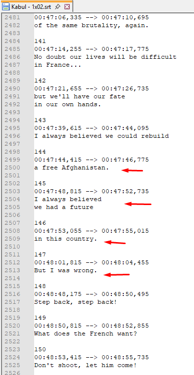

    Looking at your subs I see what happens: the missing subs come from the merge, but that has a penalty: there are parts where you have both subs generated by whisper and those merged for the same dialog.
    Example starting at 47:42:507 for E02 (timestamp with my version):
    One sub with 2 lines:
    I always believed that I
    had a future in this country.
    And then 2 subs with 2 lines and one line:
    I always believed
    we had a future
    in this country.
    That's a bit of a mess!

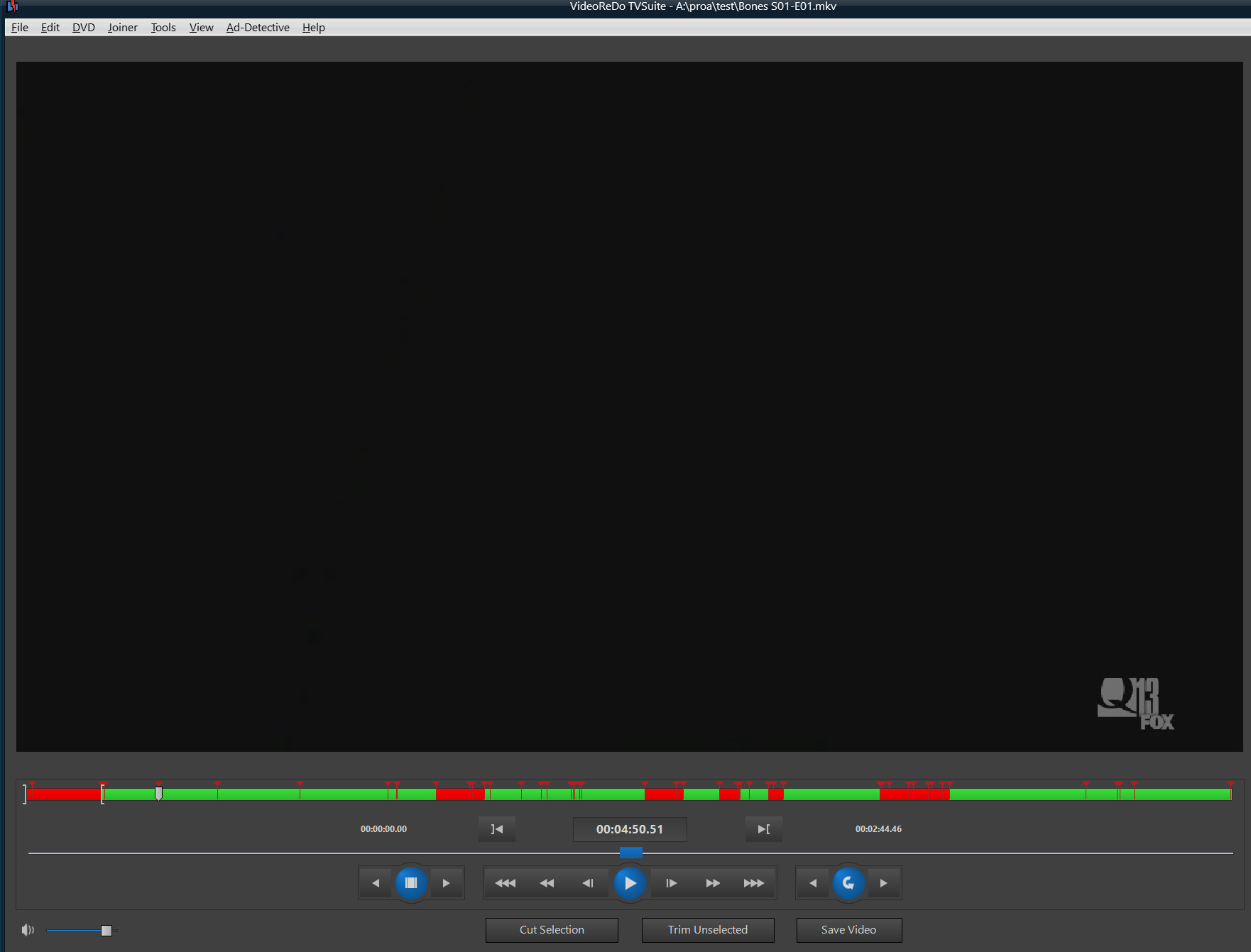

    About syncing subs.
    Most US shows are designed to have ads. These ads are generally inserted at scene changes, when the video goes dark briefly.
    2 different versions of a same show (web-dl and FOX edited to remove ads for example) will show a timing discrepancy at the scene changes.
    My process is:
    1) Use comskip, a tool to find ads, to detect scene changes to produce a VideoRedo .vprj file.
    I use:
    comskip82_010_donators\comskip.exe --threads=20 --videoredo --detectmethod=95 --verbose=0 "Bones S01-E01.mkv"
    Even if the adds have already been removed, comskip usually finds where
    2) Open the VideoRedo project. VideoRedo will clearly show where the ads where. It will show many false positions, but using F6 to navigate from one to the next shows the image, and when it's dark, it's likely where the adds were.
    Example with an old FOX show where the adds were already removed:
    [Attachment 89434 - Click to enlarge]
    Use SE to adjust at the beginning using "Set start and offset the rest". Then navigate to the next scene change that you see with VideoRedo. Check before the timestamp if it's in sync (usually it is) and there after. If it's not, sync it at this location with ""Set start and offset the rest"".
    That does not work with all the shows (not with Kabul for example that never had embedded ads anyway), but in my experience with many of them.
    Not sure if the donator version of comskip is still available. Or if it's actually needed.
    VideoRedo is no longer sold, it's hard to activate it now but I read somewhere that somebody has the rights to it now and can provide a legal way. You would need to do a search for that.
    If I get more information, I'll send you a PM.
  2. Example starting at 47:42:507 for E02 (timestamp with my version):
    I always believed
    we had a future
    in this country.

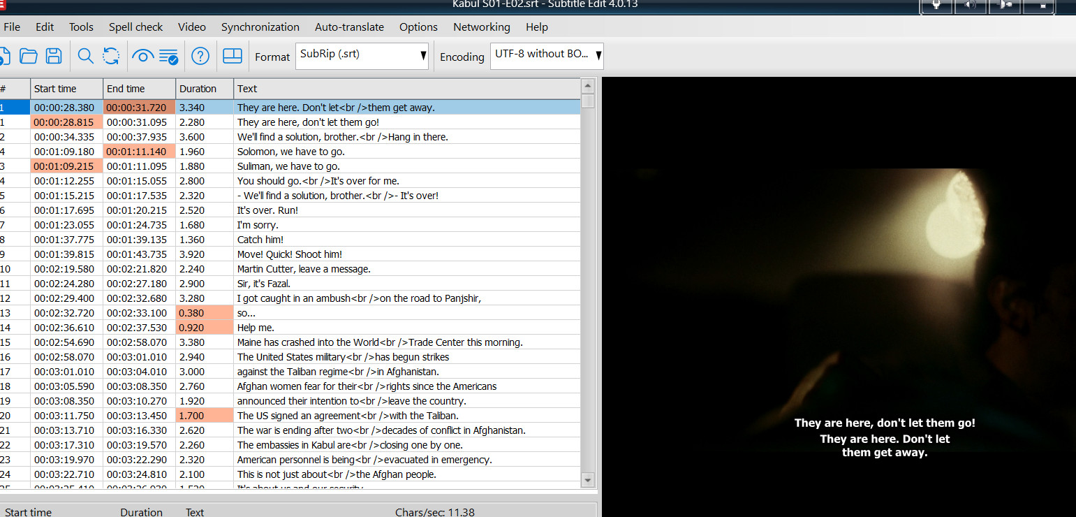

    SE engine is the culprit. No problems with CMD>CLI
    [Attachment 89439 - Click to enlarge]
    Doing the transcription again.Will update you with new subs soon.
    Meanwhile, read my PM

    But there are still subs that overlap:
    [Attachment 89446 - Click to enlarge]

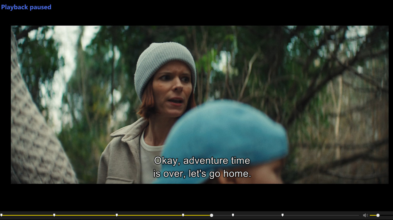

  6. No.The lines are too big to read. Update the code with
    --max_line_count 2 ^
    --max_line_width 36 ^

    I did not test Assembly yet, but for whisper, I am surprised to see the difference it makes between --max_line_width 36 and --max_line_width 40, it's not only 4 characters.
    I asked why, and got:
    --max_line_width does not mean “no line may be longer than N characters”.
    It tells Faster-Whisper the target width that the line-breaker tries to stay under while it is splitting a segment into subtitle lines.
    Because the breaker also respects sentence boundaries, words that are already > N, and minimum-line-length rules, you will still see lines that are much longer than the value you passed – especially when you raise it from 36 to 40.
    Thanks for pointing it out, I would never had thought by myself that it would make the subs that better.
