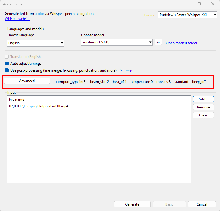

  1. Got it. BTW found the perfect way to do the subs with Purfview-Whisper-Faster XXL in SubtitleEdit.
    1. Download ffmpeg and Purfview-Whisper-Faster XXL under video > Audio to text(whisper...)
    2 In Advanced Parameters > --compute_type int8 --beam_size 2 --best_of 1 --temperature 0 --threads 8 --standard --beep_off
    [Attachment 89384 - Click to enlarge]
    Add your video file mkv/mp4 and Press Generate.
    You can refine them via SE batch (settings.xml) attached herewith

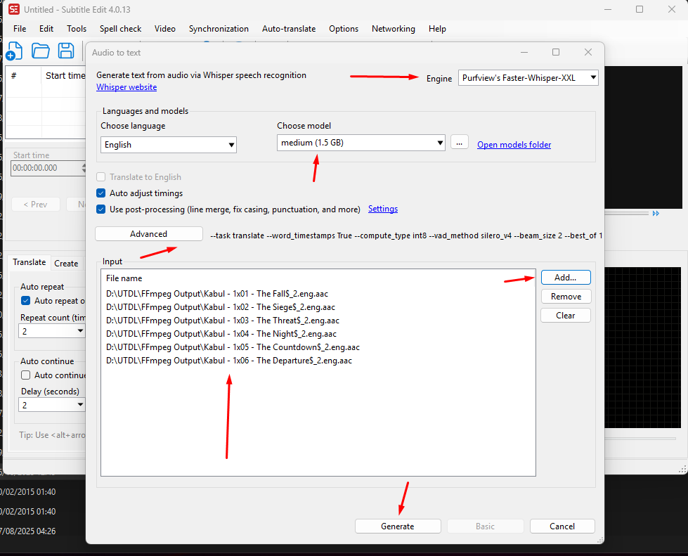

  23. Yes I have done myself. Steps...
    1. Extract the audio of all 6 episode with Clever FFmpge GUI
    1A. Add all of them is SE
    2. SE 4.0.14 - latest with model "medium" not "medium.en". Medium has all the languages.
    3. with a single command in Se "Advanced" > --task translate --word_timestamps True --compute_type int8 --vad_method silero_v4 --beam_size 2 --best_of 1 --temperature 0 --threads 8 --standard --beep_off
    [Attachment 89427 - Click to enlarge]
    Finally "batch" with SE for final touchup. Settings.xml attached herewith

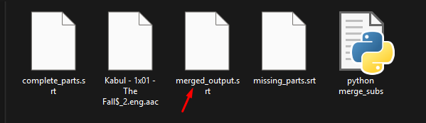

  26. Just a tiny problem. When I use your exact settings, using the same SE version, the subs I get miss a small number of dialogs compared to yours.
    Maybe because I have a different MKV version? Time stamps are not the same.
    Use a Python Script to overcome that. Steps..
    1. Get pythom 3.11.9 installed ..ignore if you already have
    2. Exract the subs that have foreign language from the video file
    3. Place the two subs (.srt) file's (A; made with Se) (B;extracted foreign language from video file) in a folder with (python merge_subs.py) script ..encl as below
    4.Rename the srt files to...
    complete_parts.srt (made with SE; having more bytes)
    missing_parts.srt (extracted one with foreign language; having less bytes)
    finally
    run > cmd > from the path ( assumed;you have assigned the path at the time installation of python)
    You will get the final merged_output.srt file filling the missed bytes that were present in the extracted forien language. Use that .srt file.
    Do use SubSync for syncing. It's too good.
    I learned to sync them manually pretty fast
    Do tell me the process to do that manually
    EDIT: enclosed the .TXT file of python merge_subs.py. Convert into the .py file at your end. open in notepad and save it as all files with python merge_subs.py (name)

    faster-whisper-xxl.exe "Kabul - 1x01 - The Fall$_2.eng.aac" ^
    --task translate ^
    --word_timestamps True ^
    --model medium ^
    --device cpu ^
    --compute_type int8 ^
    --vad_method silero_v4 ^
    --beam_size 2 ^
    --best_of 1 ^
    --temperature 0 ^
    --threads 8 ^
    --output_dir "source"
    [Attachment 89433 - Click to enlarge]
    Click the python merge_subs.py script to produce the merged_output.srt and do the final touchup with SE batch using seetings.xml
