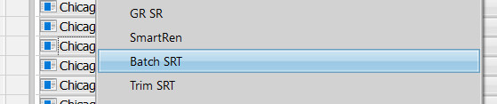

    The script is integrated to the shell, all I have to do is select several .src files, right click and use the script that is on the menu:
    [Attachment 89281 - Click to enlarge]

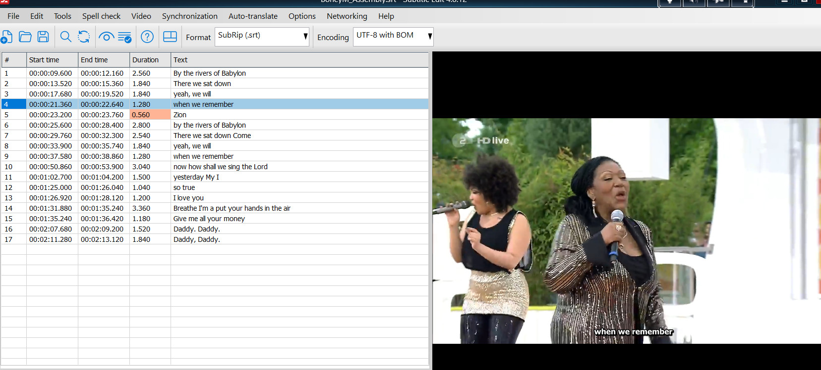

  18. @robena
    Project worked perfectly. Yes, Little bit technical. srt made needs sone bit of improvement with line spacing [The length of the lines is too long]; have to use subtitle edit to make the correction.
    Movie files working well but not working that well with music videos. Check the results here and music video here

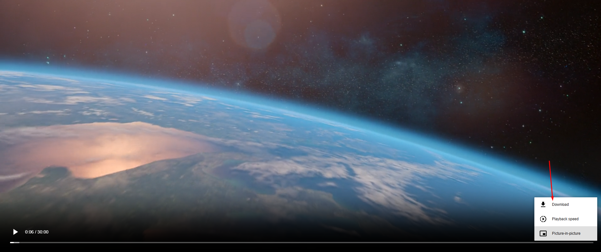

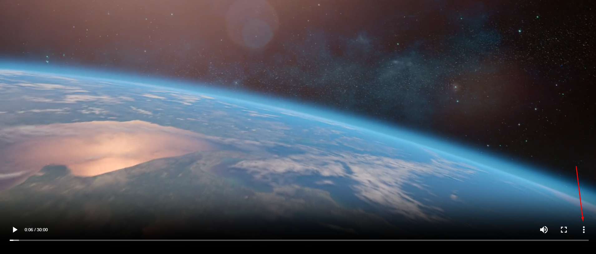

  20. @robena
    You can download them by clicking the 3 dot button on the right side below Image
    [Attachment 89346 - Click to enlarge]
    then click on download Image
    [Attachment 89347 - Click to enlarge]

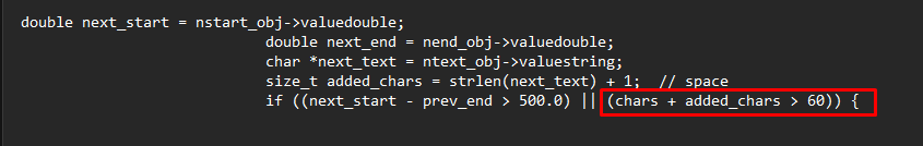

  21. does it still make lines too long after setting the length with SE?
    No with SE its fine but making with Assembly
  22. Member
    May 2008
    France
    Using an SE pass after using Assembly is not too bad.
    Maybe there is a way to customize assembly to make shorter lines, but since I'll use SE batch anyway to do that, I don't feel like wasting time.
    You could send the code used in my project to their support and ask what to do. Or ask ChatGPT!

  25. To see the best results of .srt files in movies with Assembly project. Modify characters lenght from 42 to 60 Image
    [Attachment 89356 - Click to enlarge]
    in Assembly.c and run the SE batch [4.0.13] with these settings.xml

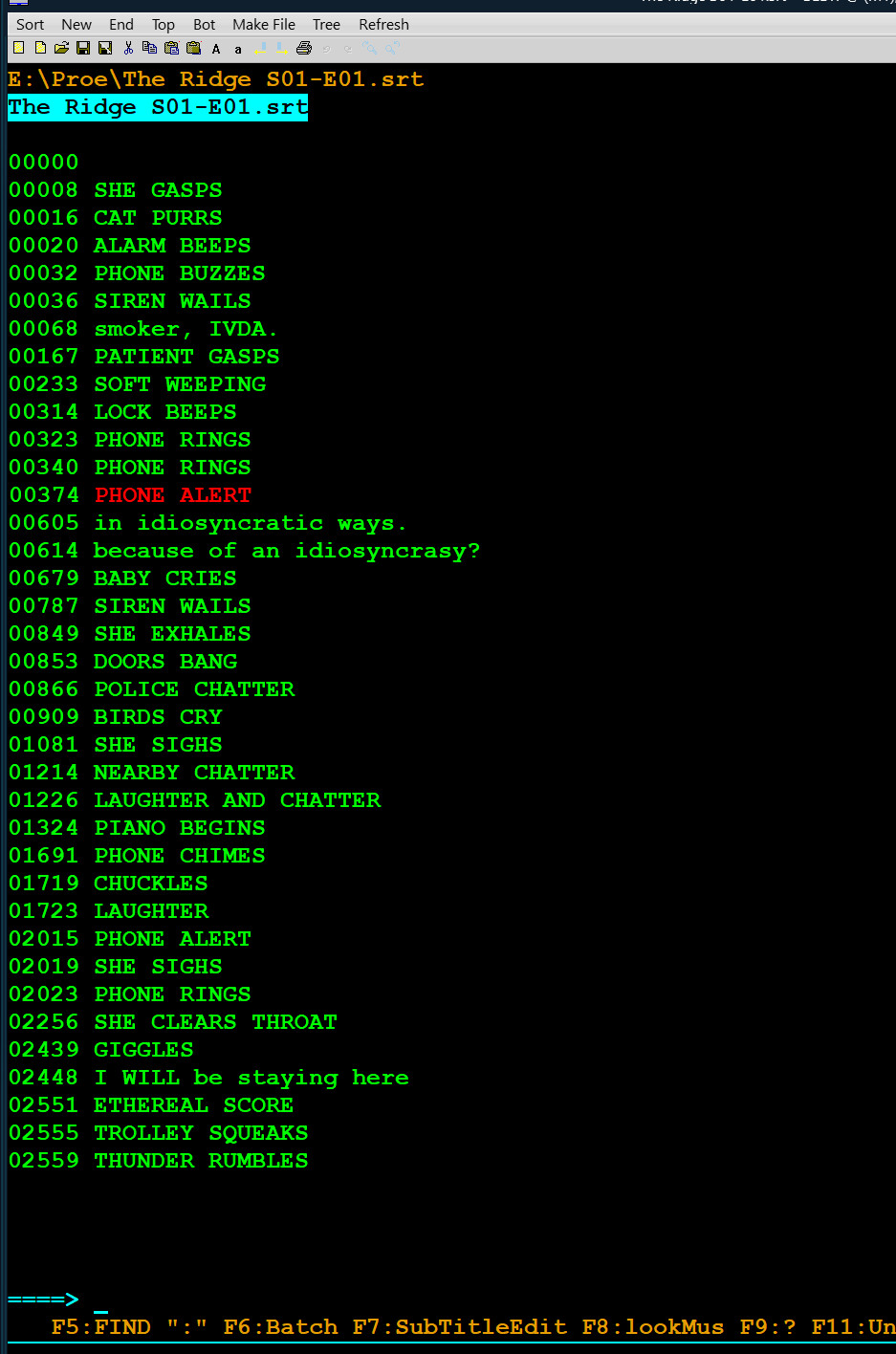

    I have a bunch of helpful macros like this one that shows all the errors the SE missed:
    signal on novalue
    option mixed setenv
    nq = arg(1)
    'all'
    'regt e'
    'case r'
    'all ~/-->'
    'all r/[A-Z]{3,}|[:\[\]\{\}\\/]/'
    r1 = rc
    'case i'
    'show/sync/|/corrected/|/ripped/|/caption/|/subtit/|/sdh/|/subtitle/|/copyright/|/translated/|/-1/|/(/|/)/'
    r2 = rc
    r0 = (r1 = 2) & (r2 = 2)
    if r0 then
      { rr = lookMus()
        if r0 & (alt.2() = 0) & nq = '' then 'exit'
    'msg'
    'top'
    return
    That's incredibly helpful to flash HI comments that are not in uppercase like "McGee: I said". It also looks for SE OCR errors on music symbols with the LookMus() macro.
    Also, it's the only way to remove HI for UK shows that don't use a ":" for comments, which subs like "The Ridge S01-E01.srt".
    If I run this macro with SEDIT (or something similar with THE, not sure what it could do exactly) after running SE on it:
    I see:
    [Attachment 89373 - Click to enlarge]

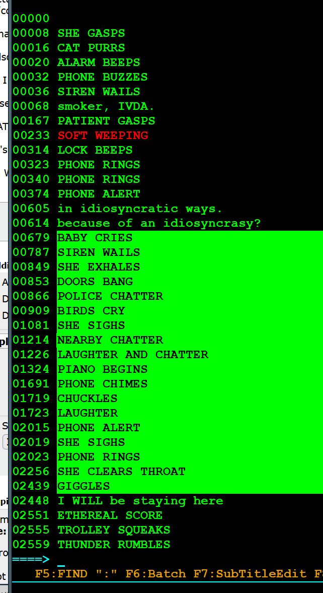

    It's easy in a glance to select and remove the HI line, but not lines like:
    "I WILL be staying here"
    [Attachment 89374 - Click to enlarge]
    The regexp shows all words in caps with more than 3 characters. It also shows lines with a ":" and plenty of stuff that you might want to remove.
    That removes lines 679, 787, etc.. but NOT the lines in between, that's the beauty of selective editing.
    I configured SEDIT so that hitting F6 saves the files, runs SE batch on it and then reloads the file. Running SE is necessary to clean the file SRT file which will have empty lines. That take .5 seconds!
    F7 does the same, but with the GUI.
    It takes maybe 10s to remove these kind of UK HI comments. Wit SE, you have to scroll hundreds or thousands of lines and do them one by one.

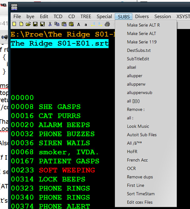

    You can customize everything, like this menu that I use for subs:
    [Attachment 89375 - Click to enlarge]

    I put this script in the shell for procesing Batch SE:
     * BatchSRT
    signal on novalue
    option setenv mixed
    address exec
    procedure
    if 0 = index($PATH, $HOME'/rcmd') then  $PATH = $PATH';'$HOME'/rcmd;'$HOME'/cmd'
    batch = '"D:\m1\VS Projects\Subtile Edit\subtitleedit-main\src\BatchProcessor\bin\Release\net48\SubtitleEditBatch.exe"'
    i = 1
    do forever
       file = arg(i, 'x')
       if file = '' then return
       if ft(file) = '.srt' then sayx batch '"'file'"'
       i = i+1
    end
    It's easy to change for Assembly to.
