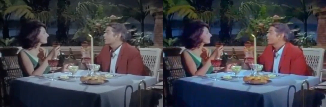

  2. For increasing the saturation in avisynth try
    tweak(sat=1.8)
Name:	New File (1)000200.jpg

  4. Thanks for the comments.
    Thanks for the "tweak" option in AviSynth+, it does seem to improve the color saturation.
    I can't get a better quality clip. This is the only clip version available that I'm aware of.
    So, it seems overall clip quality improvement is not really feasible here in this case, unfortunately(?)
