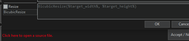

    Feb 2024
    Eastern us
    StaxRip does actually support that
