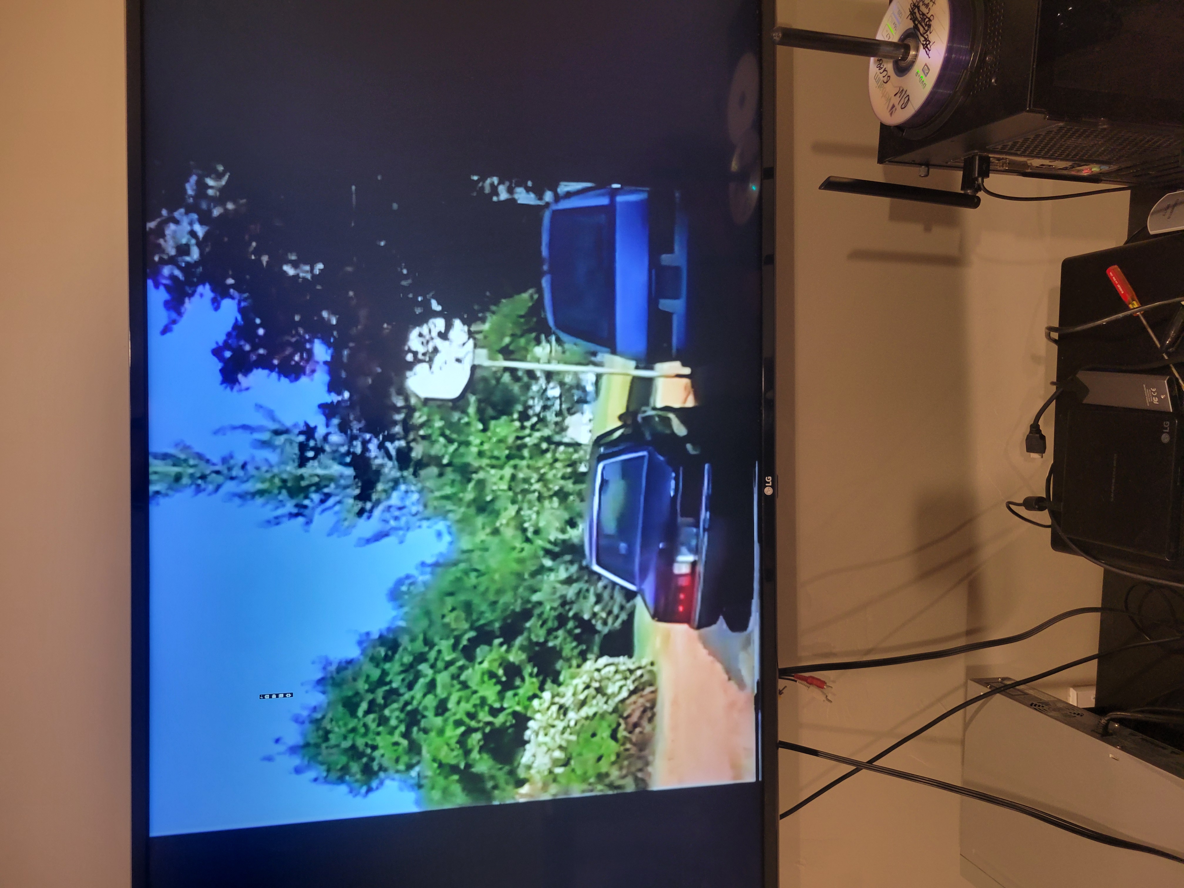

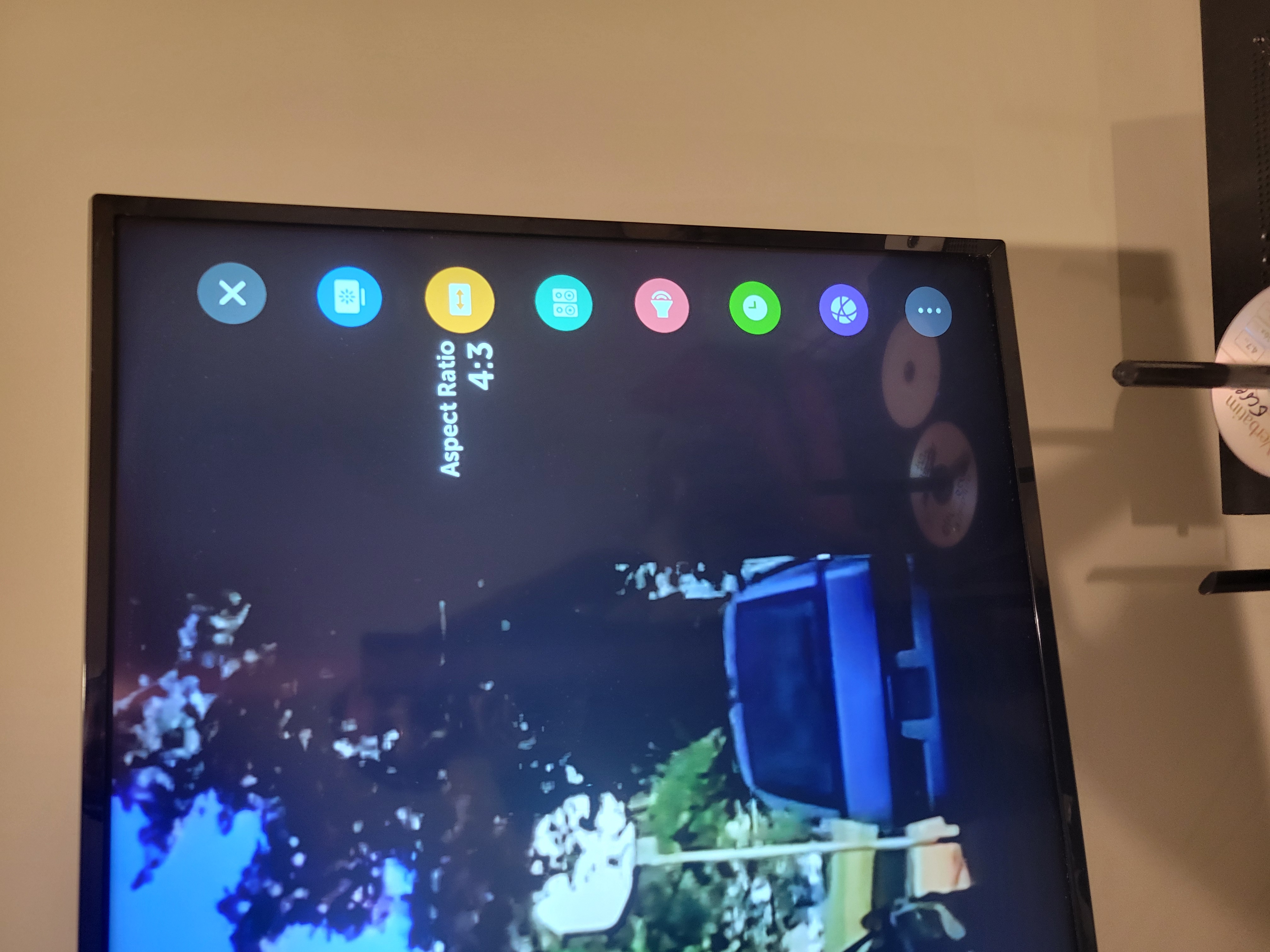

  17. I've done the method in which I took a 3:2 720 x 480p video and then adjusted the ratio to 4:3 but now theres black bars on the top and bottom. I have an LG 16:9 TV 4k resolution. It has the option to use 4:3 aspect ratio. The file that I play with 4:3 is centered on the screen and it looks too small. The 3:2 file is able to viewed on the screen with only black bars on the side which is normal since its a 16:9 display. I dont know what weird crap is going on but the 3:2 file looks better and fits better. Its something done in my process, but whoever is saying that 720 x 480 looks bad at a 3:2 aspect ratio is wrong it looks fine. I'm probably going to just upscale this because viewing this material on modern displays just looks bad. Anything lower than 1080p on any screen won't look good, but upscaling 480 to 720 via Topaz or AVC, im using AVC anyway, would just make it to look decent on 1080/4k display. TV upscaling is terrible. If I was living in the 1990s or 2000s I'd be satisfied with 720 x 480p. The AVC software automatically makes the file a 3:2 aspect ratio file along with its enhancements. So from what i've seen is that if taking this file would add more black bars, it has something to do with the softwares processing, but I see no issue in 3:2 aspect ratio even if that is not the "standard."
  18. In case anyone wants to see what it looks like on my TV. The one with the black bars on the top and bottom is the file I have playing with 720 x 480 with a 4:3 aspect ratio the one that doesn't is the one without any adjustments made taken from the AVC software at 3:2. The only difference is the actual window size of the video, whats contained in the video there are no distortions but from an aesthetic standpoint and for viewing purposes the 3:2 file looks much more normal to me and the 4:3 does not. It could simply be a software thing. I also have the picture showing the 4:3 aspect ratio on my TV and the 3:2 video file shows up fine.

    May 2005
    Australia-PAL Land
    I partly explained that way back. Your 3:2 file has the correct, 4:3 picture inside it. The side bars take your file from 4:3 to 3:2. Looks at Dellsam's images again. When you play it on your TV, you'll see no bars on the top or bottom, and black side bars, part of which are in the file itself and the rest, to the edges, is black screen from the TV.
    The reason, I surmise, that you're now getting black bars on the top and bottom is because the program is saying "I've got a 3:2 file here, he wants 4:3, so I'll pad top and bottom to achieve 4:3". IOW it won't crop the sides to achieve 4:3, it'll pad top and bottom to achieve that. I'm till thinking about it but it might distort the active video area when it does so.
    Have you actually done it or theorising? I have an LG UHD 55" SK8500 model TV and the upscaling works great.
