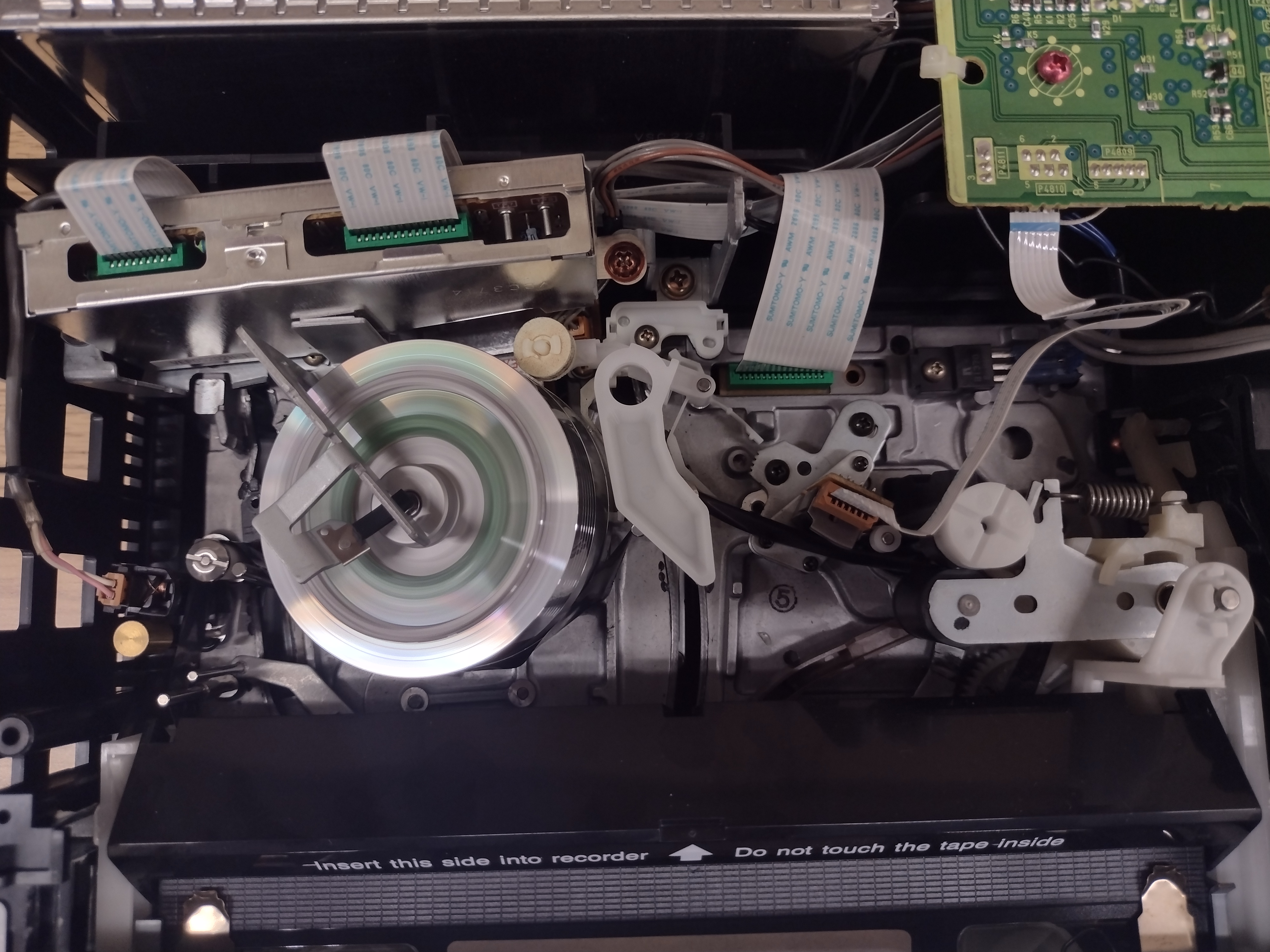

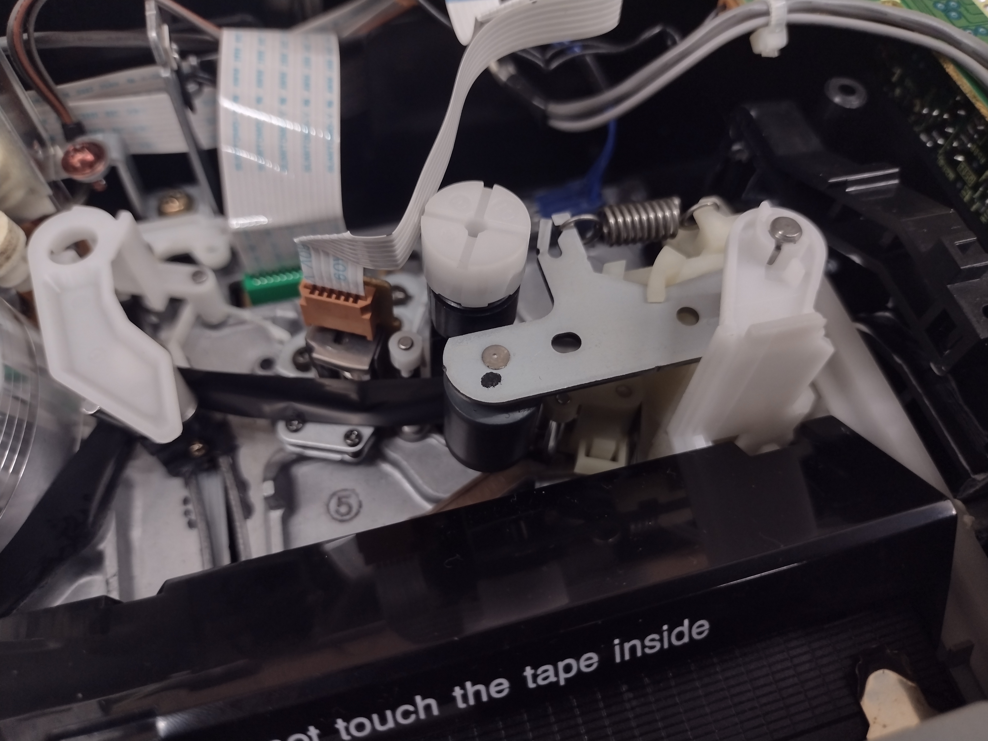

I'm new here so not sure if this is the right forum -- feel free to move my thread if its not! I found a Panasonic AG-1980 VCR that has a tape stuck in it. Unfortunately whenever I turn it on it only seems to have enough power to half thread the tape and then weakly try to eject it, achieving neither, and then turning off again. I'm not sure whether the tape inside is even threaded correctly. I work in an archive so this tape might be important (I've found no record of this machine having a tape stuck inside it in our documentation, so I don't know if people even know its there) and so I'm mostly concerned with getting the tape out safely, if that's possible. I don't think the machine is salvageable.
I've attached a few photos of the tape path, if that helps at all. I also have a copy of the service manual although it had no info on getting stuck tapes out. I unscrewed the top of the cassette carriage in the hopes that I might be able to disassemble it, but something there wasn't budging.
[Attachment 77520 - Click to enlarge]
[Attachment 77521 - Click to enlarge]
If anyone has any advice, let me know! I'm sure this issue will crop up again for me in the future haha

It's hard to describe with words but there are videos online showing how to manually extract the tape from the deck by manually turning the loading motor by hand or applying a 5V to it. TG grant at one point had instructions on how to remove a stuck tape.
Maybe something useful here?
https://www.digitalfaq.com/forum/vcr-repair/10617-panasonic-ag-1980-a.html -
Thanks y'all for the tips! I managed to get the tape out. Now the tricky part will be figuring out where the tape belongs...
