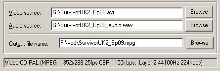

If I understand your question then the answer is actually pretty simple.
TMPGEnc has a Video Source and Audio Source
if you specify the Video Source as your DivX and nothing as your Audio Source then you will be creating a VCD with nothing as it's audio track (the audio track will be there it will just be silent). The best method is always to convert the source audio to wav first then put it in separately (as you see in my example above).
Video Source: SurvivorUK2_Ep09.avi
Audio Source: SurvivorUK2_Ep_audio.wav
the audio is the source I converted the video is the original DivX - the exported WAV file
as for adding the borders via VirtualDub - I used to use that method to preserve the 320x240 source resolution but it's the same thing as doing "Center (Keep Aspect Ratio)" ... but if your suggesting you resize the full file from 320x240 to 352x240 then you missed the point of my post. You can resize it easily in VirtualDub or by setting TMPGEnc to "Full Screen (Keep Aspect Ratio)" but it has been my experience (and the catalyst for this guide) that doing that makes these low bitrate, already blocky DivX files, much worse and it's preferable to not force your MPEG encoder to do any upward resizing.
Resizing is usually very successful if your source is large than your desired output - but if your starting with source that is smaller than your desired output the results aren't usually that successful in maintaining or improving the quality. The opposite is usually the case.
I hope that helps.your pal,
Stinky -
