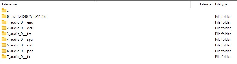

  1. Hi everyone. I'm running N_m3u8DL-RE in a Linux server via command line with following code:
    N_m3u8DL-RE ".m3u8" --save-name 2024 Bahrain Grand Prix - Practice 2 -sv best -sa all
    I get the best video and all audio files in separate folders.
    This is main folder created.
    [Attachment 77446 - Click to enlarge]
    Then if I go inside the folder created I can see more folders for video and audios separated.
    [Attachment 77447 - Click to enlarge]

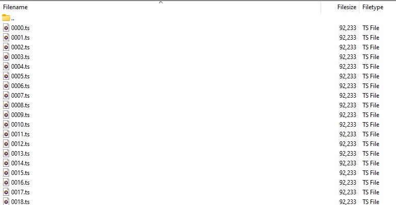

    Inside Video and Audio folders I find a lot of files with extension .ts
    [Attachment 77448 - Click to enlarge]
    It's supposed N_m3u8DL-R should assign extension .mp4 for video and .m4a for audios?
    Why am I getting files this way separated in folders?
    Hopefully someone can help here. Thanks.

  7. it's not weird. your command on first post download from m3u8, save video with name, best video and all audio files
    missing command to join audio/video files, like white_snake says, with live-pipe-mux (for live) or mkv format for simply VOD

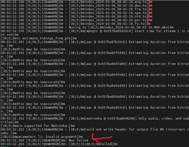

  8. As suggested I added this at the end of my code.
    -M format=mkv
    It didn't work. Mux process failed. Please refer to screenshot.
    [Attachment 77457 - Click to enlarge]
    As I can see, mux process fails because audio extension is ".ts" and video as well.
    It should be ".m4a" for audio since it's "aac" audio and ".mp4" for the video.
    Weird all files are downloaded as .ts
    FYI... If I use "ffmpeg" to download and merge files it just works as expect. I'm trying to use N_m3u8DL-RE since download speed is way faster.
