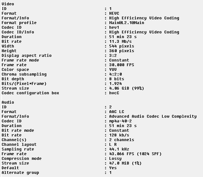

    Source video details as per MediaInfo -
    [Attachment 77428 - Click to enlarge]

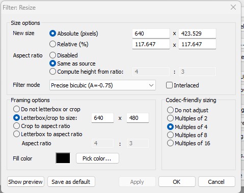

    Resize filter:
    [Attachment 77478 - Click to enlarge]

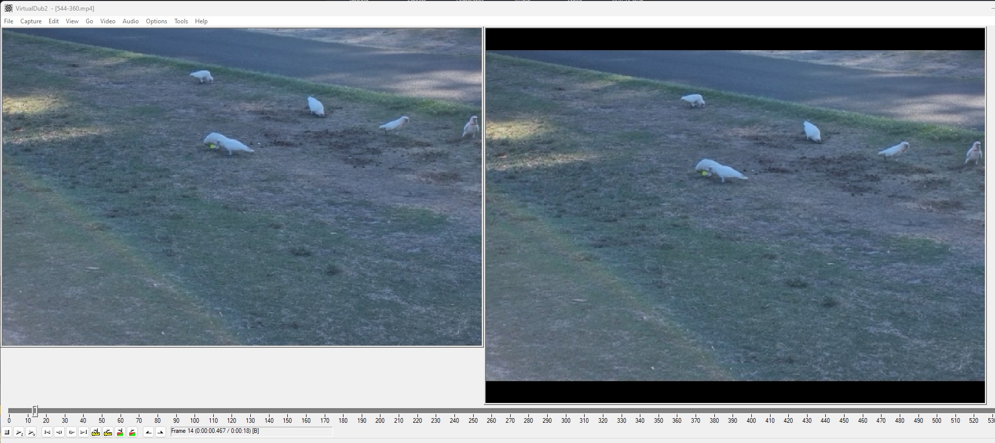

    Result:
    [Attachment 77479 - Click to enlarge]

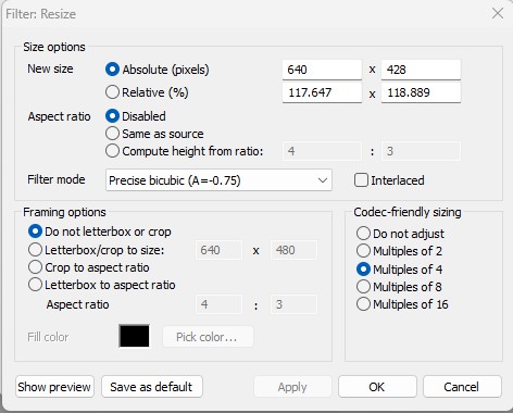

    If you want to keep the 3:2 (1.5:1) ratio of the original file, tick "Disable" then type 640 and 428 into the "Absolute" values. Then tick "Do not letterbox or crop" like this:
    [Attachment 77480 - Click to enlarge]
    Thank you for the detailed reply!
    I didn't see a "resize" filter within my Virtualdub2 x64 plugins folder. So I assumed a filter had to be added/imported into this directory in order to perform a resize function!?
    But on opening a test video within Virtualdub2 and then selecting Filters under the Video tab, there were no filters listed within the filters message box. Then I realized you have to "Add" filters to this filters box. On adding filters, I found and added the resize filter and made appropriate adjustments to the settings within the resize filter, and am now doing test runs to see how the processed video turns out.
    Yes, thanks. I was aware that the aspect ratios were different between the source and wanted target videos; I made allowance for that in the filter settings.

  10. The Display Aspect Ratio is 3:2 as shown by MediaInfo screenshot in my first post.

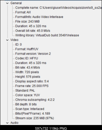

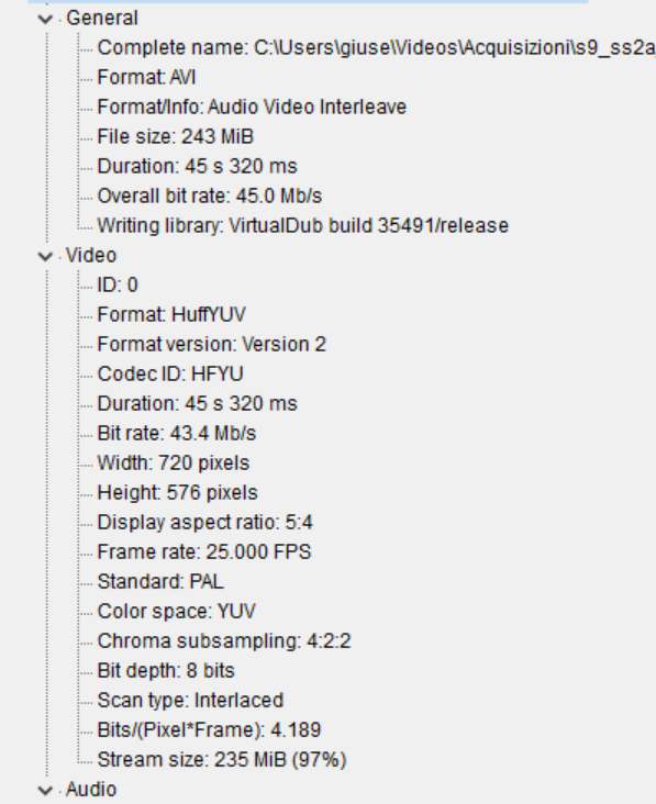

    Mediainfo is just a tag reader. When the real DAR is not specified, it writes in the field "Display aspect ratio" the PWH, as in the case of avi derived from an Analog Capture.
    But Alwyn is right, probably the "deep" aspects are not worthy here
