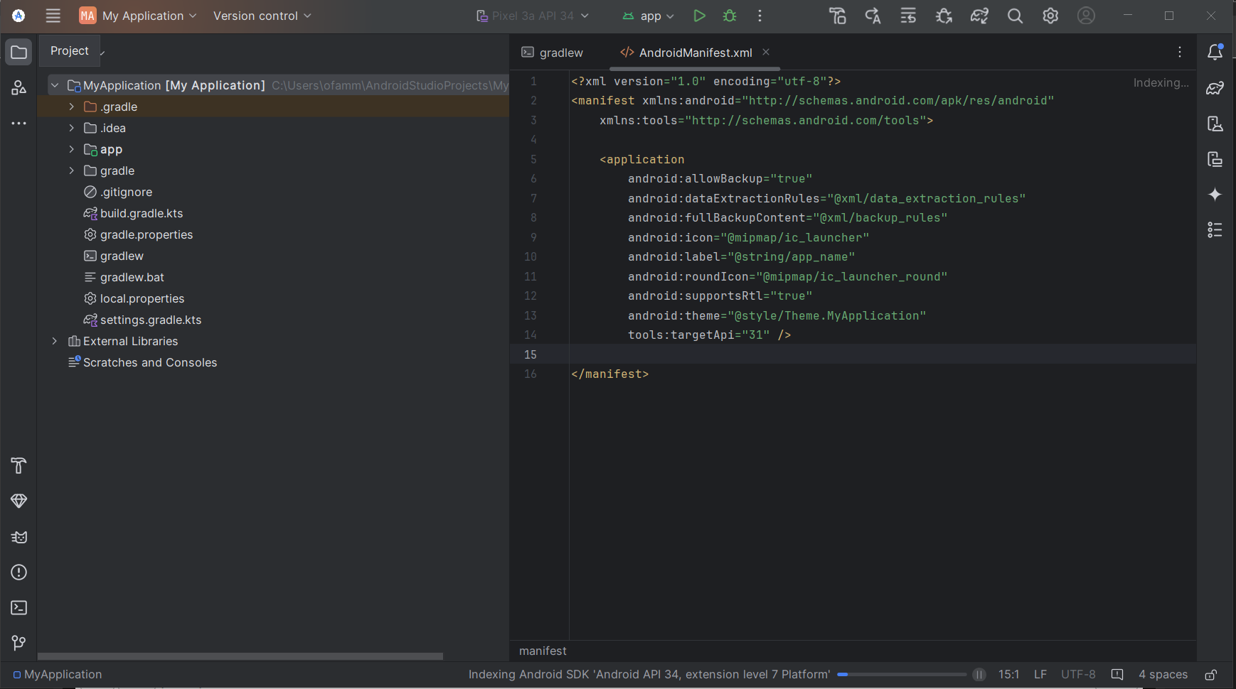

This is what appears after installation of the application.....it is totally different from the first image in the instructions. I've been trying to use CDRM but there are no clear instructions on what to do. What I would need is a step by step example, a video even, using the fifa site. I am not a coder, this is way too complicated.
Results 31 to 60 of 86
Where is the 'Main Activity' part from the first image in the instructions? It doesn't appear on mine after installation.

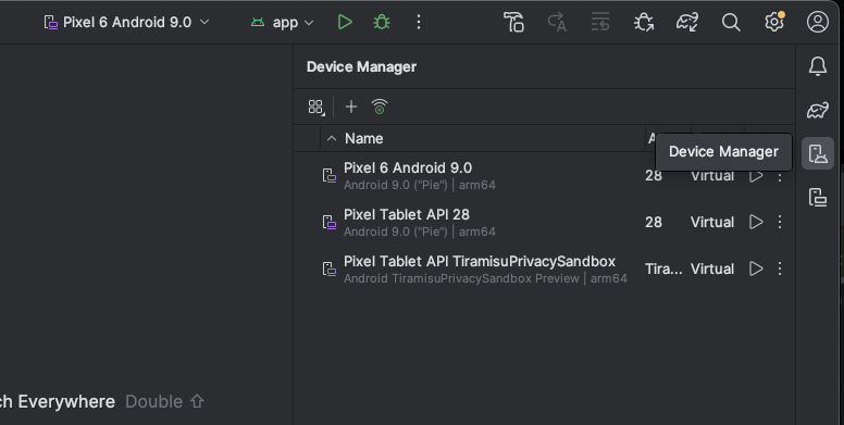

Clic on device manager at the right.
