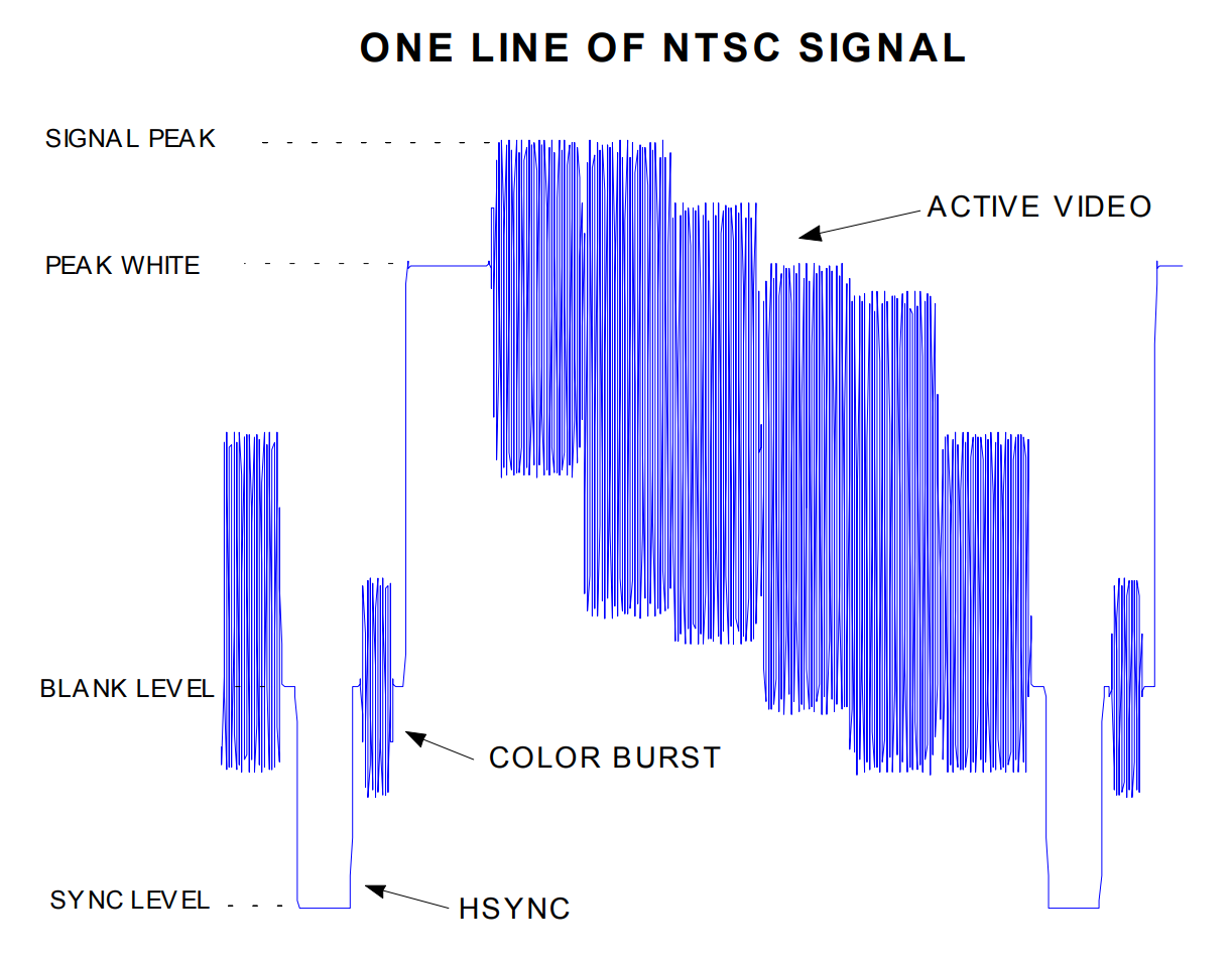

    The pictures show one full scanline plus the next sync pulse indicating the start of the next scanline.
    Thanks, @Sharc. These pictures clearly show that Panasonic's "VCR Refresh Copying" is not empty advertising.
    Originally Posted by Panasonic 2006 DVD recorder booklet
    Time Base Corrector (TBC) + 3D Digital Noise Reduction (DNR)
    When connecting a VCR and DIGA to record VHS videotape images onto a DVD disc, the Time Base Corrector helps reduce jitter and performs signal conversion to create a stable signal. At the same time, 3D DNR detects and virtually eliminates randomly generated noise and color irregularities to help minimise flicker. Thanks to these two technologies, the tape input signal is automatically detected and optimum processing is performed to provide an easy way to even more beautiful digital recordings.
    A handy picture from Digital Processing of Analog Television by Lior Zimet.
