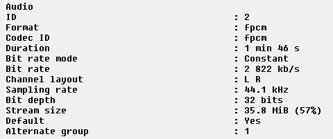

Here are the screenshots of the two different audio parts of the video clips as scanned by using MediaInfo.
For most of the video clips -

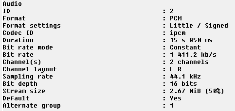

For the few other video clips -

I've had a look at the "problem" clips with the different audio codecs as well as the principal clips audio codecs.
The 'problem' clips were cut from the original video using Virtualdub2 and saved in lossless compression avi format. Audio codec used was pcm_f32le format. These cut clips were then processed again via Virtualdub2 and AviSynth to remove noise (using SMDegrain) and the resulting post processed clips were saved again in lossless compression avi format. But now the audio codec has changed to pcm_s16le for some reason!?
The principle clips were cut from the original video again using Virtualdub2 and again saved in lossless compression avi format. Audio codec used was again pcm_f32le format. Further processing on these principle clips was carried out by other (semi)professional software and the audio codec used remained as pcm_f32le. So no issue here.
So the different audio codec issue appears to be with the AviSynth degraining process and for some reason saving the processed clips with audio pcm_s16le codec instead of retaining the pcm_f32le codec!?

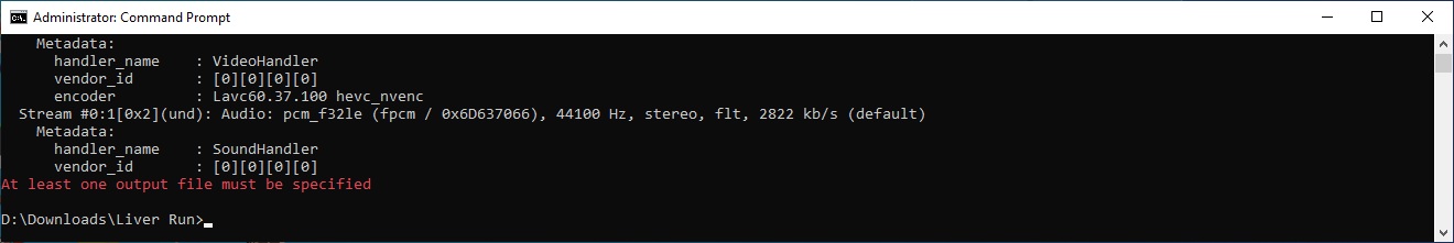

But I ran ffmpeg -i on a sample clip with pcm_f32le with the following result -
[Attachment 77392 - Click to enlarge] -
After a lot of trial and error, I finally managed to get the audio corrected on the suspect video clips by typing in a command window -
So the suspect clips now are all audio encoded with pcm_f32le to match the pcm_f32le for the remaining clips!Code:ffmpeg -i test.mp4 -c:v copy -c:a pcm_f32le test_corrected.mp4
