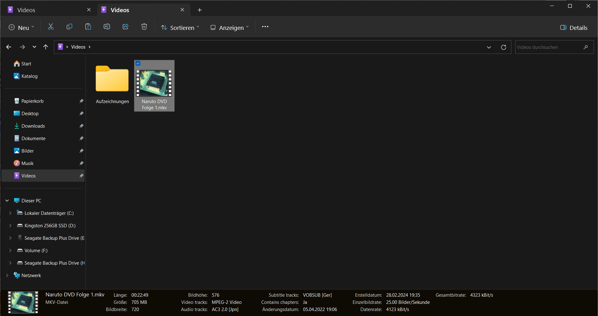

  6. Ok, i found "icaros", which can provide more additional information. I don't know, how it does that. Otherwise i would implement mediainfo-information, because mediainfo still provides a LOT more information.
    Anyway: With icaros you can show some more Information, but it shows rating (this stuff, where you can rate a file by "stars"), which i always deactivate. So i created a .reg file for 15 file types, which does use icaros settings + deactivates the rating, which looks like that (when using OldNewExplorer):
    If someone is interested in the .reg-file its also uploaded here (if you don't trust, open with editor and check). I'm not sure, if it is only working, when you use icaros, because the settings contains "icaros" in the name, when you check the single entrys. I copied that out as it is and only deactivated the rating-entry. Did it "only" for 15 file-extensions, which i mostly would use/see.
