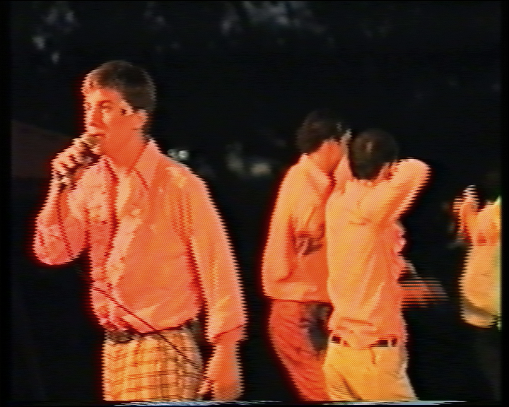

    Hello all, could somebody point me in the right direction, using AVISynth, to remove these orange waves across the guy's body.
    When I deinterlaced it with QTGMC (basic mode) I got bad crosshatching in the red/orange portions and the across-wave was still there.

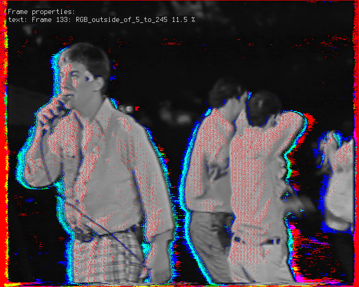

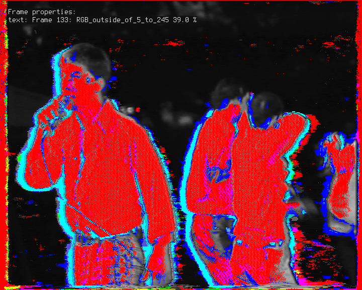

  8. I just post some visuals, sorry for polluting , but visuals help,
    posting illegal RGB's below 5 and above 245,
    note, after de-saturation, there is plenty of really low RGB values as well
