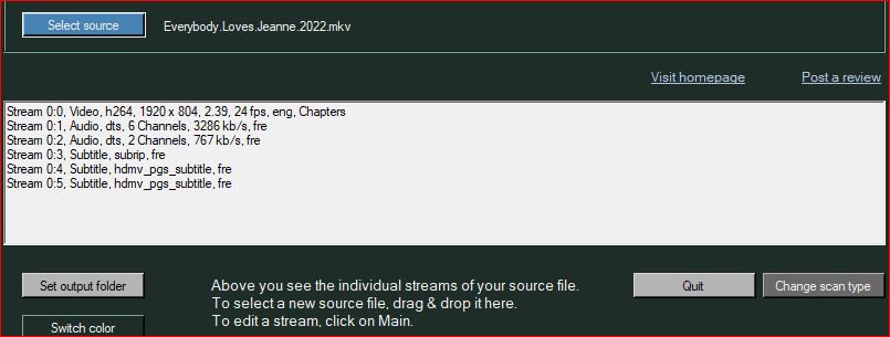

    Thanks for the quick reply.
    I see two dts audios in the source file info display:-
    Stream 0:1, Audio, dts, 6 Channels, 3286 kb/s, fre
    Stream 0:2, Audio, dts, 2 Channels, 767 kb/s, fre
    If I go to Audio option on Main page, under the Encode category I see Audio Stream option, then going there I have a Select Stream box in which I choose number 1 or 2. All this seems to do is change the dts value in the adjacent 'info' box from 3286kb/s (option 1) to 767kb/s (option 2).
    Or do I go to the Multiplex page and deselect the checked audio boxes on the left and then ...?
    Thanks for assistance.

  4. 1) load your file
    2) click main
    3) click encode audio stream
    4) select 2 (the dts 2channels)
    5) click encoder
    6) select ac3 (or aac) and click encode.
    7) click multiplex, deselect the two dts streams on the left and click multiplex.
    Done.
