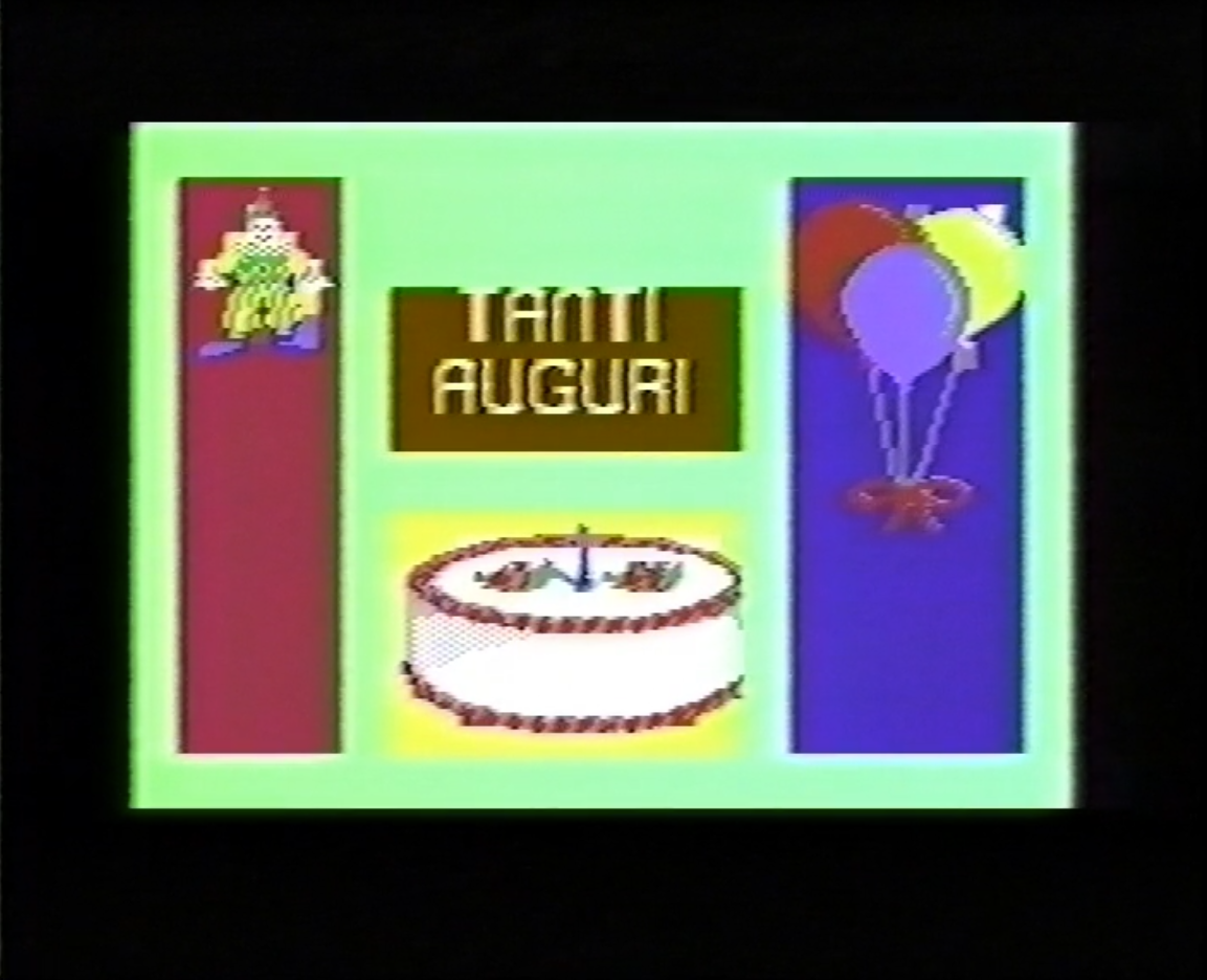

    I have this VHS PAL tape that has these wobbly horizontal lines from top to bottom throughout the video. See the attached sample.
    The VCR player is LG V782W. It plays other VHS tapes fine. I'm capturing with I-O Data GV-USB2.
    Please help me diagnose what are the possible issues and solutions for this.

  2. Did you connect via S-Video?
    As a budget solution use a recommended DVD recorder in passthrough to stabilize the picture. Search the forum.
    https://forum.videohelp.com/threads/403635-Panasonic-DVD-recorder-passthrough-settings...15-DMR-ES25%29
    Or use a VCR with TBC.
    As you say it happens with this tape only, maybe it is like this baked into the source. Do other captured tapes look ok?. Not much you can do then.
  3. Originally Posted by Sharc View Post
    My other tapes are captured fine.
    My VCR doesn't have S-Video for VSH, it's only exclusive for DVD. Is S-Video available on SVHS players only?
  4. Originally Posted by FillPatron View Post
    Usually yes. You could convert Composite to S-Video (and possibly stabilize the wiggling) by means of a DVD recorder in passthrough. Up to you if the tape is worth the efforts.

    Maybe the the video on this tape is recorded in longplay ? like said, use another vcr to get better results,(only composite is available for VHS for this VCR model) also because your capture device does well with other tapes... passthrough might help, but the other tapes don't need this, you see the same defect also "live" with playback on your screen ? then it could be in the recording it self, and then you're stuck with it in that case, so it depends...

    Yes, that's also something to try, for a moment i also thought i saw the interferrence in the picture going in the same pace as the sound levels, not sure about that though… also at the start my player had some difficulty playing the clip and gave a freeze frame, for a couple of seconds, that normally doesn't happen with any clip, my guess is that the compression did not do a great job.

  13. I've got the Panasonic DMR -EH50 today. Simply connect the VCR player to it, then to the USB recorder, and it works like magic! The wobbly lines are corrected throughout the video.
    I've recorded the tape and am very happy with the result. Thank you all!
