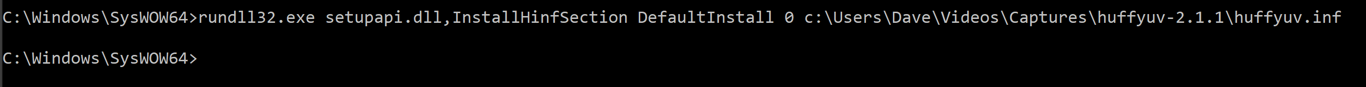

    When I try this command (as admin)
    C:\Windows\SysWOW64>rundll32.exe setupapi.dll,InstallHinfSection DefaultInstall 0 c:\Users\Dave\Videos\Captures\huffyuv-2.1.1\huffyuv.inf
    [Attachment 77249 - Click to enlarge]
    I can see the codec in Vdub2 (64 bit), and I get the error in AvsPmod 64 bit.

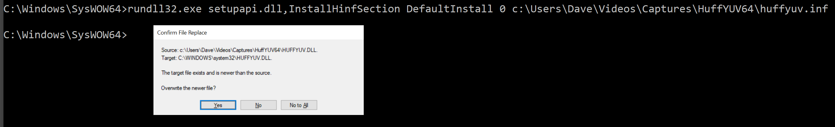

    If I try the 64 bit, it complains that the file is older, so it's installing to the same place...
    [Attachment 77250 - Click to enlarge]
    The codec still shows in Vdub2 and I still get the error in AvsPmod
