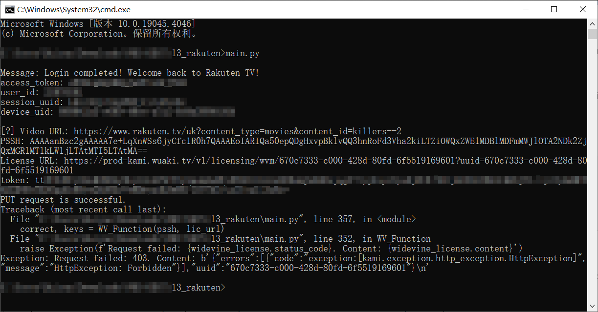

    Hey guys,
    just read about another post discussing Rakuten Spain.
    Yesterday just finished investigating another site mytvsuper[.]com in Hong Kong. Honestly that's totally sick......
    So I thought maybe try Rakuten TV...
    I made some tests on the UK site (rakuten.tv/uk), but now am facing this 403 Forbidden problem.
    URL:
    https://www.rakuten.tv/uk/movies/killers--2
    Type: Free movies (Free registration, Geo-restricted)
    From what I have found,
    After we have sent a POST request towards "https://gizmo.rakuten.tv/v3/avod/streamings",
    uuid is in the response, and so does the mpd URL, License URL...
    The format of the License URL is:
    https://prod-kami.wuaki.tv/v1/licensing/wvm/{UUID}?uuid={UUID}
    But that's the problem.
    I used the uuid that the server gave me to conduct another POST request,
    it gave me a 403 error.
    {"errors":[{"code":"exception:[kami.exception.http_exception.HttpException]","message":"HttpException: Forbidden"}],"uuid":"670c7333-c000-428d-80fd-6f5519169601"}
    I got no idea now.
    Does Rakuten TV restricts emulator CDMs? I doubt that.
    And indeed, open the Android Studio and stream the same video on your emulator and then use Fiddler to catch the uuid is also a solution, but... not the best solution right...?
    I can provide the credentials although registration is quick and free. And also remote desktop sharing is workable.
    Thanks.
    Below is the screenshot of the cmd window. I wrote a custom script to try to catch all the necessary data.
    I just pasted the account and password into the script beforhand, and then input the Video URL (with a question mark there "[?]"). All the other data were got from the responses so that means not generated manually.
    [Attachment 77216 - Click to enlarge]

    From what I've seen that uuid is generated using a POST to another request. And the json of that post request contains the element "device_uuid". There may be a conflict happening.
  3. You need to request the license URL from an Android device, either by debugging the traffic from an actual device or by writing a script that uses Android as identifier to access their API. There are no restrictions for the CDM.

    Maybe just changing the User-Agent won't work. I'll try "fiddler"ing the data from my Pixel tomorrow.
  5. Originally Posted by CrymanChen View Post
    It shouldn't because site will not load the video at all, and will instead tell you to download the app for mobile.
  6. Banned
    Apr 2022
    Hong Kong
    Ahh, that makes sense. I'll try downloading their mobile App.
    (Since last time I saw a notice like "you can't watch this video from linux/... devices")
  7. Banned
    Apr 2022
    Hong Kong
    Thank you guys, problem solved.
    Indeed on Android is much different from that on Windows.
