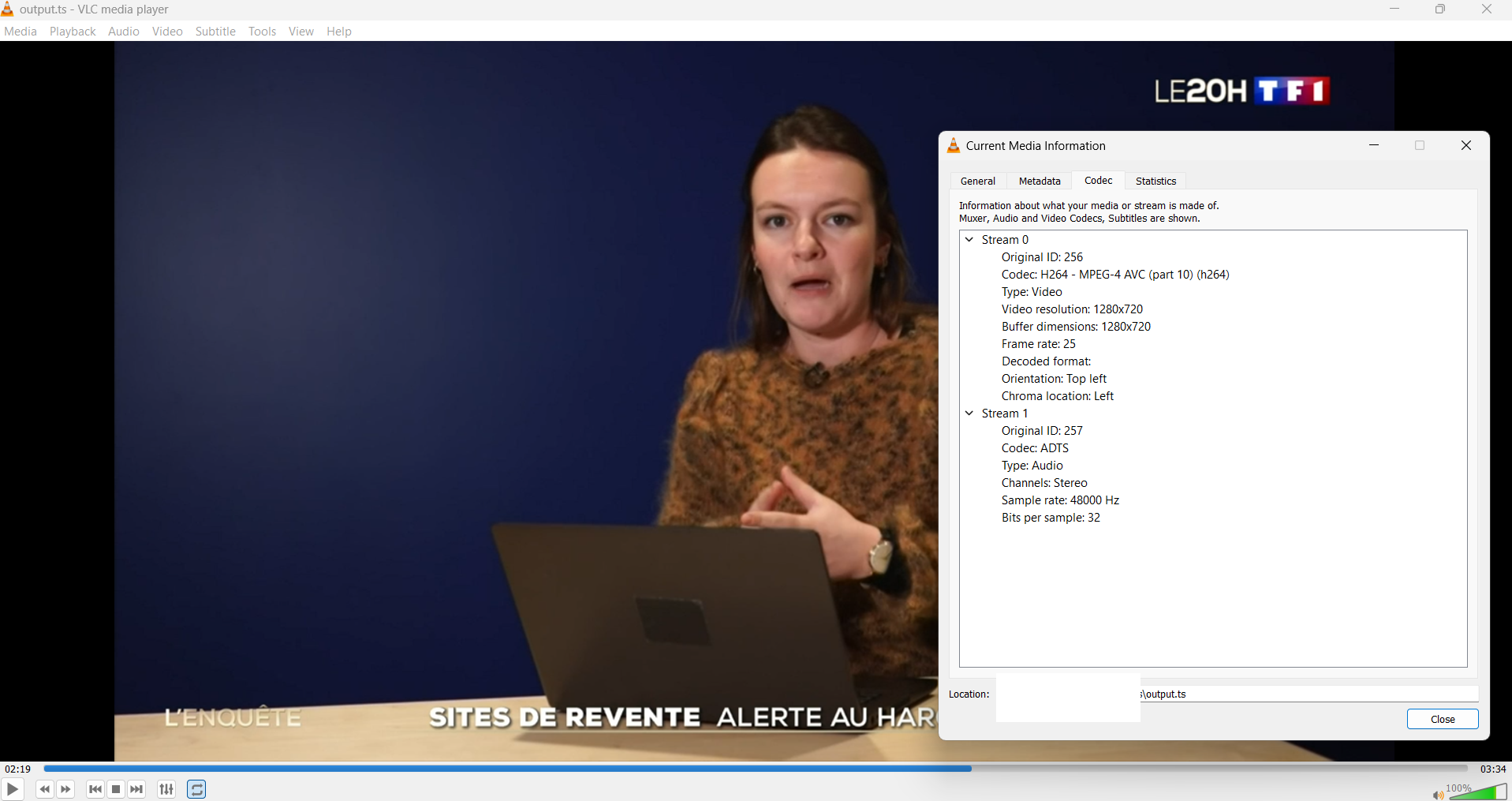

    Originally Posted by WazaKrash View Post
    Idk why but it didn't worked (I got some error red message), I didn't have enough time to see why but thanks a lot for helping me. Problem was probably from my side
    Serves me right for not reading what I write. That URL is tied to my session. Nonetheless this can be fixed by simply grabbing the current mpd link and in theory it should work for any other link from that site - https://www.tf1info.fr
    Curl bash only:
    curl -s "https://www.tf1info.fr/justice-faits-divers/video-tf1-c-est-degradant-sur-vinted-et-leboncoin-de-plus-en-plus-d-utilisatrices-victimes-de-harcelement-sexuel-2286233.html" \
    | grep -oE '"video_id":"[^"]+"' \
    | sed 's/"video_id":"\([^"]\+\)"/\1/' \
    | xargs -I {} curl -s "https://mediainfo.tf1.fr/mediainfocombo/{}" \
    | grep -oE '"delivery":{[^}]*}' \
    | grep -oE '"url":"[^"]+"' \
    | sed 's/"url":"\([^"]\+\)"/\1/' \
    | xargs -I {} ./ffmpeg.exe -i "{}" -c copy "output.ts"
    Make sure you have ffmpeg.exe in the same directory you run that command.
    [Attachment 77211 - Click to enlarge]
