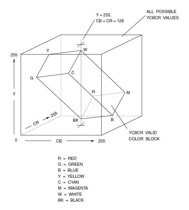

  1. Why I keep mentioning rgb is because color grading in NLE or applying LUT is in RGB anyway, so you do not avoid it anyway. To keep everything in YUV using your plugins and way of things is not possible.
    Guys are fixing videos in scripts, possibly all the way in YUV, but as soon you involve color grading NLE, you use RGB. If not, then you'd have to use NLE that fixes colors and such in YUV but it all changes for you, not sure with what result.
  2. Originally Posted by lollo View Post
    .... If you want to go to your preferred editor Vegas, you can avoid the "illegal" YUV values (while in AviSynth) adjusting the input levels to stay in the range 16-235, to avoid clipping. This is the most important thing to fix.
    Most important fix and as a rule of thumb yes, but for strict legalization it is not sufficient to just keep the luma (and chroma) within their legal range. For example YUV(230,109,212) would still produce an out-of-gamut (clipped) RED channel.
    Yes Sharc, we know, but the OP is already confused with basic stuff, no need (now) to complicate his life, I think. Maybe later
  4. Originally Posted by lollo View Post
    It was a hint to those who don't know . It's in the context of the discussed YUV->RGB conversion issues. No intention to open another can of worms
