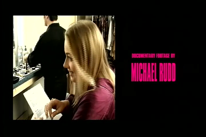

  1. The credit footage of a film I'm encoding has larger interlacing? The rest of the film is interlaced but I can't figure out what's happening with this weird combing. What causes this?
Name:	large interlacing.png
  2. Vertical resizing without deinterlacing before resizing destroyed the original interlaced structure.
  3. Originally Posted by Sharc View Post
    That makes sense. This is irrepairable correct?
  4. Originally Posted by LaserBones View Post
    The damage is there. Often irreparable yes, unless one knows how it has been resized and no other processing has been applied on top.
    Some mitigation is possible (typically a trial and error process). There are posts in this forum and at doom9. Maybe someone with more experience will chime in.
  5. basic idea to undo this is to:
    a. downscale to original resolution
    b. deinterlace
    c. try to lessen ghosting caused by the whole process (using exblend, spotless, FixBlendIVTC, cdblend,..)
    so i would say one can lessen this somewhat, but it is irrepairable on natural content. (on simple anime/cartoon content lessing of this is easier)
    lessen: yes
    get near the original quality, before the messup: not really
    Cu Selur
