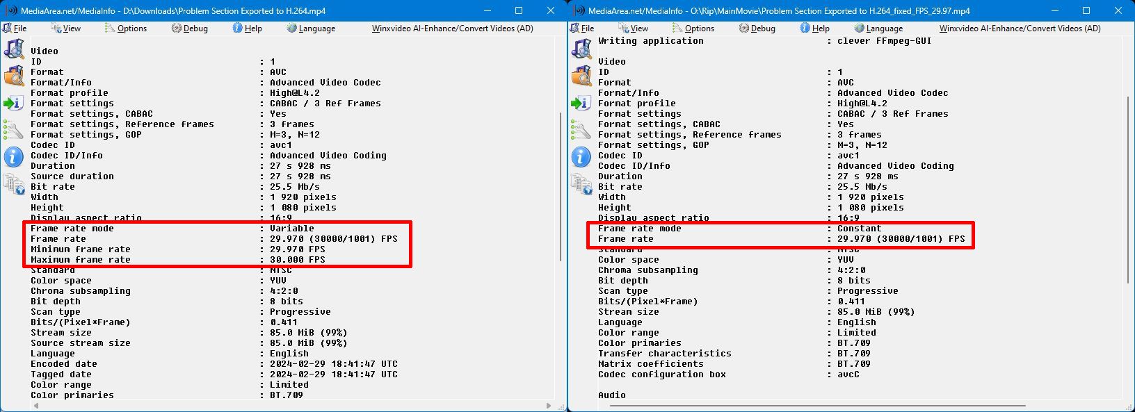

  1. The AVI is coming next, I live in a small town with no fibre optics, so only 1 mb upload speed.
  2. Here's a section of AVI that contains the problem parts
  3. Here's an export from a clean section of another problematic AVI file, to H264, which shows a constant frame rate in MediaInfo.
  4. Please keep in mind that my goal is not to simply modify the headers to convince MediaInfo that the exported H264 video has a constant frame rate. I am looking for a way to repair the AVI file structure so that the exports to H264 result in constant framerate, without compromising the AVI video quality. Thank you for helping me, I very much appreciate your time.

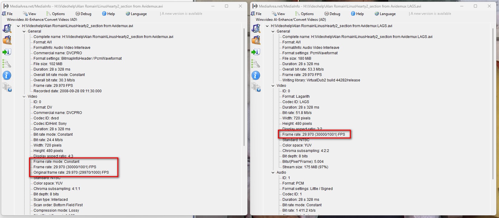

    I saved it as a LAGS AVI and the FrameRate information in Mediainfo changed:
    [Attachment 77364 - Click to enlarge]

    Use clever FFmpeg-GUI to fix it.
    Used your Problem Section Exported to H.264.mp4.
    See the result.
    [Attachment 77368 - Click to enlarge]

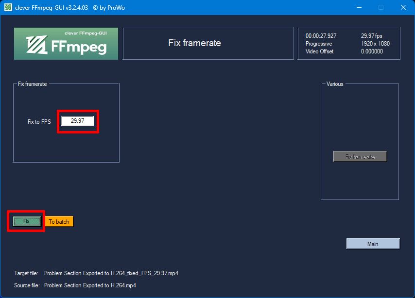

    How to use:
    Load your mp4, click main, click various.
    The framerate should be detected automatically.
    Click Fix. Done.
    [Attachment 77369 - Click to enlarge]

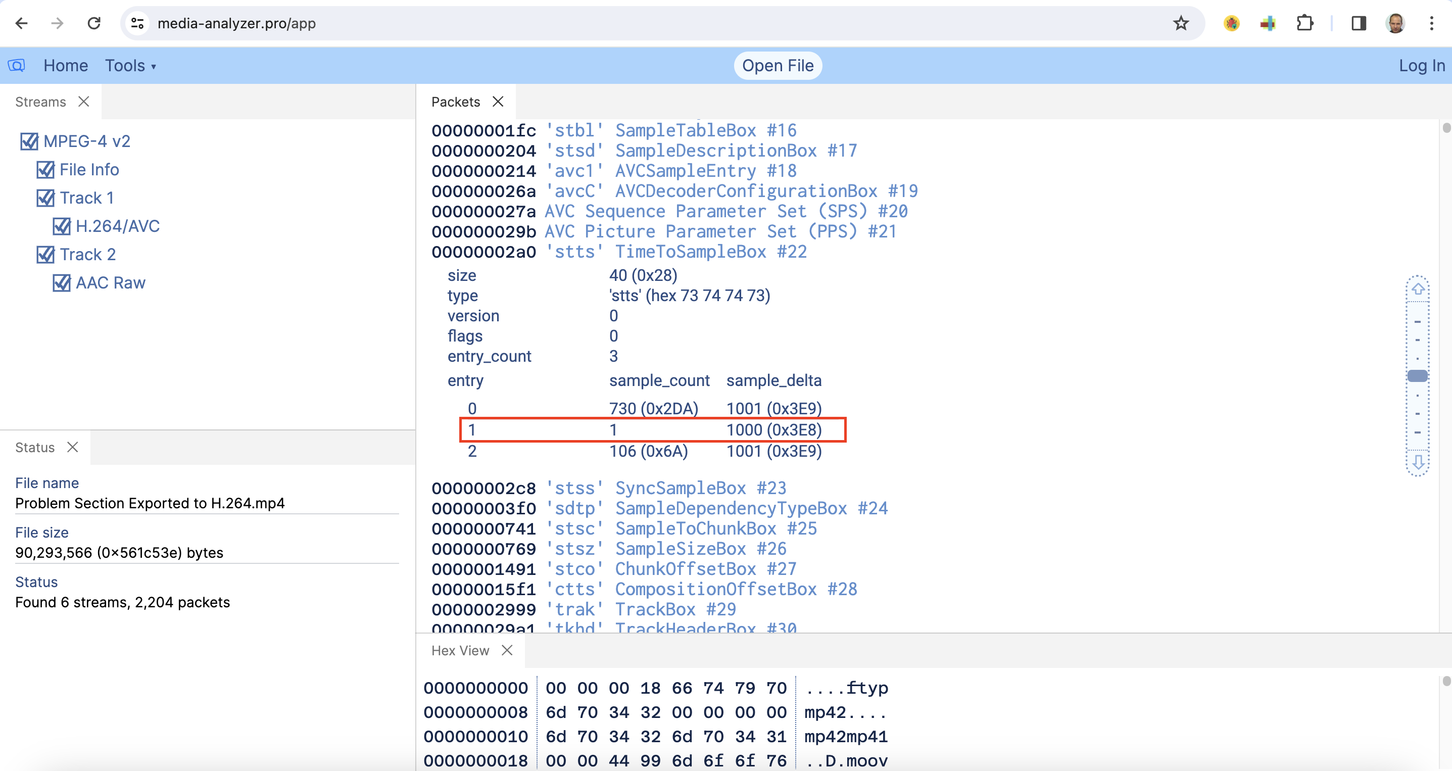

  18. Originally Posted by Alan Romain
    Here's the exported result to H264:
    Well, I can confirm that MediaInfo is correct here:
    [Attachment 77370 - Click to enlarge]
    After 730 "normal" frames there is one, which has a slightly less duration (33.333...ms vs 33.366... expected, which corresponds to 30fps frame duration). Then there are again 106 "normal" frames.
    I guess that might be related to your cut, though I don't understand why PP took incomplete frame from your source here. It looks like a bug to me
