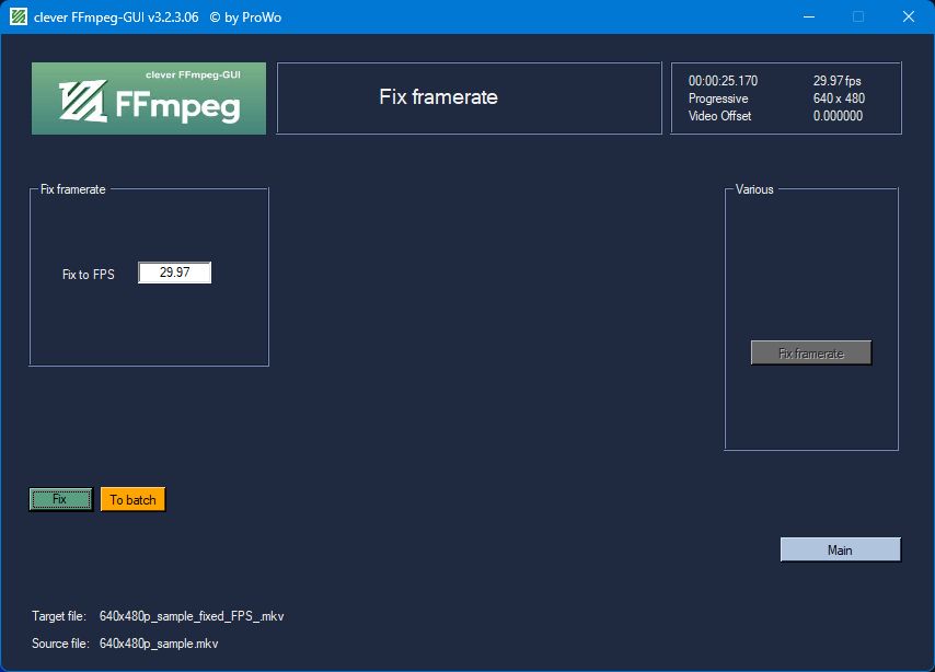

  2. Your file should be 29.97 fps constant.
    You can try two things:
    1. remux to mkv.
    2. use the Fix framerate function of clever FFmpeg-GUI.
    Both are fast and maintain quality (streamcopy).
    [Attachment 77146 - Click to enlarge]
