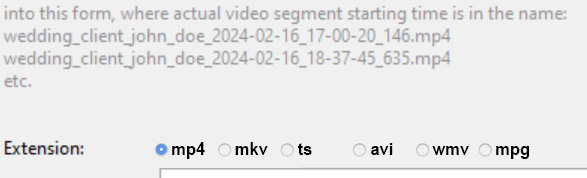

  10. I was thinking to allow multiple video formats to show. There could either be an option like this where all the formats could be written and therefore only those formats would show in the list of files;
    OPTION 1:
    [Attachment 77254 - Click to enlarge]
    Or an option like this with radio buttons and preselected video format choices. The buttons however would need to allow multiple selection. So each choice would be ON/OFF.
    OPTION 2:
    [Attachment 77255 - Click to enlarge]
    The choice is yours with whatever you feel is better, thanks!

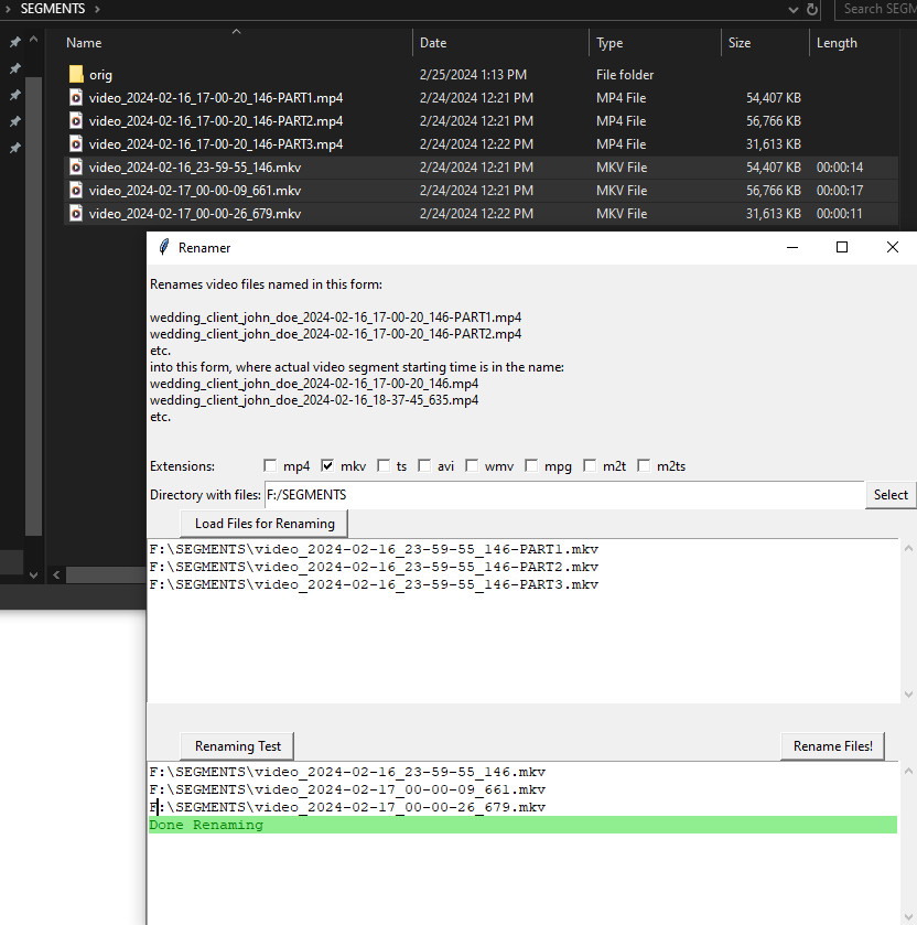

  11. Unzip and run rename_files.py in zip.
    I Added those check buttons for extensions, maybe would be better just to select files, but if those extensions work for you I left it that way.
    Extensions could be added, removed or re-arranged by changing them in line 17 in rename_files.py. Gui is constructed and all from that.
    I discovered actually python module called datetime, which is dealing with datetime and its timedelta method that can add any time and it properly calculates times over midnight where 1 day is added. I guess it always works, perhaps adding all the way to the year if event goes thru new-years-eve .
    In my posted example, tested segments went thru midnight. (just three, about 15 sec short videos for testing).
    Let me know if problems, also if times are not correct, but so far it looks ok, checking those times on paper as well and comparing them.

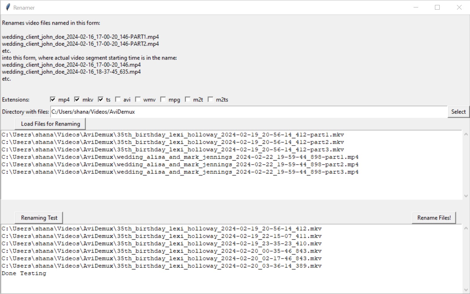

  13. Wow, this is brilliant!! It's coming together so nicely. When I tested it, it was amazing to see it spew out results in a second which manually took me ages to do, a real time saver! Thanks for adding the different extensions - that makes thing much easier.
    So while using a set of files for a singular event gave no problems, I did run into the following issue when multiple event files of multiple video extensions are used and which is highlighted in the screenshot below.
    [Attachment 77272 - Click to enlarge]
    1. 2 different events, one with a .mkv extension and one with a .mp4 extension. It seems to ignore the video file extension of whatever comes subsequent to the first file scanned. In this example the .mkv was first and .mp4 second. When "Renaming Test" is pressed, you can see that only .mkv is shown. I also tested the reverse of this, where .mp4 was first and a second video set with .mkv was second, in that case all files were labelled as .mp4. It seems whatever is highlighted first takes preference and has that video extension applied to all subsequent files.
    2. In the same way that the file extension for the first file is subsequently used for each file thereafter, so is the unique client name. In the example above, "35th birthday" is used for the file name of the "wedding" files.
    As far as the milliseconds are concerned, I too noticed this in MediaInfo. I think the time stamp of "general" as opposed to "stream" should take preference since it matches with the audio length too, in most cases. So general being the default would be better I feel.
    Thanks so much for your effort on this so far, I really appreciate it!
  14. That would not work, to sort all files at once. I will group together files that start with the same name (without date and time) and extension and process them. I will post it late today.
  15. Fingers crossed,
    Loads multiple extensions. It loads files in groups, so if by chance there is a group already renamed in directory or with a bad name format, it just informs about it and skips that group.
  16. a bit more error proof
  17. Thank you so much for updating this and for adding the grouping to make things a little easier. I wanted to try the latest version you provided over the last several days (and to get some newer material to test with) before I replied back. I ran into one anomaly and wanted to get your perspective on it. Is it something that can be sorted? Maybe a grouping within a group?
