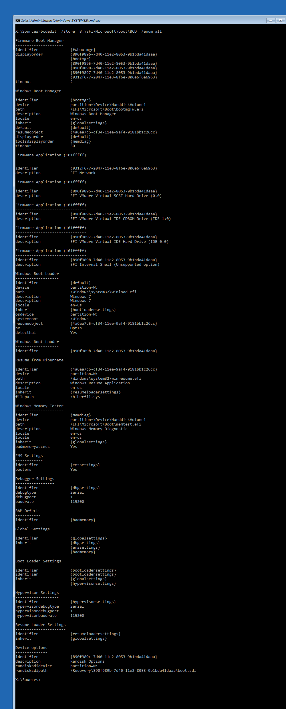

    No such tool as MBR2GPT on my installation ISO, but I tried with AOMEI Partition Assistant that sevenforums recommended. It made it unbootable just like EaseUS. Also, that video shows how to convert a Windows 10 MBR to GPT, not Windows 7. I don't have a boot folder with the BCD in it.
    EDIT: I found my BCD. It is in EFI/Microsoft/Boot on the tiny system partition. But I did what the video instructed and I see nothing weird.

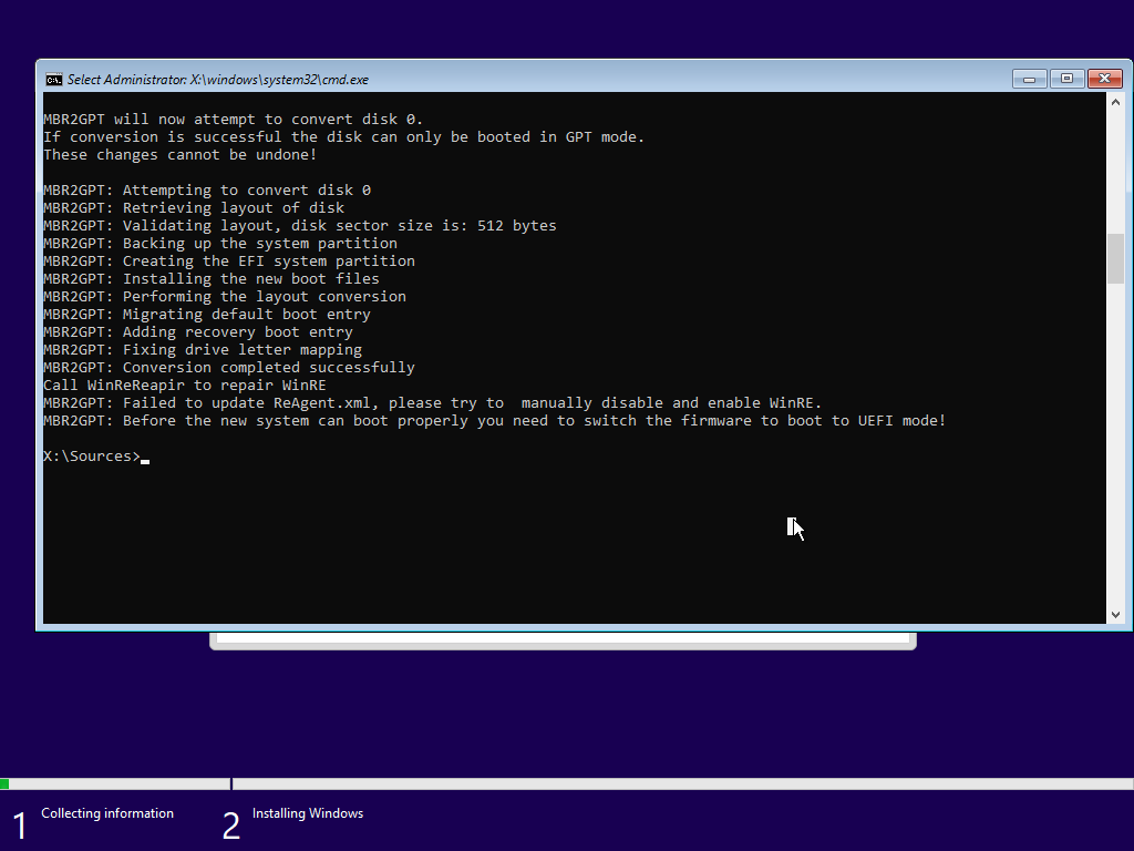

    It seems my ISO was outdated. I grabbed the latest Win10 ISO and finally got MBR2GPT to run. The only error it reported was failing to update an XML file. It rendered my OS unbootable just like all the other tools.
Name:	VirtualBox_W7UEFItest1 error2.png
