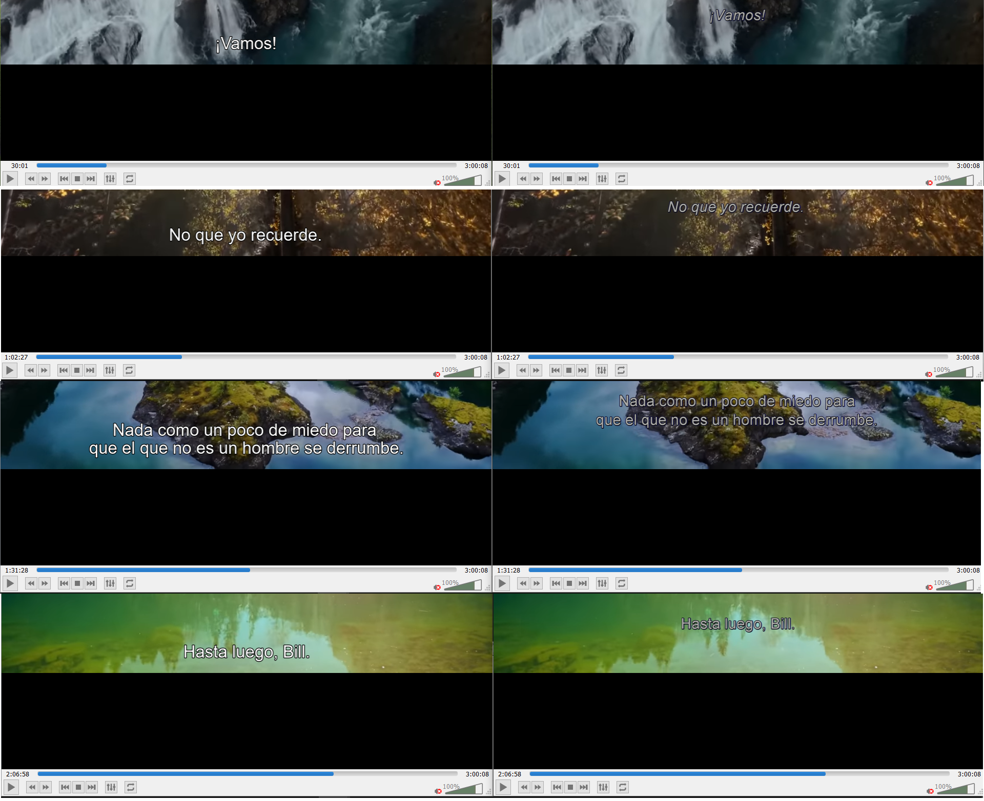

I actually did that. That's why I wanted the video problem.
[Attachment 77102 - Click to enlarge]--[----->+<]>.++++++++++++.---.--------.
