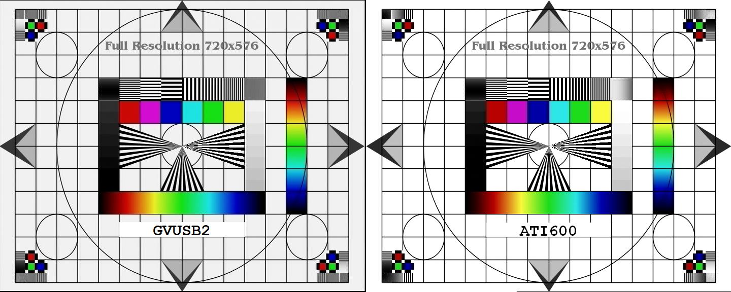

    There is no reason to blame the ATI600 for the black edges of your S-Video capture. Nor is the GVUSB2 responsible for the black edges in Alwyn's example. Both capture devices can record the full width of 720 via the S-Video input.
    [Attachment 77113 - Click to enlarge]
    (The attached screenshot is just to show this and has not been adjusted for direct comparisons between ATI600 & GVUSB).
    The S-Video output of your Sony DCR-TRV460 is responsible for adding the black borders.

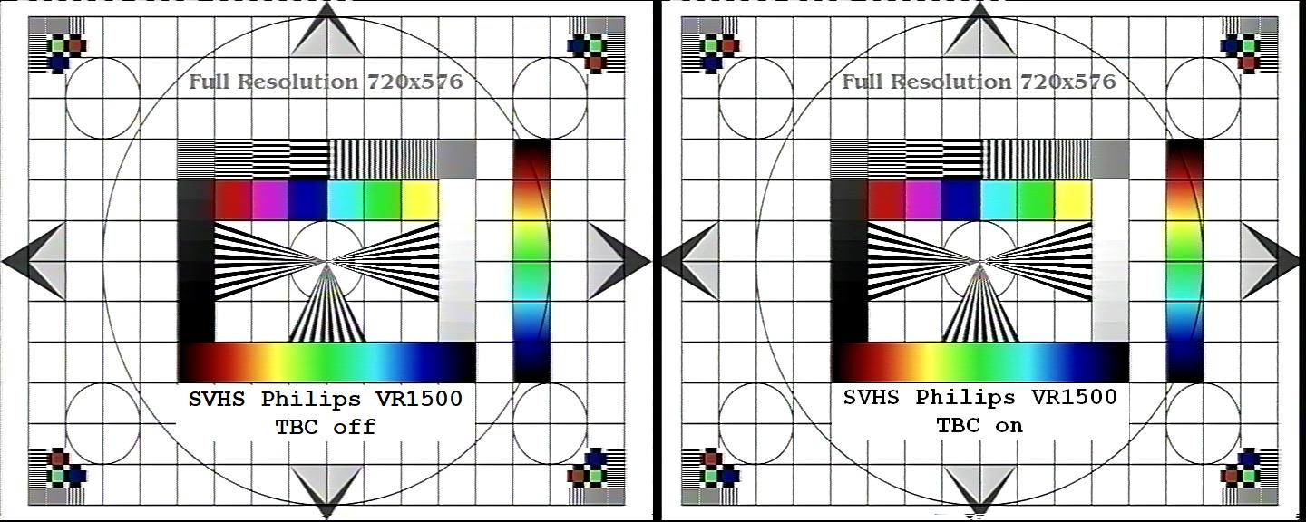

    The TBC of the playback device can also have an influence on the result
    [Attachment 77126 - Click to enlarge]

    Sep 2022
    Bavaria
    Both pictures have the same size 720x576, the right image (TBC On) has the black bars on the right and left side.
    The test patterns were recorded from a videotape. If you look closely you can see the head switching noise at the bottom.

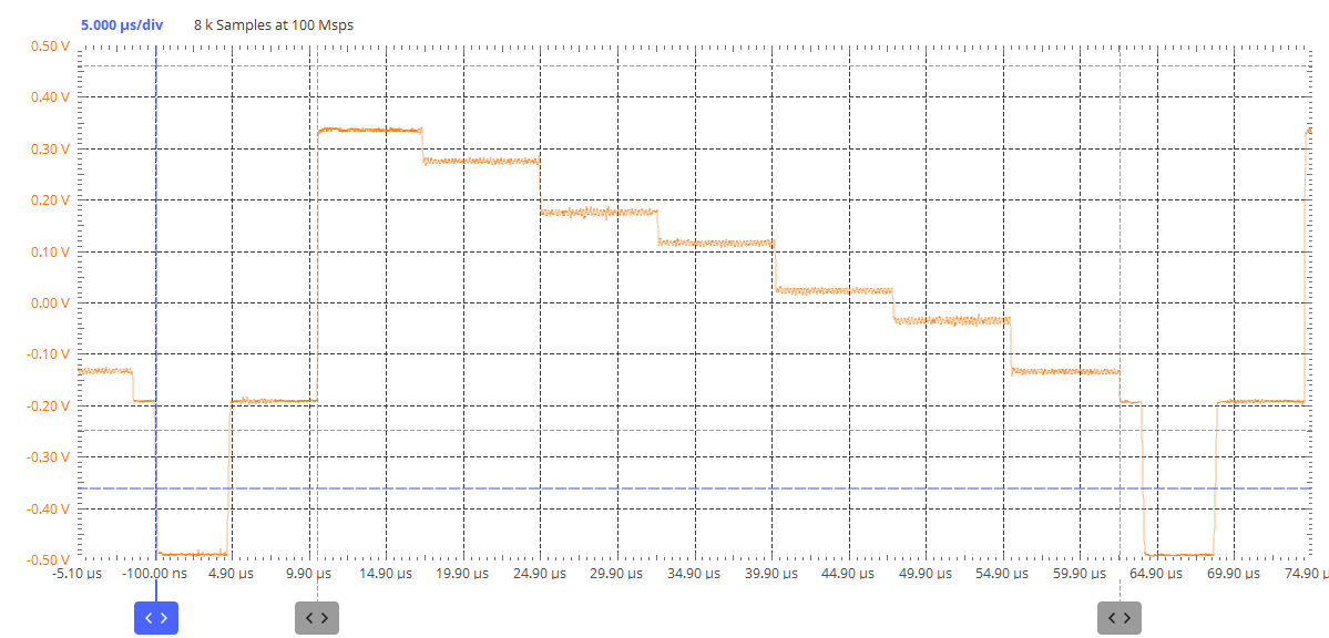

  19. Here is what I am getting for a DVD recorder in passthrough:
    Original Picture = SMPTE colorbar 720x576. 7 bars ~103 pixels wide each, all with same width, burnt on DVD
    The DVD is then inserted into the DVD recorder Panasonic E55 and played back.
    The Oscillogram shows the Y (luma+sync wire) coming out of the S-Video port of the E55. The scanline duration of all the bars is 52us.
    The first bar (grey on the left) and the last bar (blue on the right) are sligtly cropped, means shorter than the center bars which have a duration of ~7.7us each: The grey bar is ~1us cropped, the blue bar is ~0.6us cropped.
    Hence the S-video out of the DVD recorder delivers a slightly cropped picture to the capture device.
    The dongle (GV USB2) captures the reduced width (as it gets it from the E55 S-video port) and pads it to 720 (53.333us)

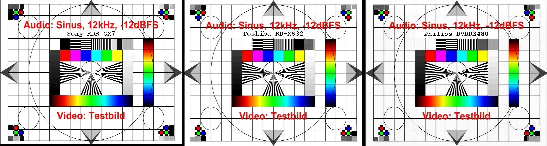

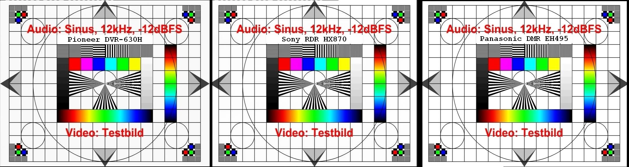

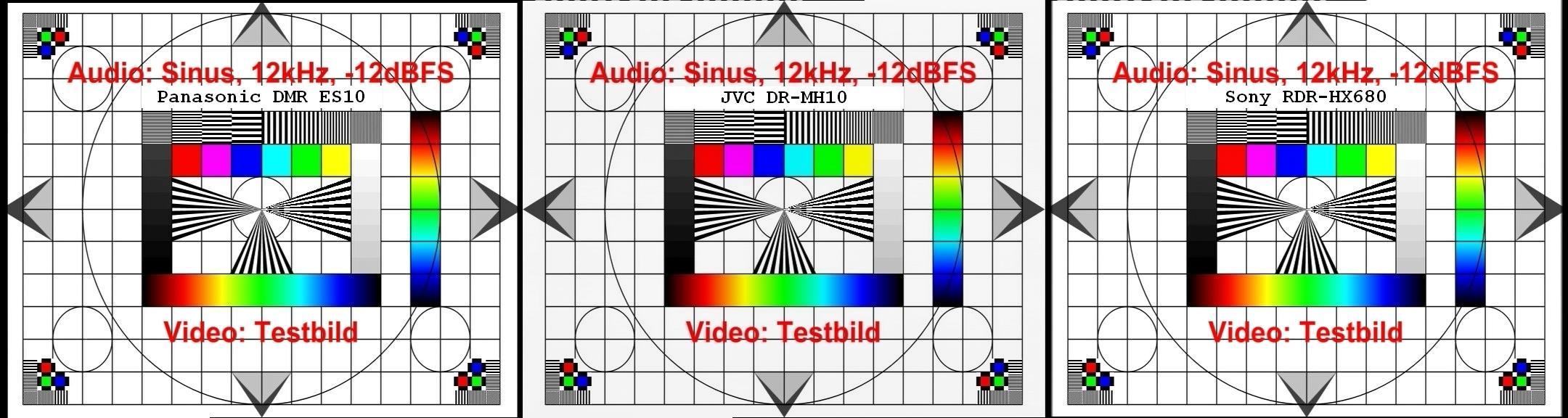

    Here is a small selection of what various devices reproduce via the Y/C output.
    [Attachment 77208 - Click to enlarge]
    [Attachment 77209 - Click to enlarge]
    [Attachment 77210 - Click to enlarge]
    No one should jump to conclusions without knowing what the used devices can and cannot do.
